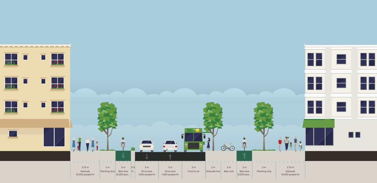

Definitely retain trees. Spitballing because I'm bored, but retain the current Sanders Blvd setbacks, you've got a nice wide ROW to do something interesting with:
The deepest part of this community (furthest from Main) is just over 500M away. At that point your starting to get into car-preferred distances.
I mean students already live further away. 500m is not really an outrageous walking distance and if you control the amount of parking in a hypothetical development, you can somewhat self select who lives there.

The LRT is definitely required to spur on redevelopment here.
No its not outrageous by any means, but statistical analysis does show that's a distance to transit, or grocery or school where things start to shift into car orientation. I'm not arguing against your idea here, I just think its important to fix the stroad and stroad adjacent areas first.
The simple act of shifting the Fortinos to being up against Main, with parking underground would be a game-changer for how people live and get around in the area. That, however, won't happen without a mid or hirise development under which it can locate.
