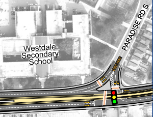

Also just, what the hell is this:
Why is paradise not getting cut down, and at the very least why is it maintaing a massive slip lane westbound. Like, did Aecom dig up some transportation engineers from the 1970s for this RCD?
The introduction of a westbound slip lane at Queen Street is a surprise, too.
