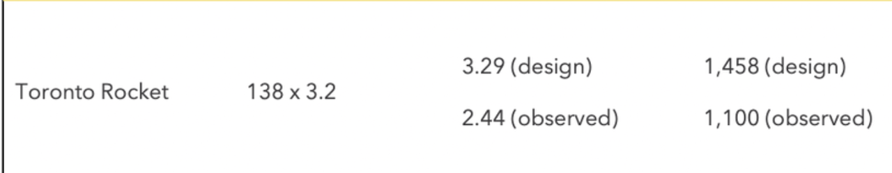

How is an 80 metre (sic) train that is 3-m wide going to be close to 1,100 when when the 138-metre, 3.1-m wide Line 1 train also has a capacity of 1,100!
@nfitz Please read and do the math. I am the only one comparing apples to apples, while you two persist on comparing apples to oranges. Your posts are apples to oranges because “capacity” is being quoted under different passenger density standards, so the numbers aren’t comparable without normalizing to the same pax/m^2.
For a 6-car Toronto Rocket, 1,100 pax is for a density of 2.44 passengers per square metre.
For an 80 metre, 3 metre wide generic metro, 1,100 pax is the crush load capacity at 6 passengers per square metre. 1,000 is more realistic given the Ontario Line will have lots of transverse seating.
Again, you two are deflecting from the main point: 625 to 680 passengers for an 80 metre Ontario Line train at 2.85 pax/m^2 still beats 600 passengers for a 90 metre Eglinton train stuffed to the gills at 6 pax/m^2.
