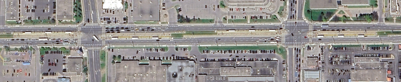

I think that stop (Lebovic) is mainly for when all of that area is redeveloped with all of the condo towers planned for that area. Makes me think of the Northbound Richmond and Queen stops with their spacing being very close. (Downtown I know, but awfully close).
It's just comically close to the two adjacent stations.
I mean, the westbound Warden platform is all of 75 metres from the eastbound Lebovic platform. Total stop spacing between Warden and Lebovic is less than 250 metres. It's a joke. Even if you deleted Lebovic, you would be looking at a 700 metre stop spacing between Warden and Pharmacy which is still very reasonable.
The Ferrand stop is similarly useless, requiring passengers to cross Eglinton at the DVP off-ramp (dangerous and unpleasant) and servicing very little in easy walking distance that wouldn't prefer to walk to Don Mills instead.
Metrolinx deleting those two stops would have substantially improved travel times on the surface alignment with a very, very minimal impact to riders.
And how many trains will service the westbound Warden and then the eastbound Lebovic stops in that sequence?
Hint: It's none.
No matter how close those two stops may appear to be on a map, the reality is that they are still 330 metres away from each other to the trains and passengers onboard.
Substantially? Not likely, with each stop only requiring a minute or less to service.
Hint: It's none.
If we are looking at a ~21 minute travel time on the surface portion of the line, 2 minutes saved means that's a 10% speed improvement. It's relatively substantial.
Saying the stations are 330 metres apart in reality, while true, still isn't really helping your case I don't think. "rapid transit" stops simply don't need to be that close together.
