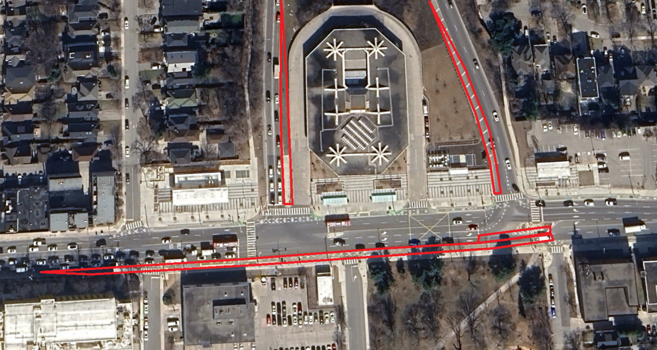

Personally I would like to see a slight widening of Eglinton just immediately around the Allen to improve capacity - something like this:
Add a second through lane EB across the interchange - this enables the construction of a second left turn lane for SB Allen to EB Eglinton.
Also add a third NB receiving lane on the Allen to receive the double-left off Eglinton to enable right turn movements at the same time as the advanced left from Eglinton.
This combined with northern light's suggestions would probably result in some fairly substantial improvements.
Another fix would be to close the subway station access in the middle of the interchange - this would minimize pedestrian crossings.

The extra lane on Eglinton would really be to enable the second left turn lane off the Allen - which would be a 50% capacity increase for SB Allen - really substantial. It's worth a marginally longer crossing distance.
if you want, you could do this instead:
this really isn't changing crossing distances for any pedestrians other than a small change on the east side crossing.
Most vehicles on this part of Eglinton are going to and from the Allen - Eglinton doesn't need a lot of "cross capacity" - it should be highly focused on maximizing throughput to and from the Allen.
