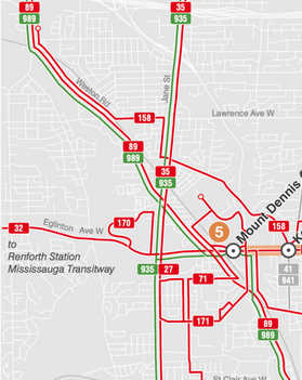

The 32A Eglinton West bus to Renforth Station has a headway of about every 12 minutes (allegedly). Most passengers today would be heading south towards Line 2, because of the traffic congestion (caused by single-occupant autos) and remaining construction.
With the opening of Line 5 this year (allegedly), there will likely be an increase in passenger loads on the 32 (between Renforth Station and Mt. Dennis Station. Will it be every 5 minutes, like they expect Line 5 to be? Will they use articulated buses on the 32 and leave the headway at every 10 minutes?
Subject to change, of course.
