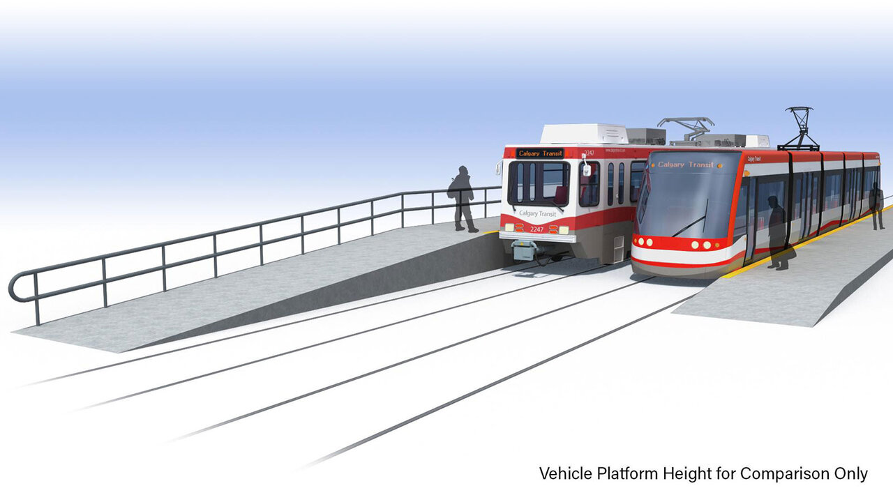

Nothing wrong with LRTs. The fad was low floor LRT's. There was nothing wrong with the normal, high floor LRT's. The C-Train in Calgary is a beauty.
But some politicians and urban planners in Canada insisted that they be closer to the ground so as to look more like a tram and make our cities look more European.
None of this is true. The low floor LRT was chosen because the high floor ones require much larger and more intrusive loading platforms, if you want to provide accessibility. Being situated higher up, you'd need longer platforms with ramps at shallow angles. Going low floor is cheaper and more pragmatic.
There is no conspiracy to make the city look more European.
