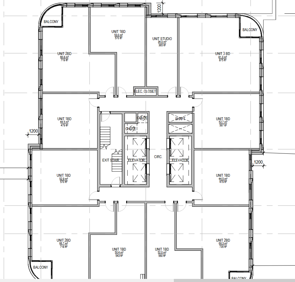

Unit layout building B:
Elevator ratios:

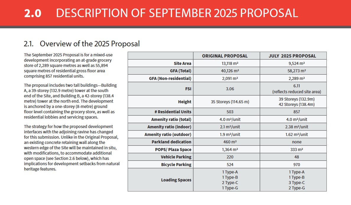

857 units overall
Building A: 385 - 4 elevators - 96 units per elevator
Building B: 472 - 4 elevators - 118 units per elevator

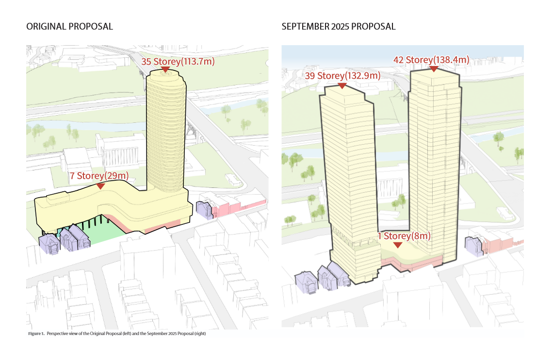

Architecturally acceptable (style) with some warmth/colour , though a downgrade from the original vision here.

Unit layouts are a bit small.
Elevator ratio is good in Building A, and ok'ish in B

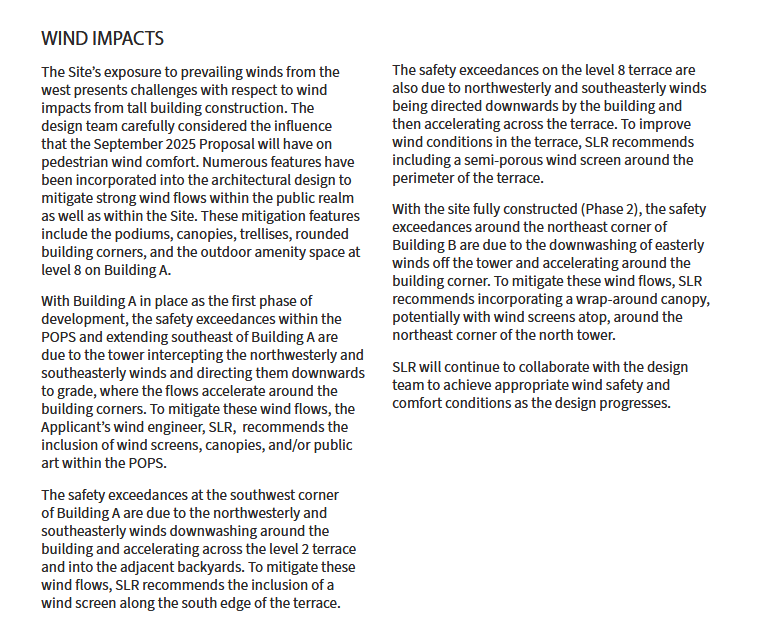

Challenges/Problems - Wind, Wind and more Wind. With full exposure to prevailing western winds, at these heights, the proponents own studies show not merely uncomfortable but unsafe wind conditions.
There are potential strategies to mitigate these, but I'm not sold. I'm not convinced the buildings are massed in such a way as to deliver a reasonable outcome, and I think a height reduction may be preferred here. I will look at the Wind Study for more details later.

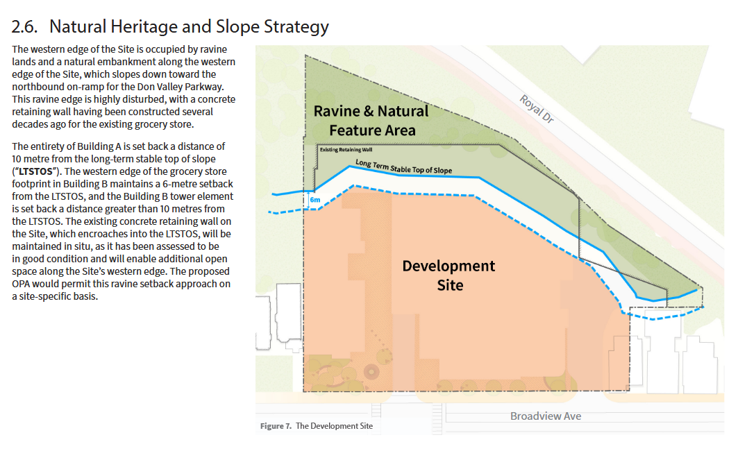

There continues to be a proposed encroachment into the buffer for the slope, though its less consequential to be sure than the previous iteration.
The 155 St. Dennis decision at the OLT may serve to justify accepting that here. TBD.

I live just around the corner from this site, and I spent a fair bit of time defending the original proposal to my neighbours. But all my talking points other than "more rental housing at a transit node is a moral good" are gone with this iteration. The massing is far more imposing and inelegant, the architectural expression is far less interesting, all of the public space is gone, the connection to the ravine is gone, and the likelihood of traffic density being felt by everyone who already parks on the streets around here is way higher. That latter one is not a primary priority for me, but it absolutely will be a sticking point with many. As someone here said earlier, it is not necessary to own a car here, but I guarantee that a couple of hundred people in these buildings will.
People were muted about the last iteration because it was a good proposal - I'd expect more pushback this time around.
It's worse than The Cheapening, it's The Worsening.

Come on ?!?!?
3B squeezed into 875 sqft !?!?
2B squeezed into 716 sqft!?!?
4 elevators in each tower is not enough to service ~40 storeys/~400 units.
Inevitably, 1 elevator is always out of service, 1 is booked out for move-ins/-outs leaving only 2 in service.
This proposal almost doubles the density on a smaller site.
