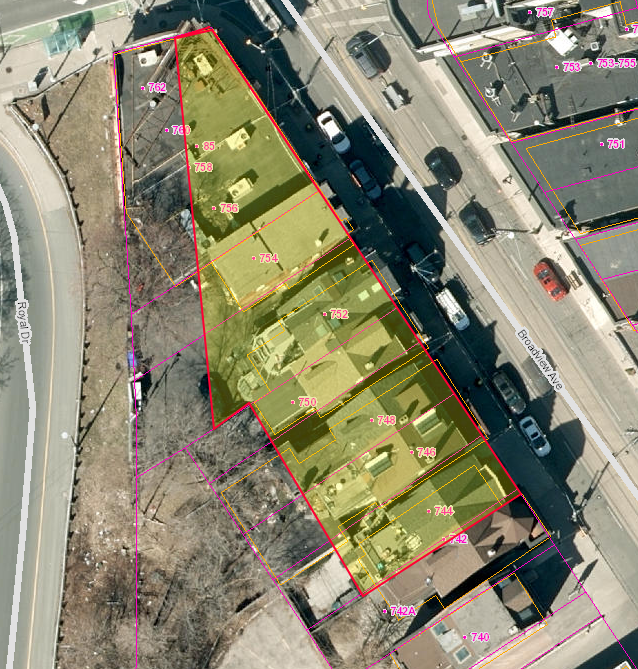

The SW corner of Broadview/Danforth is the first that should be redeveloped, similar to how the Loblaws down the street will be redeveloped. Add ten storeys onto the Pizza Pizza.
Nice thought, but I don't believe there is a viable development there.
The reason is simple, the ramp for the DVP is actually an old creek bed, and is a TRCA-regulated valley/slope.
Loblaws is already in a fight w/the TRCA over its proposed encroachment in the 10M buffer zone and the slope itself, something the TRCA really opposes.
In the case of the residual parcels, if you look at the top of the slope line, assuming it were stable, and then find the line for the setback/buffer (10M), the site at the corner would literally be only a few metres wide.
This is a very crude approximation of the site, adjusted for the 10M buffer, if all of those properties were assembled:
That gives you about 10,000ft2 to play with; which is borderline viable............
But....there's no way you can build-up on that site without widening the sidewalks on Broadview. Conceding even 1M drops the site size to a hair under 9,000ft2

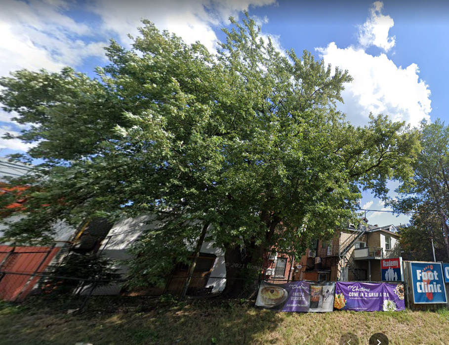

And I think 2M is a likely ask. That also doesn't account for any pressure to retain the nice tree in the rear of this (potential) assembly:

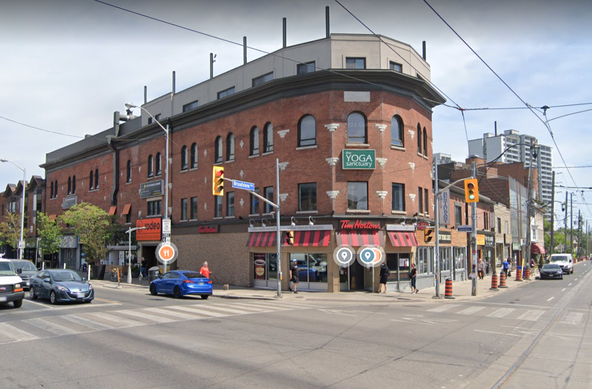

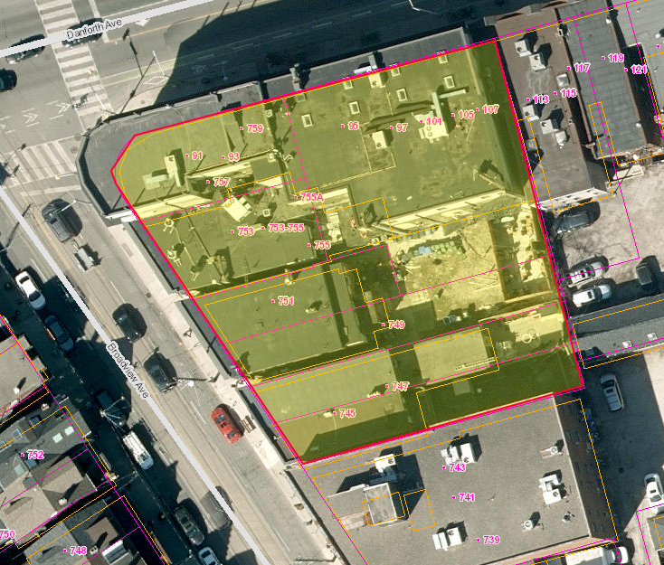

A look at the other intersection corners:
S/E:
Corner building is heritage listed, but not designated; I would anticipate facade retention being required. But the assembly shown above would be an attractive size/shape.
Size is ~19000ft2

At look at the other intersection corners:
S/E:
Size is ~19000ft2
I always disliked the shoddy fourth story addition.
