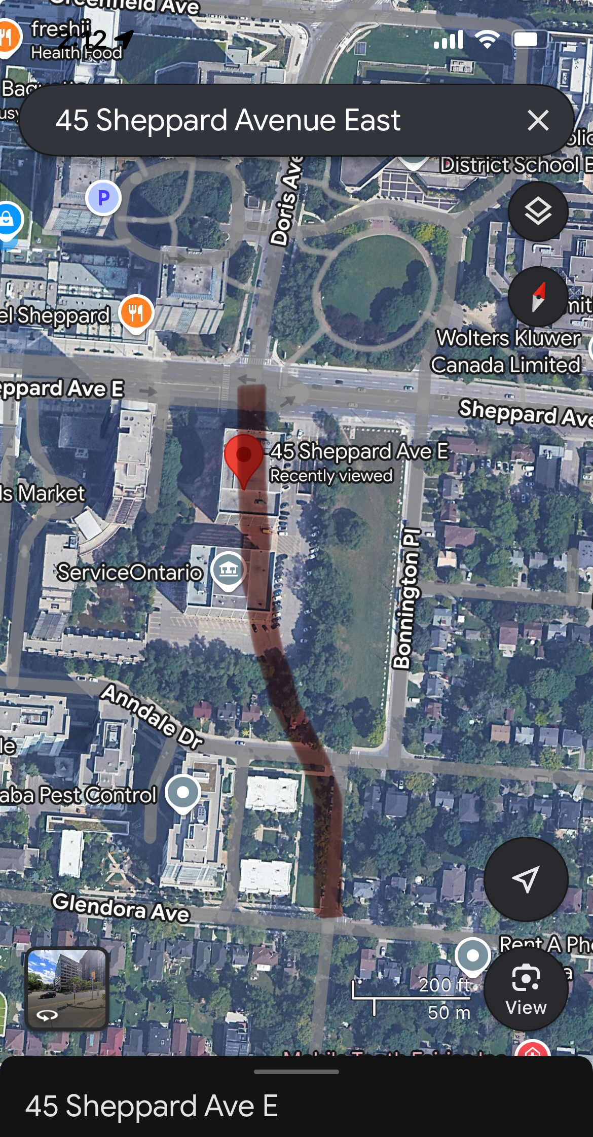

Surely something more like this could be devised with this new development being planned around the road.

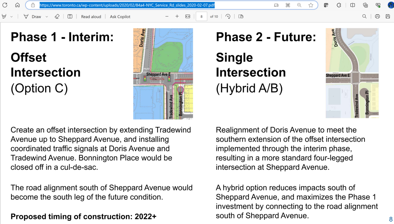

An issue with the above proposal is Doris Ave tends to serve as the boundary for the North York Centre Secondary Plan area - so if you extend Doris through the middle of this Subject Site,... the western portion closer to Yonge would allow high density,...
it's adjacent to Single Residential House Neighbourhood zoned area along Bonnington Place would be protected by a 45 degree angular plane that limit the height of the higher-density area - likely to about 11-15-storey with terrace top, depending on lot depth!
That's why it's much better to have a road as boundary to Secondary Plan - one side can be high-density with no tapering,... while other side is Single Residential House Neighbourhood
