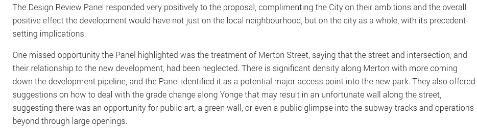

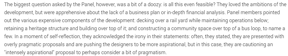

A good Front Page story on this one, from Julian Mirabelli:
The first part is good re-cap of what's already known and posted in a thread, but is a solid refresher in advance of the second half of the post, looking at the Design Review Panel's comments on the proposal.
From that portion of the article:
