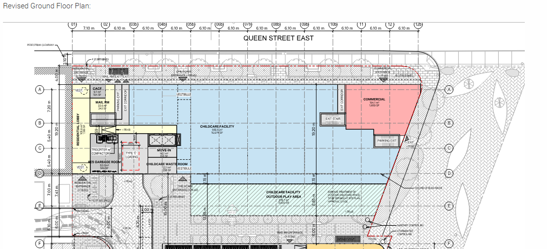

Revised Site Plan:
Revised Ground Floor Plan:
Stats: Max height 18s - total units 328 - all rental. Affordable unit commitment is now fuzzy. ' a portion' of the total.

Better, much better.
Still wrong.
Even if the current proposal will not encompass the aging, short, TCHC building and the Health Centre, it's important to design this side of the site to allow that to happen.
The bottom 3 levels of the Queen St. midrise should be the new health centre. What a bizarre spot for the childcare facility.
If you did that, you would allow for a phase 2 to be planned in parallel with 18s at the south end of the Coxwell frontage and 6s along Queen.
For the same reasons as above, this proposal should contemplate moving as many residents of the adjacent TCHC site over, as feasible when the time comes, so that building site can be freed up quickly.
Other than that, its fine, if uninspired.
Would be interesting to compare the GFA from the existing Daycare space to the HUGE footprint that the City now demands from a New-Build Daycare in 2025...
It almost looks like the huge 3,000 sq ft of outdoor space for the Daycare is the main reason why they split it into 2 x different North and South buildings.
City daycare standards (post-covid) are really hard to deliver on an urban site.
Would be interesting to compare the GFA from the existing Daycare space to the HUGE footprint that the City demands from a New-Build Daycare...
Capacity is being increased from 26 children to 62 children; an increase of 138%
Ahhh, I had missed that detail -- which document contains that updated Daycare capacity information..? Thx!
