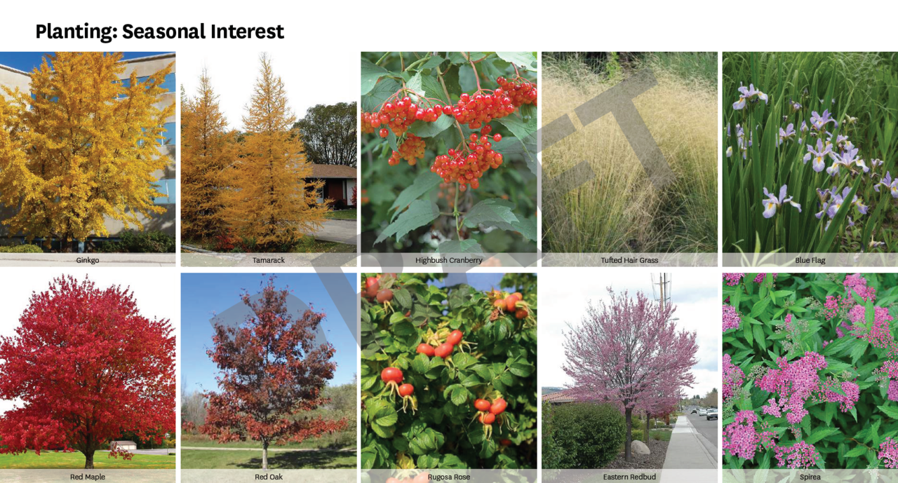

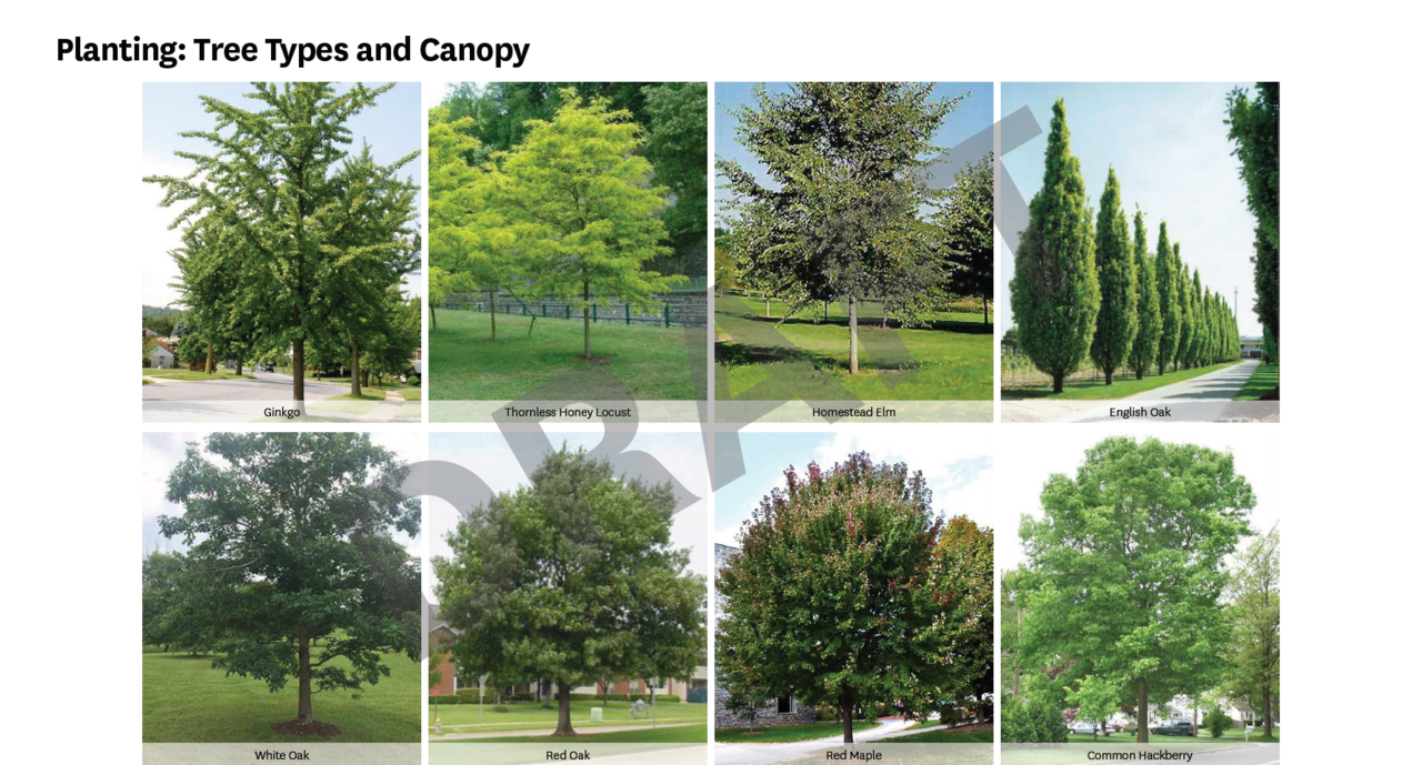

I was going through the new documents that Waterfront Toronto posted for the Portlands and came across these two slides about planting and thought this was an educational opportunity.
Any particularly good selections? Any that are particularly bad, questionable or raise the eyebrow in some ways?

Ginko is a not useful from an ecological perspective.
That's why landscape architect's love it. LOL
Nothing eats it, nothing calls its home. Birds, insects, pretty much everything eschews it.
Does make it moderately durable in theory (not subject to as much risk from pests), haven't noticed it being overly invasive, but not a great performer either.
Not a fan of English Oak, which is non-native here, (European), never seen it be invasive, but will double check w/others. Rarely seen it used and successful.
Red Maple very rarely succeeds in urban environments. Compaction and pollution intolerant.
Of those top 8, Red Oak gets a gold star for being native, and being reasonably successful.
White Oak is native/near-native (very northern limit of range).
Swamp variety is a consistently good performer. (Swamp White Oak).
Honey Locust is near-native, but very durable. Haven't noted that particular varietal of it. But variations on it are a favourite for parking lots. It puts up with a lot.
Tamarack, great species, used in some places it shouldn't be, just because it won't survive. Its a swamp-edge species that likes its feet wet. Ontario's only conifer that turns yellow in the fall and loses its needles.
Gorgeous in October.
Just don't plant it in dry areas or slope tops.
Highbush cranberry I desperately want to tell you I like. Why? Its native, and great for wildlife.
Only problem, in my experience, 90% of nurseries have the European variety and don't even know it. Planting the wrong one has far less habitat benefit and its highly invasive.
To be fair, you really have to know your stuff to tell them apart. (I find it quite challenging and I know what to look for)
https://extension.umaine.edu/cranberries/highbush-cranberry/
How does one tell the difference between the true, Americanum highbush cranberry form (Viburnum opulus var. americanum) and the poor-tasting and invasive European form, when there is no fruit to taste-test or compare? Answer (provided by Charles Armstrong and Donald Mairs): It isn’t easy! One must examine the petiolar glands, which are the little flat structures where the petiole joins the leaf blade. Do not confuse these with the mini-tendrils that are further back where the petiole joins the stem. With the truly native americanum form, the petiolar glands are variously described as convex (bulging outward), club-shaped, or columnar. This is contrasted with the European (opulus) form, whose petiolar glands are concave (either flat on top or slightly dented in appearance).
Rugosa Rose is native to Asia and considered invasive. Though off-hand, I can't recall seeing it on a list of problem species for Toronto, I will investigate further.
Spirea very much depends on what species we're talking about, some are native, some are non-native invasive; huge family.
