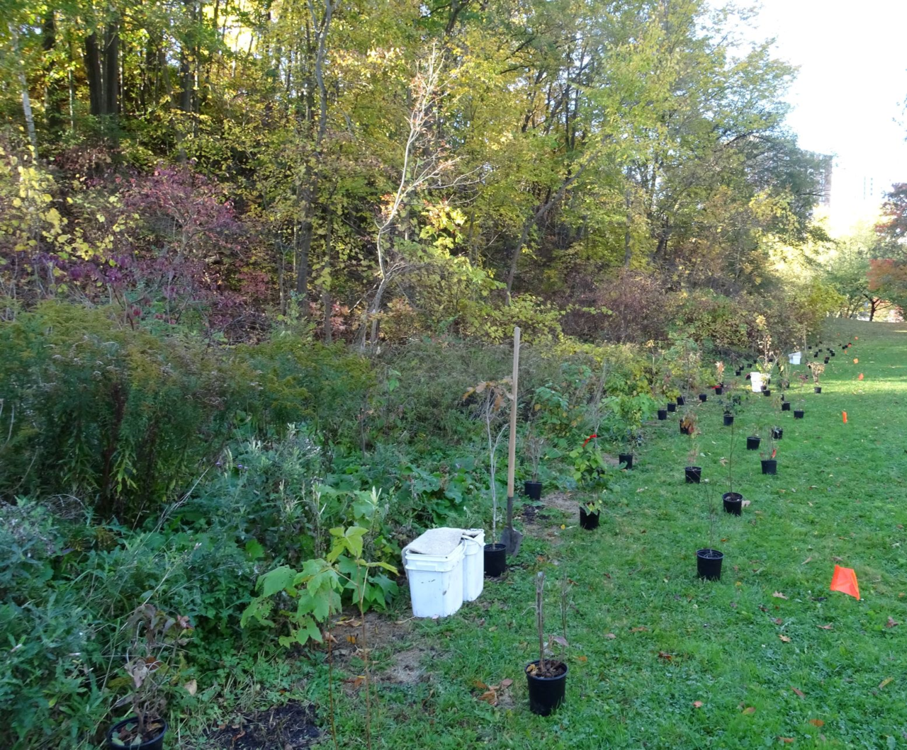

Excuse our Appearance............New Forest Under Construction:

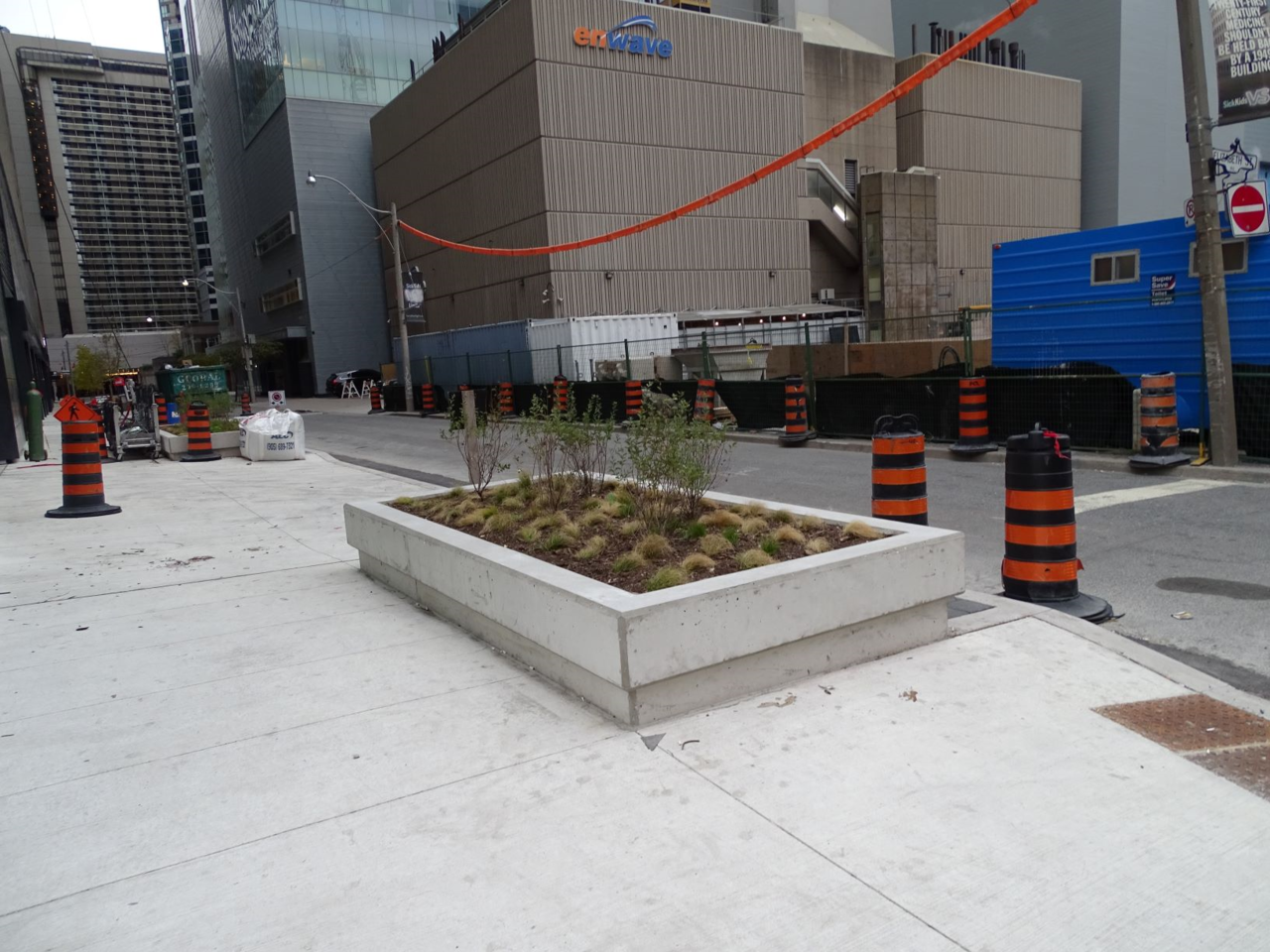

Now, that said, as I noted above, there may well be utilities impairing better placement.
If a quality tree pit/trench isn't viable; they should consider alternatives.
The City did this behind 700 Bay (no tree, just shrubs/grasses)
I assume, I don't know, this was done due to insufficient root space for trees (though it may have been for sightlines also, in light of how close it is to the curb)
As a side note, it occurs to me, that if the City doesn't want to spec stone or other attractive cladding for concrete planters, it could consider specking the dyeing of concrete.
You could easily dye the concrete tan, or terra cotta.
Also, if they standardize the form, they could easily do standardized bolt-on seats on the ends, and a slim wood or metal rim plate over the top on the sides. Just a thought.
I assume in such situations you could also do some smaller decorative trees like standards. Although sightlines would be a consideration.

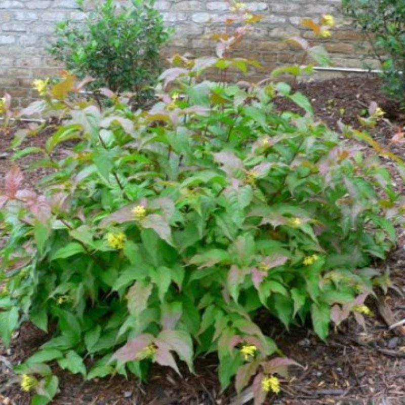

One of the safer, native choices would likely be Bush Honeysuckle (Diervilla lonicera)
Below is actually a 'dwarf cultivar'. But the wild ones tend to only grow to 3-4ft.
