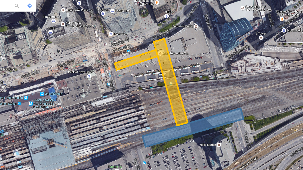

View attachment 64802 For a downtown station, could you use the outer two bypass tracks at the southern end of the Union Corridor for a station snugged up against the new towers/GO bus terminal. You could have some station access above through the new tower, but main pedestrian could be by digging a new main entrance path north into, up and out of the Dominion building on Front. You could tie into the LRT platform as well from the Dominion basement.
I actually like this idea, though you wouldn't need to do any tunneling. The new GO Bus terminal is being built on the parking lot just south of where you put the platforms. It will be connected to Union and Front Street via the park they are building over the tracks right on that location. I see no reason why this can't just piggy back on that infrastructure.
View attachment 64803 View attachment 64802 For a downtown station, could you use the outer two bypass tracks at the southern end of the Union Corridor for a station snugged up against the new towers/GO bus terminal. You could have some station access above through the new tower, but main pedestrian could be by digging a new main entrance path north into, up and out of the Dominion building on Front. You could tie into the LRT platform as well from the Dominion basement.
This is actually a great idea, I guess similar to how the UPX has a station on the west side of the main Union platforms, no reason you can't have another on the east side for SmartTrack. I had envisioned in my mind a tunneled section below the current tracks for SmartTrack, but this would be good too, maybe design it in a way that is more suitable for high capacity unlike the GO platforms.
There are already plans for two massive towers on each side of the rail corridor where you had proposed the bridge. Those proposals already include a "Greenway" park over the tracks. Given the various unknowns on final design, timelines, space required etc, a smarttrack platform here might not work. I think a better approach would be to have an underground station connecting close to the TTC, or at least using the existing platforms in the interm.
I'm not proposing a bridge. I'm saying excavate a new teamway under it all, so that you're funneling foot traffic north underground. You'd probably still have an access to that building, but the intention would be for the main flow to go under the whole development and up through the Dominion building to PATH and street level.
When you look at burying you have to consider the Queens Quay LRT and the subway. There is a paid fare area between the two...so you can't tunnel from east of Bay to Union station.
In fact, the first track (Track 3?) is almost at street level with Front St. So theoretically (and hopefully) by creating a hallway you can connect this with ease. Track 4 will have to either go up 1 floor and back down or vice versa. for the same Front St location.
Getting to the subway is a bit more difficult. It's a long way down under the LRT and I'm not sure the clearance above it (under the south sidewalk of Front St)
