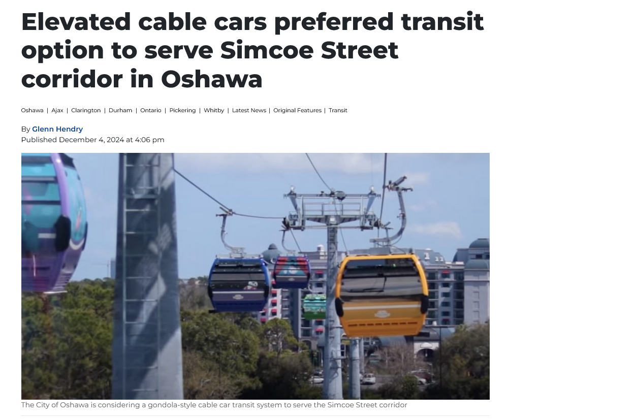

For the preview deprived and the click-averse we need to bring forward the headline and associated picture:
There is a case for technology of this type in certain applications.............but I don't think Simcoe St. in Oshawa is that case.
I don’t really think gondolas fit for singular urban corridors at all, honestly.
They do best where there is a grade that cannot be climbed reasonably by any other mode. Flying over hilly neighbourhoods in South American cities, or wherever else. They are essentially in lieu of a funicular- “connectors” really.
The Hamilton escarpment could make better use of this tech, or to connect a hypothetical GO station in the Don valley to Broadview or Castle Frank station. But as either case would demonstrate, the tech couldn’t really be true rapid transit for the actual, identified corridors.
Repeated sales attempts aside are there ANY examples of line of haul gondolas with multiple stations that aren't dealing with terrain issues? ANYWHERE?

Adding stops to a Gondola system is not easy or cheap, once established the height of the wire is what it is to a large degree. (though poles could have multiple connection levels for wire, changing those will change wire length and various other things.)
Station construction will require a base of land at grade....as you have to get from the sky to the ground, and you will have to do that w/accessibility in mind, at minimum one high capacity elevator and a large stair case.
Capacity on a gondola can be changed by introducing additional vehicles............to a point......but this costs money, and has a time-factor (as it would under any mode), but likewise, may impact system performance.
That’s all notwithstanding how people will feel actually riding in these. ie, train perception drives some riding behaviour- what about a gondola?
While I expect many might appreciate the views.........I imagine for some, fear of heights may have an adverse impact.

The Wikipedia article for that short Paris line says that the projected travel time is 18 minutes, that's only 15 km/hr! :)
Looking at the article, it says this line runs along Simcoe Street from Lakeview Park to Highway 7. Which is surely incorrect as Highway 7 intersects Simcoe Street over 50 km north of the lake, in Manilla (north of Lake Scugog).
Perhaps they mean Winchester Road East - but that was never Highway 7 in it's many past lives, as far as I know.
Still, that's 13 km, and I'd guess at least 10 stations. That's not really comparable to this line in Paris. I know there's 6 lines in Medellín, but three of their lines are only 2 to 3 km long with 4 stations; while 2 are less than a mile long with 3 stations , and the longest is about 5 km long but with only 2 stations!
So what's a comparable line? It seems to be used elsewhere as a last mile solution (and the only Toronto proposal I've seen that sounds half-reasonable is a 1-km and 2-station connection from Broadview station to Brickworks). In Medellín it's very much driven by terrain.
And then there's the speed issue. Even the non-stop line (Line L) in Medellín only averages 19 km/hr. I've also seen that the maximum speed for that equipment is only 18 km/hr! Looking at the second-longest line (Line L - 2.7 km with 4 stations), it takes 12 minutes - a speed of only 13.5 km/hr. So about an hour from the lake to Winchester.
Surely a bus is faster. The route is slightly different, but the 13 km bus from Oshawa GO to Winchester takes 33 minutes - 23.6 km/hr.
Looking elsewhere, the 1.1 km line in London take 5 minutes - 13.2 km/hr. Le Pas in Bolivia (also very mountainous) has an extensive system, but even there the longest is 4.7 km and takes 17 minute for the 5 stations. That's still only 16.6 km/hr.
So why everywhere else are the lines so short? Most troubling, is that if you look at the Le Pas map - surely the biggest system there is, the lines seem to run not as one line, but the main east-west axis is actually 5 lines totalling 17.1 km and a travel time of 66.3 minutes (15.5 km/hr not including transfers!)
This is comical, surely someone is trolling.
Places that this might work are one-stop from Exhibition GO to the Doug Ford Memorial Ontario Place, and from Cherry Beach over the East Gap. And other last mile situations. Not last 5 miles!
