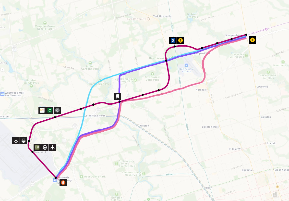

Whenever I think Sheppard West extension I think where is the ideal Line 1 transfer point, Barrie Line transfer point, future Bolton line transfer point, Kitchener line transfer point, airport connection point, and connection to Mississauga. When I think of those things I get something like the line above or something that completely replaces the Finch LRT.
^ The optimal route partly depends on the technology. If Sheppard remains a TTC subway, then the pink route between Yonge and Hwy 400 should be the best. Easier to connect to the Line 1 tracks between Sheppard and Wilson, where the Line 1 tracks run at grade. And, there is enough room for the curves. West of Hwy 400, the red line looks appealing.
If Sheppard is converted to light metro / OL style rolling stock, then using the red line route for the whole length west of Yonbge should be a good idea.
For the red alignment, it is difficult(does not improve travel time) for people living at North Etobicoke to go to Wilson. They either take a bus -> red line -> bus again, or bus -> red line -> transfer at Downsview park -> Wilson
Is Wilson station the place where people from North Etobicoke are hanging out these days?
Yes, you would take bus to Line 6 or Line 4 then transfer to Line 1. However, by putting multiple connections in the same place there are better options across all the possible paths. What would be the path North Etobicoke to Aurora, York University to Scarborough, etc. Does going to Downsview mean a small backtrack for some... yes but a backtrack on a subway which will cover that distance quicker, but a different location would create more transfers and backtracks.

I'm honestly rather fond of Reece Martin's version that extends FWLRT to Downsview Park for GO connectivity and through routes (some?) Sheppard trains onto the York extension for single seat connections to GO, York, 407 and Viva...
Definitely a departure from TTC practice, but not a place that interlining would be majorly disruptive even when it does go wrong, and similarly, it definitely helps the cost of a proper grade separated junction at Sheppard West if the interlining negates the need for however many additional km of subway west to the airport...

It would be great to route the Sheppard trains onto the York extension, if the track configuration allowed that. Half of the trains coming from downtown could short-turn at Sheppard West, making room further north for the Sheppard trains.
But it will be difficult to connect the Sheppard tracks to the York extension now, as the line runs underground north of Sheppard and wasn't built with such a connection in mind. In contrast, the St George / Bay / Museum Y-interchange was built to allow interlining from the onset.
