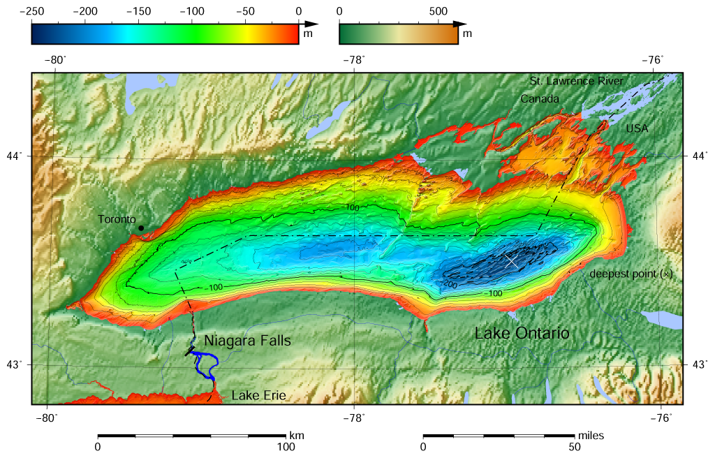

The tunnel plan hugged the shore because of Lake Ontario’s bathymetry. Keeping the proposed tunnel as shallow as possible is what would make it technically feasible. Along the direct shoreline, the lake is around 20m deep maximum with a rough plateau, as indicated in the drawings, which is perfect for construction. Going directly diagonal would send it closer to 50-100m deep, which would drastically increase the cost of any tunnelling and make it totally impractical.
I am curious to know how depth of tunnel makes it more expensive. In case of a bridge, deeper the waters, taller the columns. But a tunnel;s cross section is the same irrespective of depth. Also the tunnel will be 10-20 meters below the lake bed, so the soil/earth above it will take the pressure of the water above and the tunnel won't have to worry about that pressure.
The deeper the tunnel required, the longer it has to be - something like a 3% gradient may require a very long tunnel to get deep enough. This is one reason why immersed tube tunnels became a popular choice, because you don't need to dig in bedrock, the tunnel sits on the bottom on the river/lake/sea.
