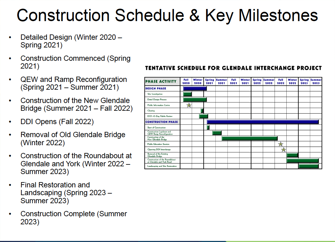

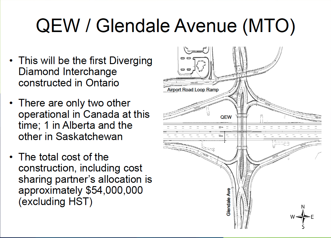

Not sure where to drop but saw this for Niagara, Ontario's first Diverging Diamond! Near Niagara Outlets Mall. The photo used is from the US and couldn't find the plans anywhere.
Exciting. Is this the first diverging diamond interchange in Canada? Ontario?
The days of the folded diamonds (aka parclo b4) in Ontario are probably numbered. There are a number that could be converted to newer options that use less land, thus freeing up land for other uses.
First in Ontario. There are two others in Canada, one in Alberta (Macleod Trail and 162nd Avenue in Calgary) and the other in Saskatchewan (Pilot Butte & the Trans-Canada outside of Regina).

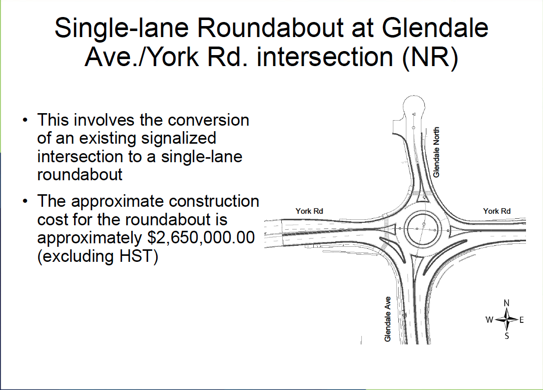

Cut and pasted from the PDF...

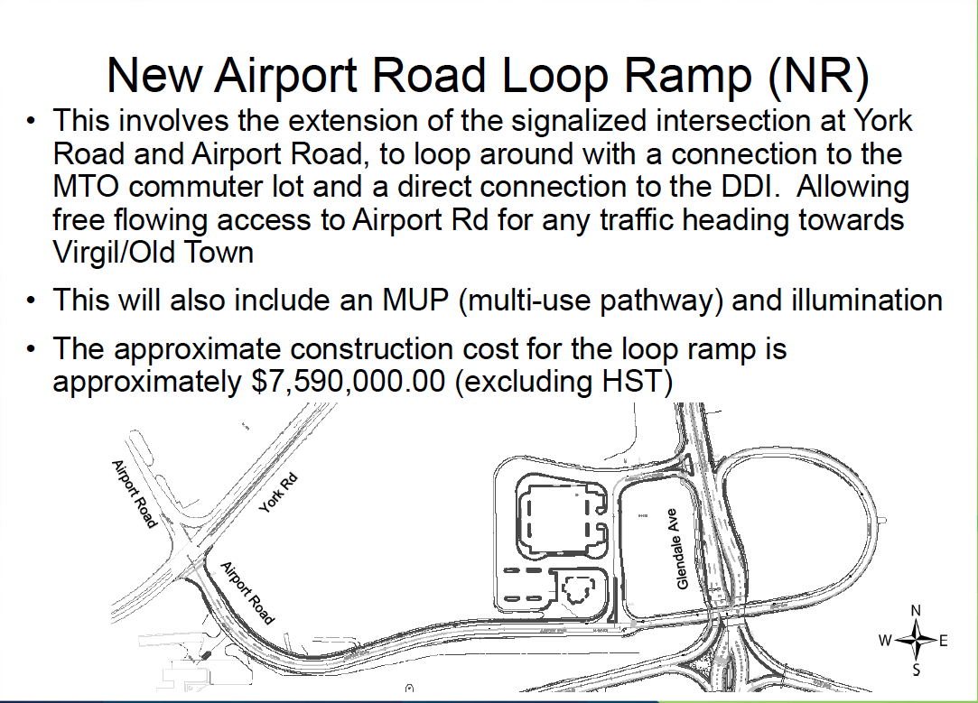

That's under construction now. The Airport Road Loop Ramp will improve access to Virgil / Niagara on the Lake which right now has quite awkward freeway access.

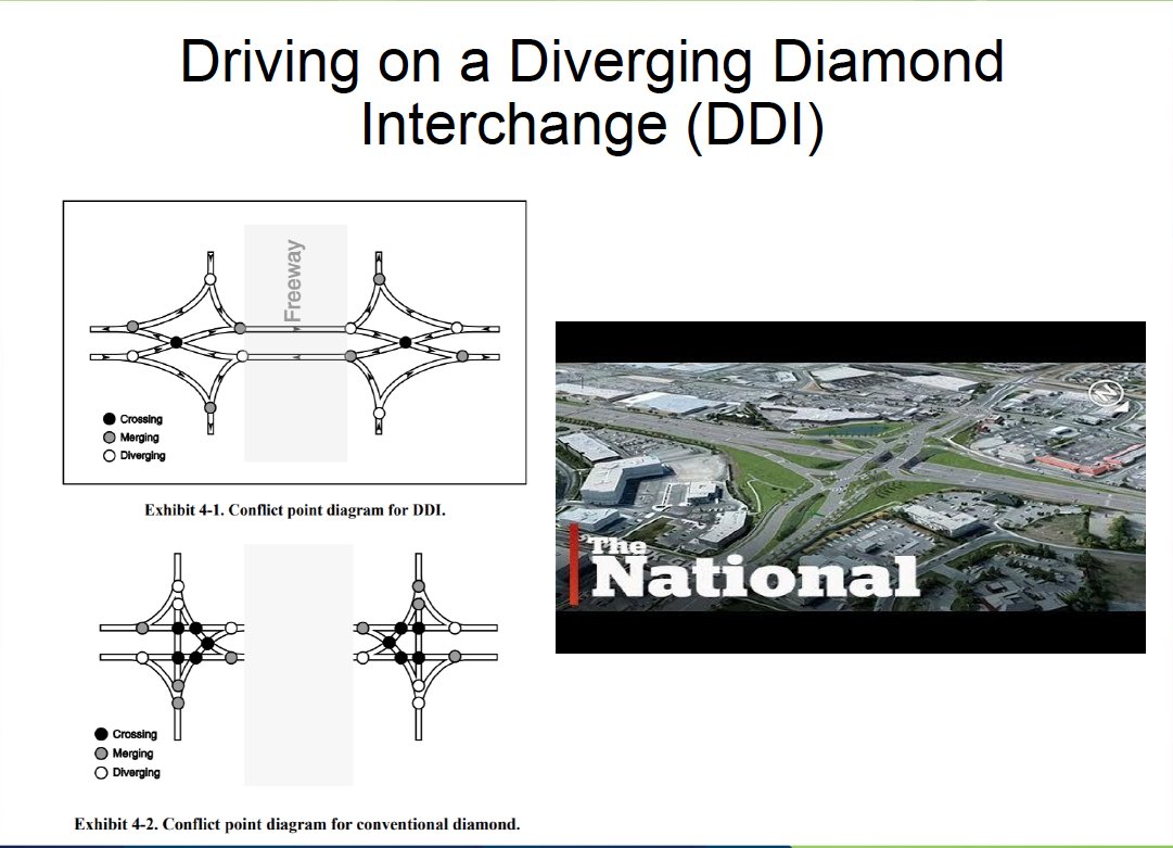

^ that thing looks super confusing. Does anyone know of a good video of one of these in practice?
I'd think that, unlike a roundabout, that the diverging diamond would be pretty invisible to most drivers, who'd simply follow the signage. (though if the roundabout was big enough, that would be also be true - but that's a big waste of land, and seldom seen)
I haven't driven through a Diverging Diamond but from the videos of them I have seen they seem pretty straightforward when using them.
They are annoying for pedestrians as you have to cross to the middle to cross one (sort of like Highway 7 on the 400), but for drivers the roads are streamed well enough there isn't really any confusion as to where you have to go.
