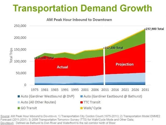

I'll be happy with that, and it will prove better for Toronto in the long run, just like it has for a bunch of other cities across the world!
If all auto traffic going downtown was going through the Gardiner, then you have a point. The graph that was linked clearly showed that the Gardiner only accounts for around 15% of all auto traffic going downtown!
Those delivery trucks, construction vehicles, irregular visitors, etc, that currently use the Gardiner will use the same routes as the rest 85% of the auto traffic or they will use the newly expanded Lakeshore Boulevard.
I'm not sure where you get the 15% of all Downtown auto traffic from.
Also, this study was completed 12 years ago. Not saying it is changing dramatically, but we should argue/discuss some more recent data. A lot changes in a decade, especially the GTA population. Were any studies posted when council voted again to keep moving forward with the hybrid in March of this year?
They got the 15% from the graph they reposted in their post. Just because you do not like the results of a study does not mean you can disregard it.
