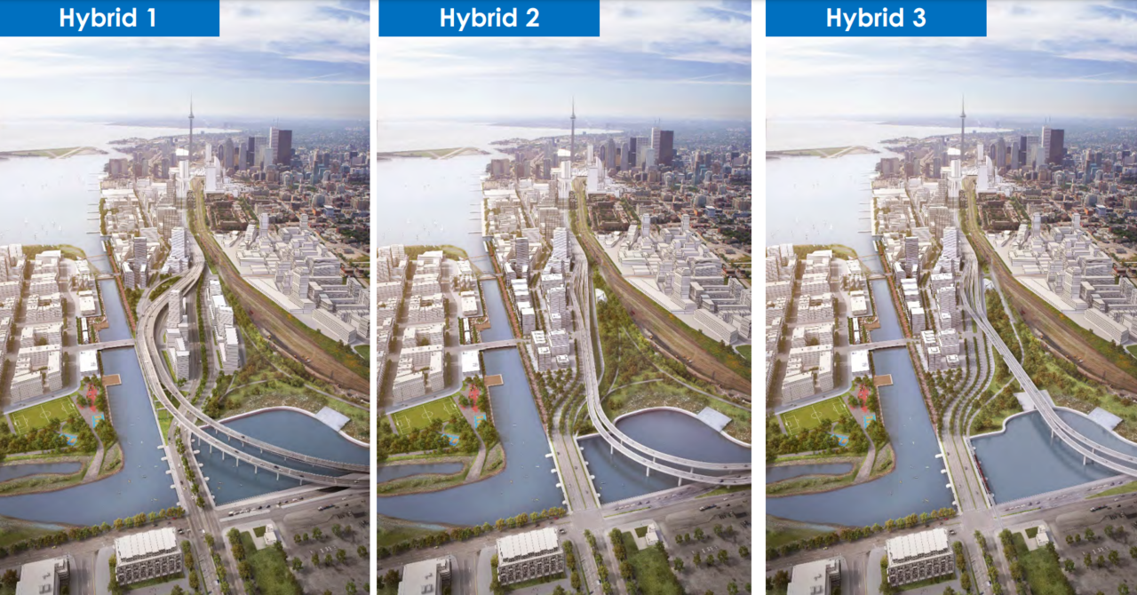

Echoing @Northern Light above. Yes, most of the traffic exits off at Bayview/Bloor and at Richmond. This is the reason the Gardner between DVP and Jarvis is extremely empty with 100km/h speeds even during peak traffic. The number of cars definitely does not justify the ramps between DVP and Gardiner. That traffic, if routed through Lake Shore for that 1 to 2 km stretch, would see a very negligible increase in travel time, while also vastly improving the public realm of Lake Shore blvd in the area.
Alas, the plan to demo the Gardiner at that section was thrown out the window in 2015 by City Council. I'll take some solace in that Hybrid Option 3 which is currently what we are building, is a vast improvement over the current status quo.
  • Gardiner is routed much north of the current alignment which opens up the most amount of development space while keeping the ramps between DVP and Gardiner.
  • The lakeshore promenade and boardwalk are now fully open and free to be developed and incorporated with the rest of the Waterfront.
  • Lake Shore Blvd has direct sun again as the Gardiner will be routed further North, creating a more inviting feeling for the blvd in general.
See below for the 3 Hybrid options discussed. Hybrid 1 is basically the same Gardiner alignment as we currently have. Hybrid 3 is what we are going to ultimately end up with.
Image taken from this presentation:
Gardiner East Gardiner Expressway & Lake Shore Boulevard Reconfiguration Environmental Assessment & Urban Design Study
Would no ramps really open up that much space though.
The expanded don mouth as seen above taking up a lot of space.
What is not show however is the expansion of the rail yard above. That is going to take up much of the space between the yard and the trail.
I agree and support having no ramps at all, just questioning this statement of losing so much development space.
You are correct, the current Hybrid 3 option does maximize the development potential. We might not be losing any land overall.
My point is more general feeling underneath the viaduct. The Lake Shore Blvd would feel more open without any ramps going above it.
And also, the noise would be more with cars and trucks zipping above at 100-110km/h when compared with having no ramps.

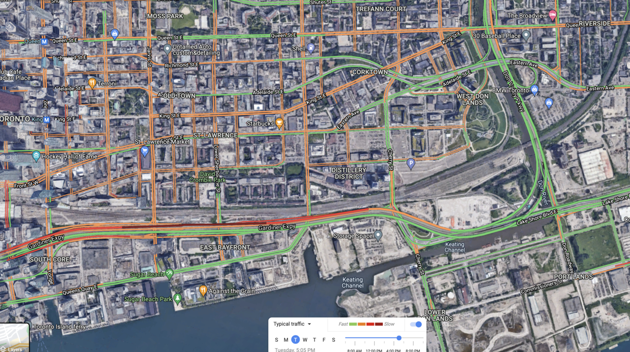

Hmmm.... that's just not my experience at all.
The SB DVP always jams up as it ramps on to the Gardiner in the morning rush hour and even in the evening rush hour the Gardiner often jams up all the way back to the DVP and is quite busy.
I agree that EB on the Gardiner once you pass Jarvis is pretty sparse (so good to tear down the Logan ramp) but I think the majority of the SB DVP traffic ramps on to the Gardiner WB rather than exists at Richmond.
But maybe my perception is all wrong. Weird though, because I drive it every day.
Honestly, I don't drive that route during rush-hour. I'm basing my information on reports done on the Gardiner stating that the traffic seen between Jarvis and DVP can easily be absorbed by an expanded and at-grade Lake Shore Blvd with minimal impact to travel times.
I'll try to find these reports if possible to clear up this question. Kinda difficult to search for old reports regarding the Gardiner east right now coz most of the results are focused on the removal of the Logan ramps. 🤣
