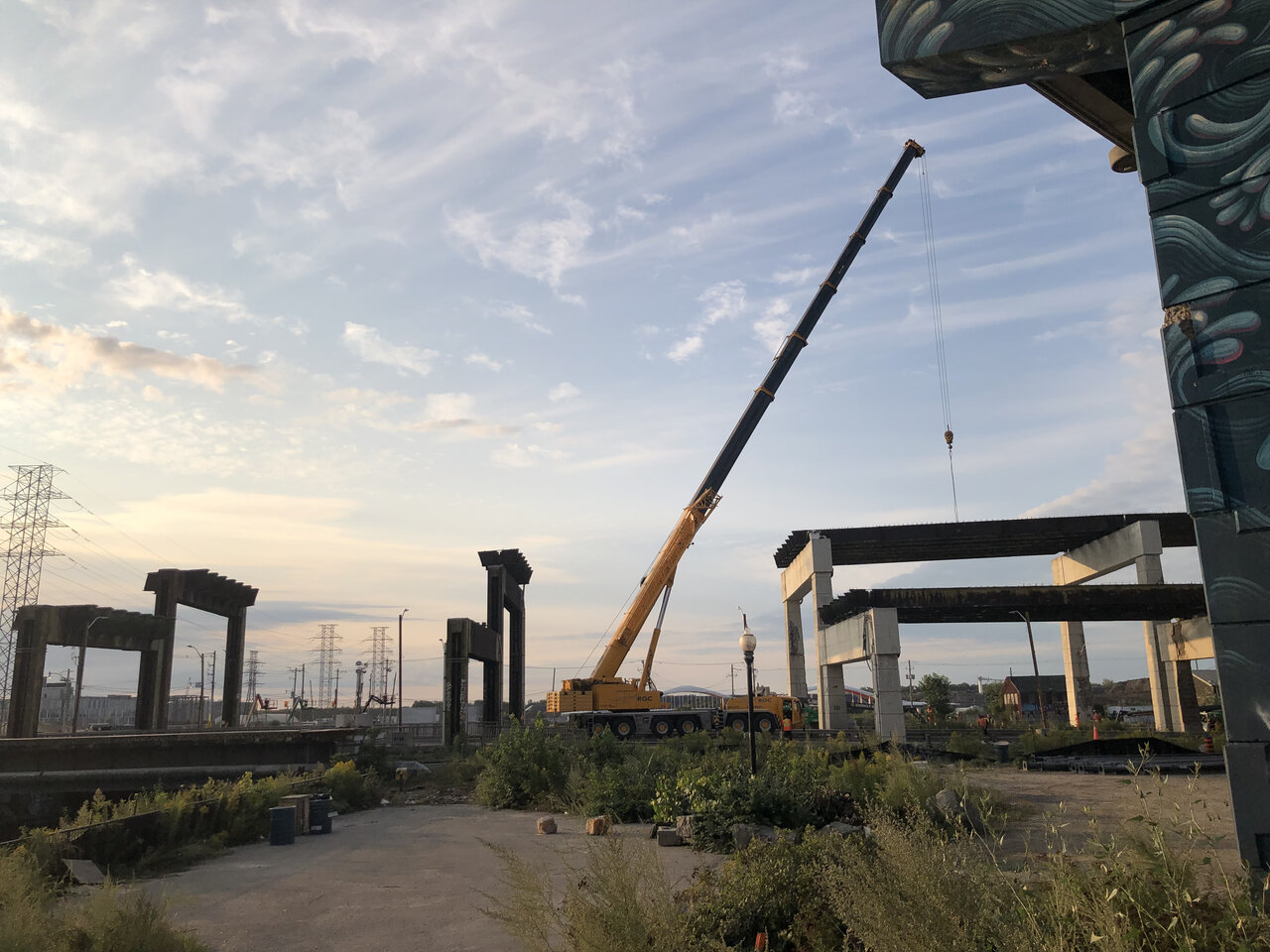

Here is my take on where demo will stop.
Everything for the eastbound lanes can be remove up to bent 330. The westbound lanes can be remove up to bent 315.
Plies of concrete in the centre median with some of it being moved to the south side lot to be stock pile for the time being.
With most of the bents gone at Don Roadway, it sure open the area up and a sign of things to come.
2 sections to the west of the ramp still needs to have concrete remove from the beams as well for the area to where demo will stop. Then there is the ramp itself. Looks like the retaining wall of the ramp is to remove this weekend as well the dirt for the ramp.
Looking at the remaining bents for the first phase removed back in 2001, going to be a fight to keep a few for this phase.
Photos to follow.

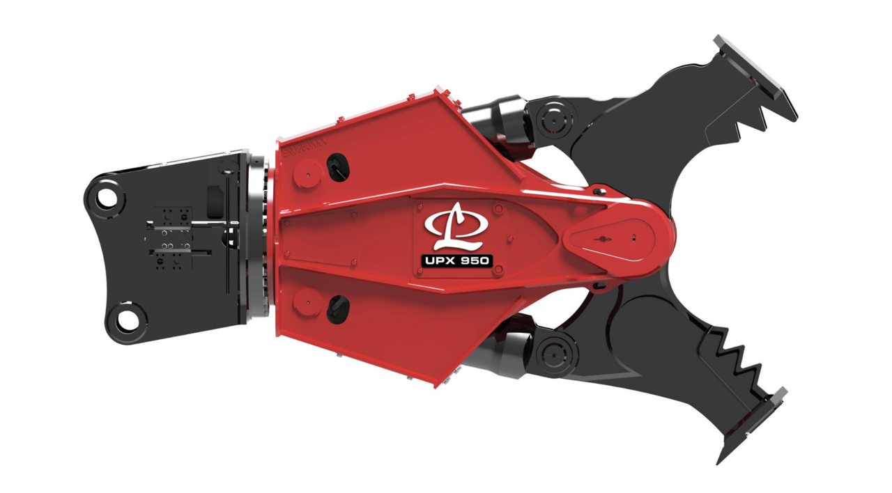

Pretty spot on to the plan, beams will be the main focus this weekend and the most eastern section of decking. Decking will be finished this weekend and majority of the ramp taken out, with a large push on removing beams.
The pillars are quite tough and the big iron is going to be used to hammer and split it open like a flower as the 1” rebar is showing signs of a fight for the large UPX950 Processor.
To give a comparison in these expressway pillars compared to that of say highway 401. Your typical pillar supports on a post tension or rigid frame bridge the upx950 processor can chew them with no backup from hammers in 20-30 minutes.
The pillar at the Don roadway was a good test to see the fight they would put up. It was quite impressive. The UPX 950 failed to complete a cycle and hammers from the 60 ton machines were needed. The large 120 ton machine will be tracked down by next weekend and will hit the pillars along side the 60 ton machines splitting them open and the UPX950 processor will follow eating them a lot easier.
It will be quite the thing to witness as the biggest muscle will be focused on the pillars and it’s paramount there is zero damage to the guardrail so flopping them over is not an option.

Very interesting. Yeah not knowing about any of this I have to say that when i saw how big the rebar was inside the bents I actually said, "Wow!" out loud. It's pretty crazy.

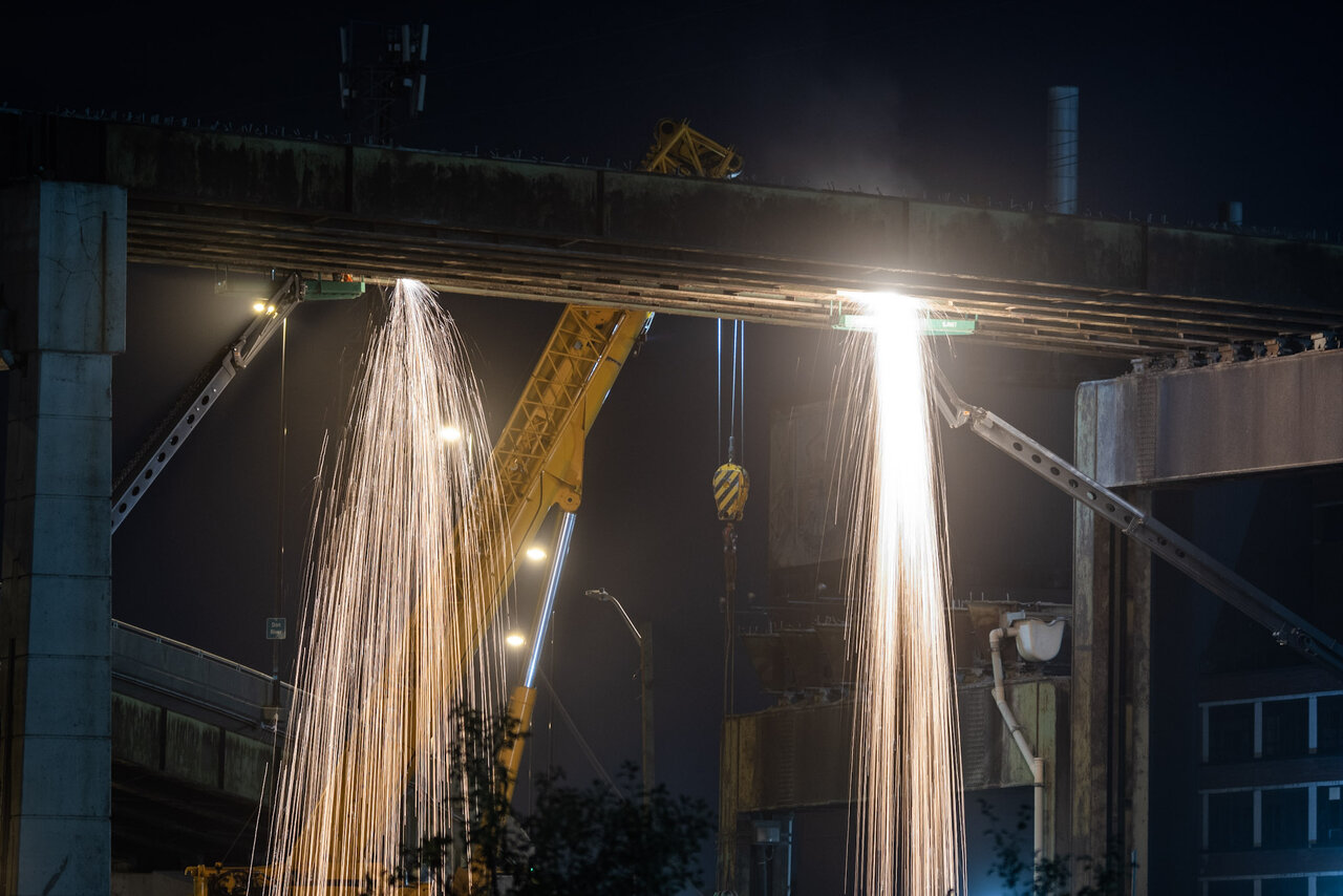

That one hell of a number of bolts for each beam connecting to the bent as well for the bent itself. Cutting was the fast and easy way to remove the beams and will be a bitch to remove the bent.

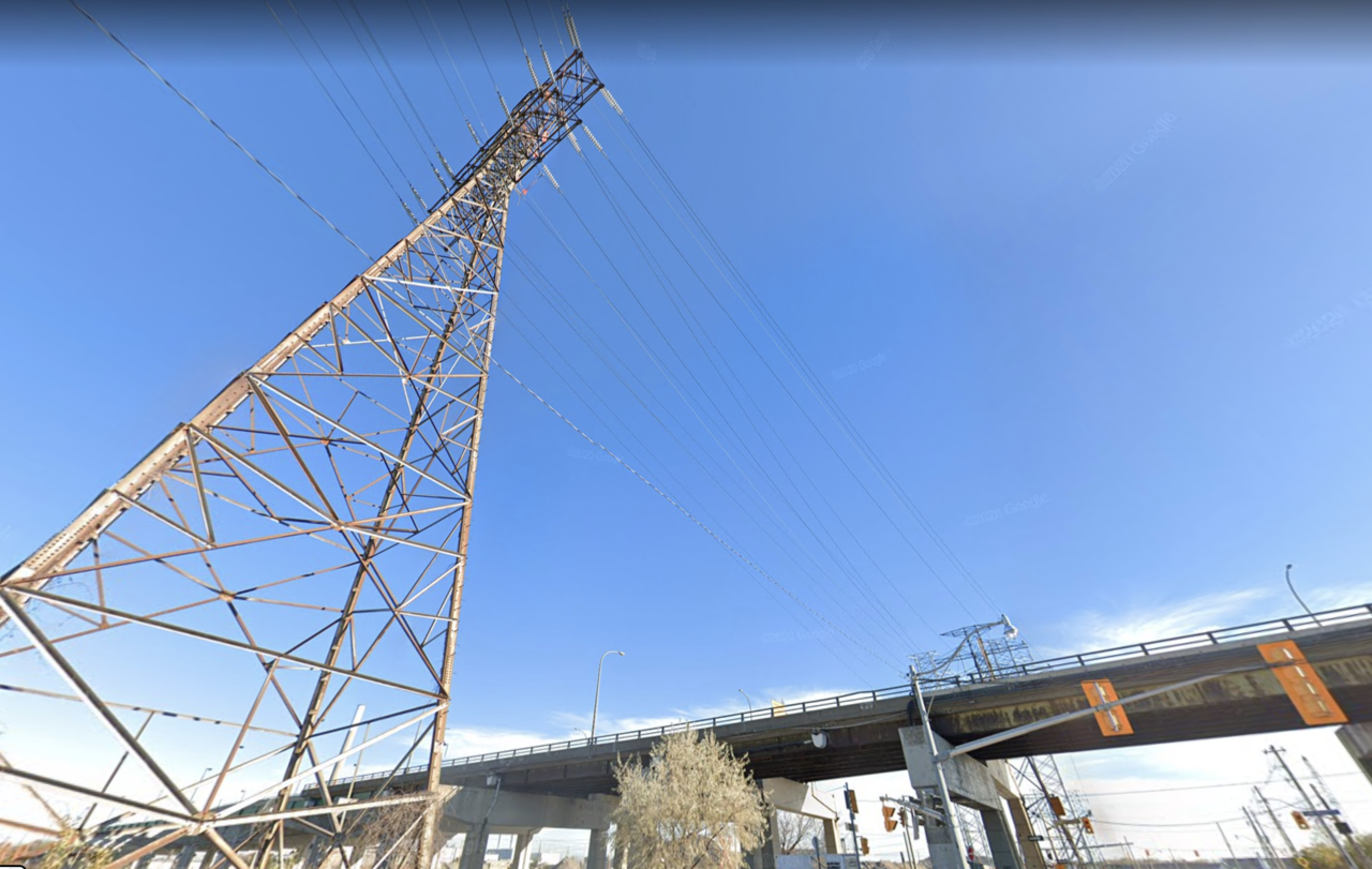

Will the city likely burry the high voltage transmission lines and towers in this area too? View attachment 348291
Not that I am aware of as they are remaining on Commissioner St if and when the LRT gets built on it. They rebuilt thinner towers for the Mouth of the Don
