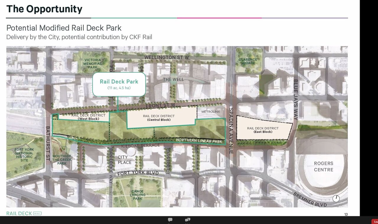

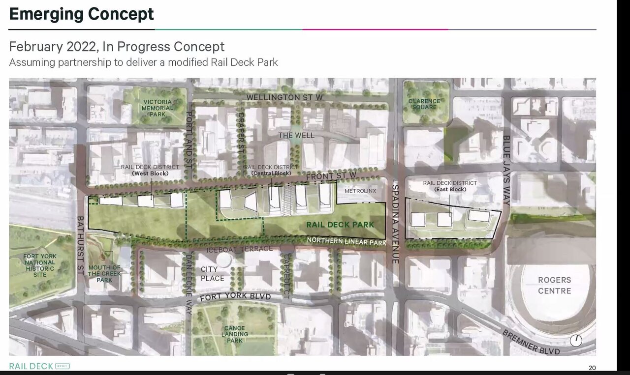

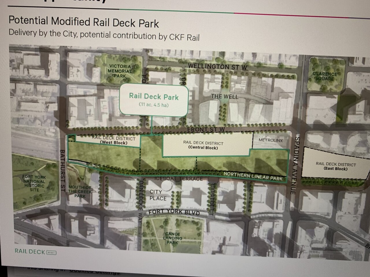

Still not sold on the site plan. The development should front Bathurst and Spadina and leave the entire middle portion of the corridor as park. This just looks like the developer took the easy portions to develop and left the rest for the city to figure out.
Not sure about that. It's good stretched linearly with the sightlines towards the CN Tower. Sort of like David Crombie. Provided there is a park. And I don't think it really works to have towers right on top of the corridor, just only strafing the north sliver.
They were clear that the edge along Northern Linear park would require a slope up towards the park, making a good chunk of that linear space useless. A view corridor is a lower priority than a good public space.
Well the park sure as hell wont be coming to fruition under status quo Tory's watch, whether he's in office for another year, 5 years, or 10+ years.
stupidest plan I have ever seen.. Total embarrassment for the team that put this together. I feel sorry for them and their staff who had to put this shit out.
This proposal is even worse than the last one... There is no way the City is going to support it with or without Cressy and pay the close to billion dollars to deck the rail deck and build a park lol! Impossible. I see the Feds, Province and City coming together and building out the Rail deck Park IMO

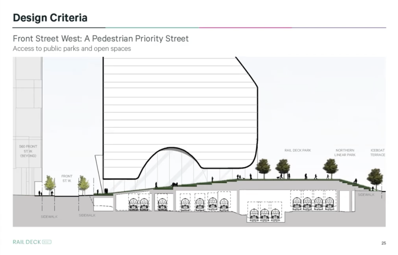

Without elevation drawings ( I saw a hint of it but couldn't grab a screen shot) its difficult to know for sure, but I suspect a real shortage of usable space given the substantial grade change from Front and from other sides of the site.
I've noted that given the challenges of sustaining trees over the long term on top of a deck, that it makes more sense to use this type of space for sports fields, DOLAs and community Gardens.
The latter two, in theory, could include some tiers, but that doesn't work for a soccer pitch.
A design that's essentially ramps/stairs from all sides, with some landscaping at the top makes very little sense as a park.
That's true whether its a 100% City park or a mixed hybrid w/development.
I remain of the opinion that this isn't a great idea for a park, and not brilliant for most development either.
I think there's an intelligent case to be made for some development fronting Spadina, to create an animated street edge; but the rest I'm not overly sold on from a City-building or an economic perspective.
The City needs to prioritize expanding existing park sites downtown that are on terra ferma, wherever practical.

the change in elevation between Front St and City Place is a lot less extreme.
The art of poaching someone else's property is on display.
The elevation change is still material, but to make it a bit more gradual, they need the City to narrow Front Street and cede the land to the park to make that happen.
If the City says 'no' you're back to the old elevation change.
