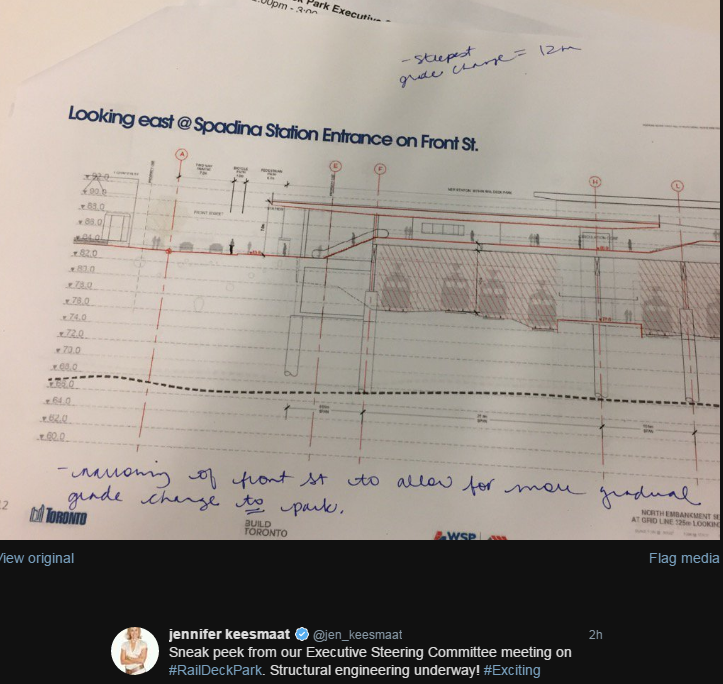

No word on whether they also discussed money trees.
Financing aside (even if they have clear title of ownership of the land) which will be incomprehensively massive (and already over-committed elsewhere if they have it), I'm a little taken aback at the depicted elevation. For some reason, I'd assumed the clearance above catenary would still allow the plane of the decking to be at Front St grade. What's shown is well above the bridges already traversing the USRC.
I note the handwritten note: "- narrowing of front st to allow for more gradual grade change to park". I can understand Keesmaat's enthusiasm for releasing this, but in the absence of some crucial details, it's just a little premature, if not counter-productive.
And just what is the status of ORCA's blowhole?
Note the high level station platform....
Good point! I'd missed that, not that it changes the overhead clearance, but there *may* be some insight from the drawing, even if it is based on preliminary current thinking. Unmistakable was catenary on each track. That high-level platform is an island, or at least one or two bay tracks. Out of habit, I keep clicking on the pic to see more...even if it is just fantasy at this point in time.
Note also the space above the platform ceiling....hmmm...enough for another set of tracks? Stacking tracks (the lower ones sunk slightly) would add justification to having the deck so high, albeit I'd always projected a a ridge along the deck to accommodate that. If a mid-town tunnel isn't built, some way has to be found to increase track throughput for the USRC, and stacking under a deck would appear as a way to do it. It would be about as bright as NY's Penn Station, but decking alone tends to do that.
