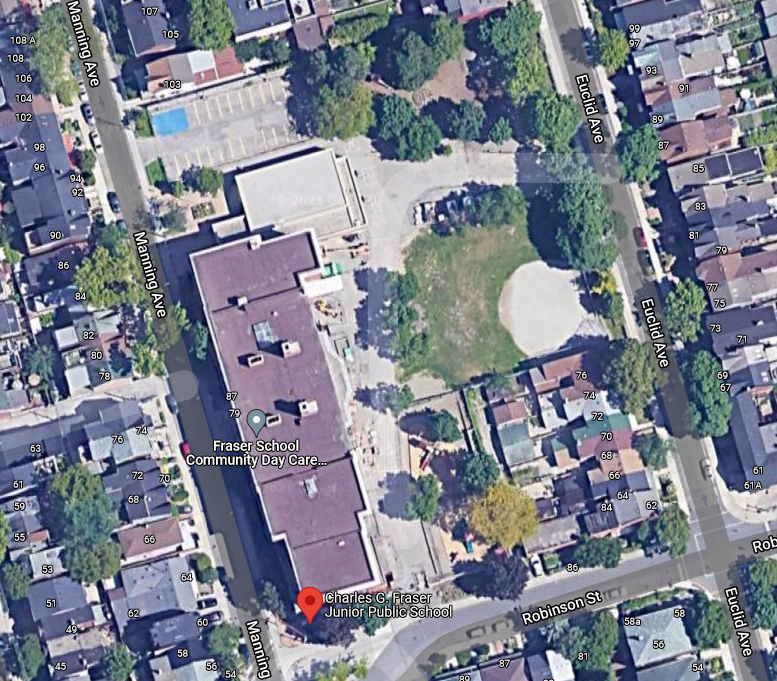

Rebuild of the Charles Fraser Public School playground… with a whole lot of asphalt:
Tough to tell from this aerial view: (but is this significantly more paved that in was before?)
Edit to add, this Streetview from Euclid makes me think so (that there is a net increase in paved area)

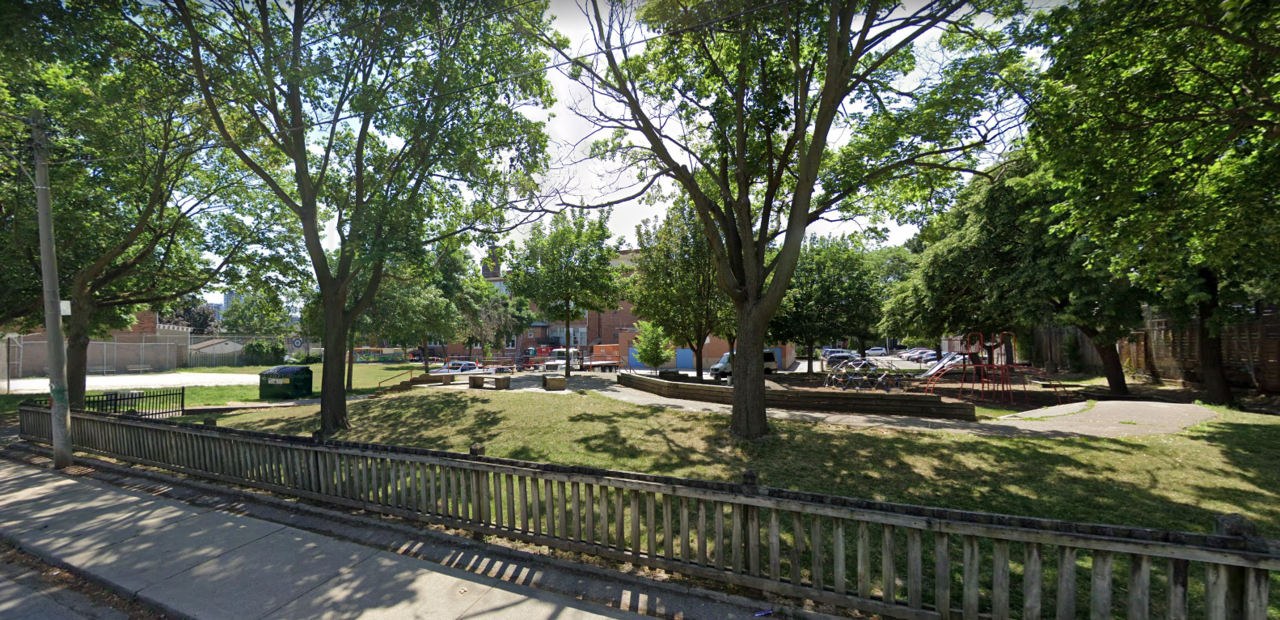

So let take a look at St. Andrews Playground/Park at Adelaide and Brant.
Images have already been posted by others, in other threads of the nearly complete work, but I wanted to see the space active and in bloom.
Have done so, there is much to recommend it...........but yes.........there are problems as we shall see!
Lets start at the south-east corner of the park.
Points for getting a clear, prominent entrance that leads you to the centre of the park, where the playground and seating are..........
However, there is no signage here identifying the park, that's a minus, as are the completely empty planting beds that are both weed strewn and baked into oblivion.
The seating is good, and there should be seating near a park entrance, but I disagree with the placement here, for a couple of reasons.
1) The seating blocks the view of one of the planting beds (not really an issue in their current state, but not ideal once they are planted, assuming they do it properly)
2) The benches are square in style, with straight edges, but the beds are curved, this is a mismatch of design aesthetics.
3) The bed and the grass would have benefited from the protection of the benches, had they instead lined the path into the park.
You can see how rough the grass is in spots in this next image, just in from that south-east corner of the park, looking south-westerly:
Bench placement might reduce the traffic over the grass a bit, and working irrigation would help (we'll come back to that)............but overall, in seeing how this space just south of the play equipment was being used......I'm not sure grass is the right treatment for much of it.
