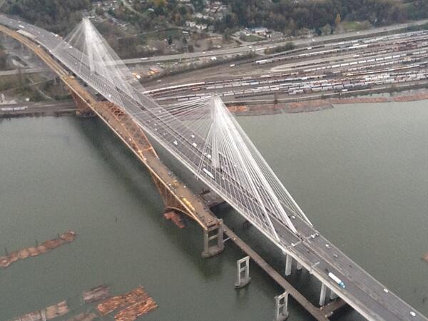

Great Pic from today showing north approach to the old bridge removed:
https://twitter.com/News1130radio/status/398232540244226048/photo/1
