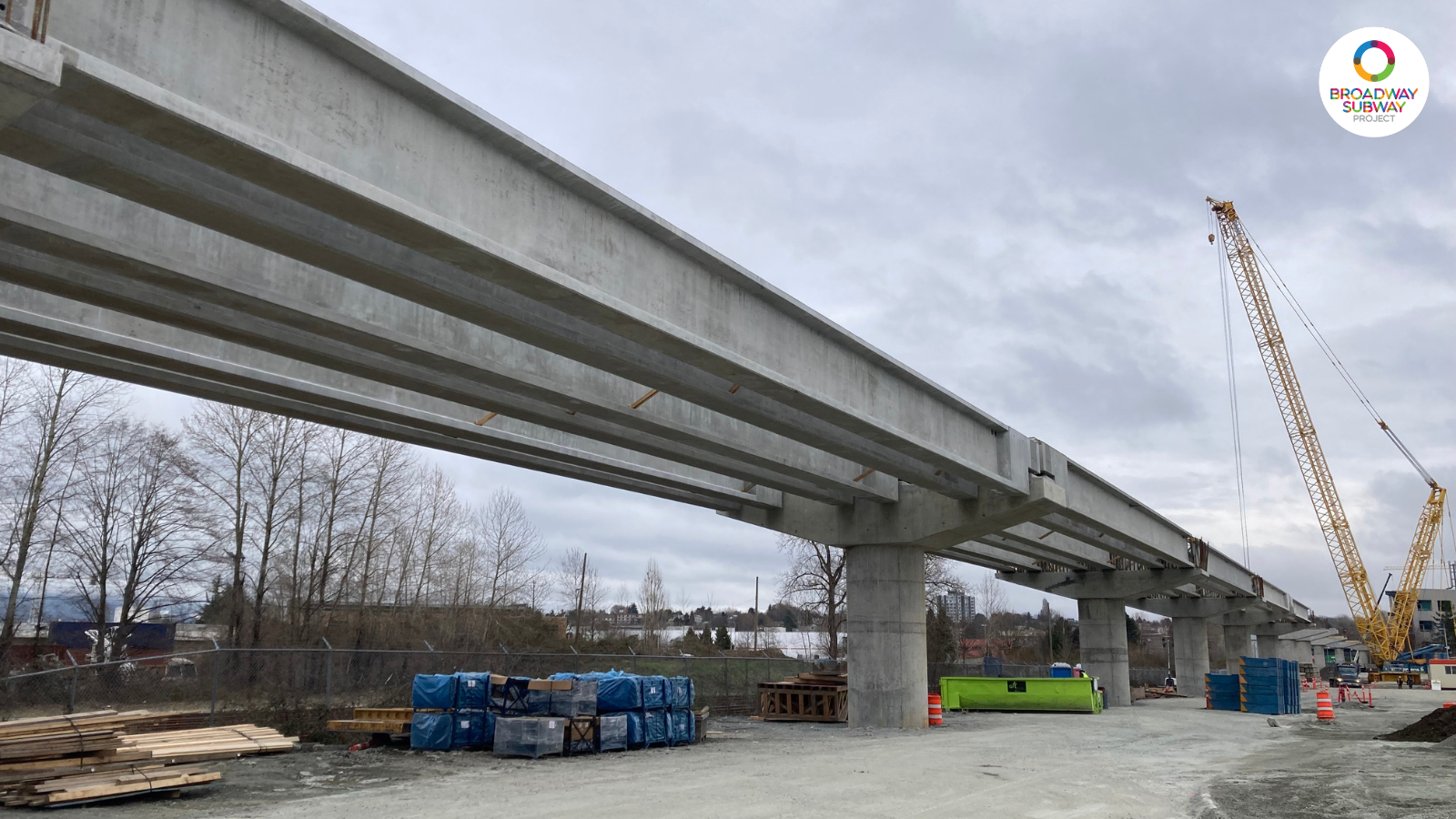

For the elevated section of the Broadway Extension for Vancouver's SkyTrain, some of the girders sit on the column caps, while others are more fixed in place with a concrete plug. It's a short elevated section, so they used girders instead of the segmental post-tensioned system used for longer stretches.
You can see where there's rebar on the column caps in this video:
