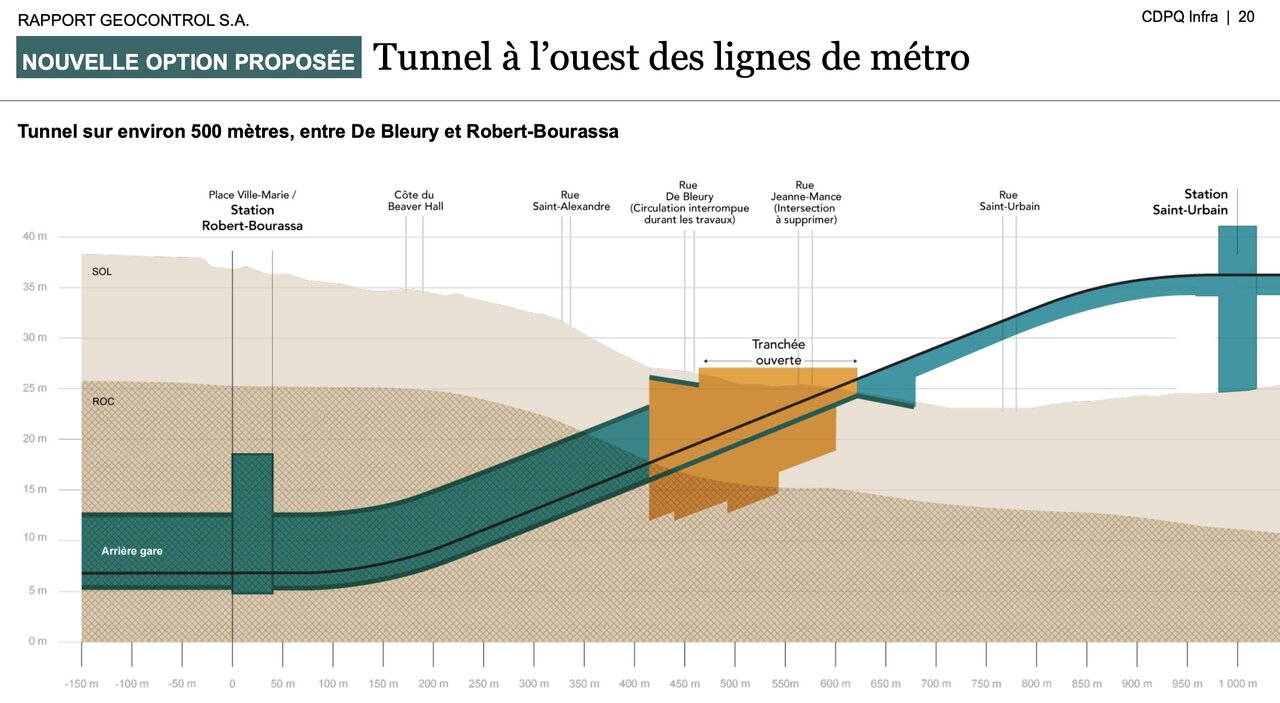

CDPQi provided an update for the REM de l'Est project today:
This is the new plan, with the 500m downtown tunnel and an underground terminal station:

Studies reveal that a longer tunnel would be possible, but it's quite risky to bore a 9.4 meter diameter tunnel just 3.9m under the orange line.
CDPQi is adamant that no company would want to bid to undertake a project with such a risky segment.

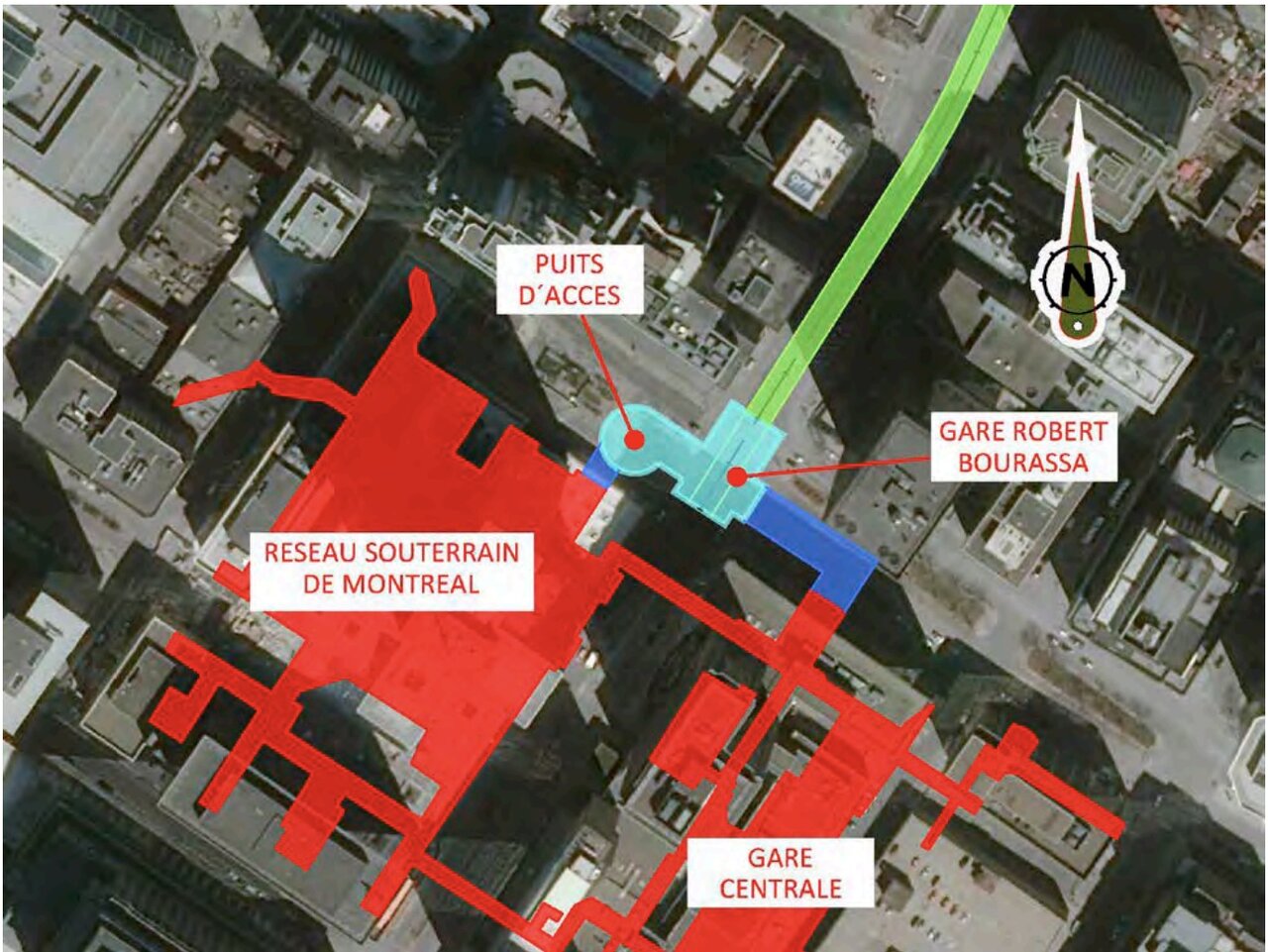

What are those boxes to the left of the station? Are they in any way a problem if Montreal ever wants to extend this line westwards?

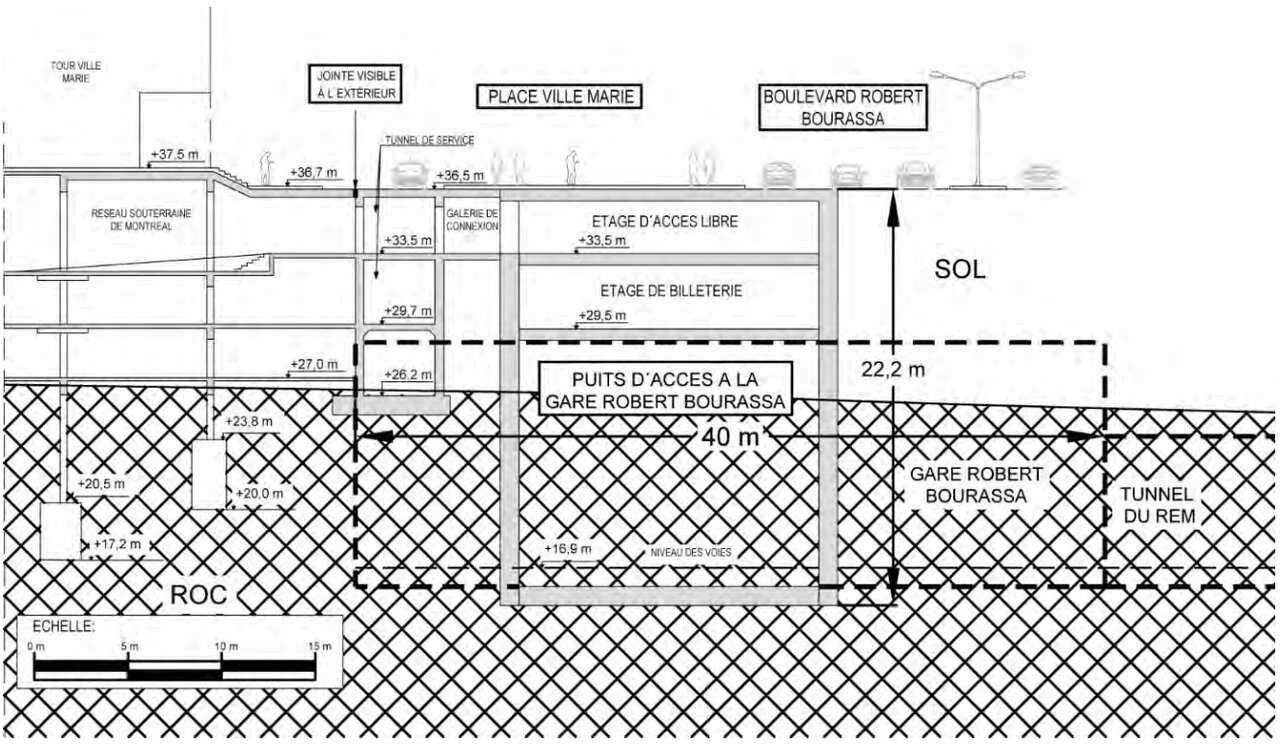

Foundations for the Place Ville-Marie - Central Station complex.
To help you understand: I just made an overlay of the REM station over a Place Ville Marie plan.
As you can see, the Central Station platforms are right behind the end of the REM de l'Est tunnel.
Therefore a westwards expansion appears to be absolutely impossible.
Almost 4 metres clearance seems huge compared to the clearances that the TBMs for Crossrail did - less than a metre in places - without even closing the other tube line in London - at least at Tottenham Court Road.
Though looking at the illustration, I'm not sure why they couldn't build the portal near Labelle, with cut and cover between there and Sanguinet to simply and safely work around the existing tunnels. This would also allow for construction of a station between those locations, connecting to Metro Berri.
