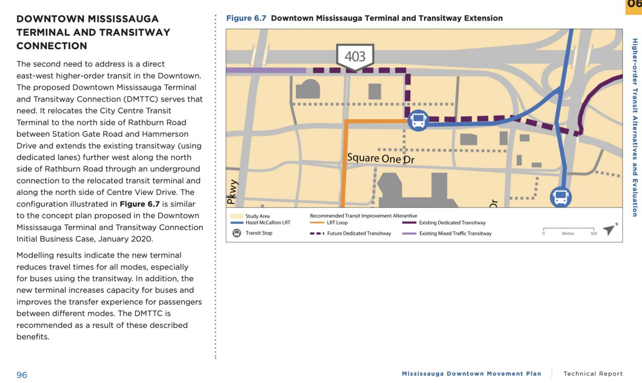

Since the LRT was not built along City Centre Dr as was originally proposed, and the space that was reserved for the second Transitway station and terminal now taken up by the elevated intersection of the LRT mainline and stub, the Transitway would have to be built under Square One Dr to connect with the LRT at Hurontario.
That's what is currently being planned / studied by the City, see below:
More context is available here for those curious: https://www.mississauga.ca/wp-conte...sauga-DMP-Technical-Report-20250227-final.pdf

I was talking specifically just about the Transitway and Transit Terminal. The plan is still very much to build the terminal on the north side of Rathburn, and extend the transitway below grade, parallel to Sq One Drive, before heading north along Station Gate to Centre View Dr.
As for the LRT loop you're right, a lot of what's in that document is outdated at this point.

Can't speak for OMERS intents for their lands, nor for Metrolinx involvement, but the City staff I'm in contact with are putting together an RFP for a TRPAP for the Transitway extension and Transit Terminal as we speak - both in the location & configuration that I described above.
To be fair, it is in the very early / conceptual stages and subject to change so by the time this thing gets shovels in the ground it can and likely will change dramatically - but that's what I've been told.
The Transitway along the north side of Rathburn has been the plan from the very beginning. I am saying they should change it to Square One Dr, since the land that they had set aside for the Hurontario transitway station and terminal is now taken up by the two intersecting parts of the LRT.
