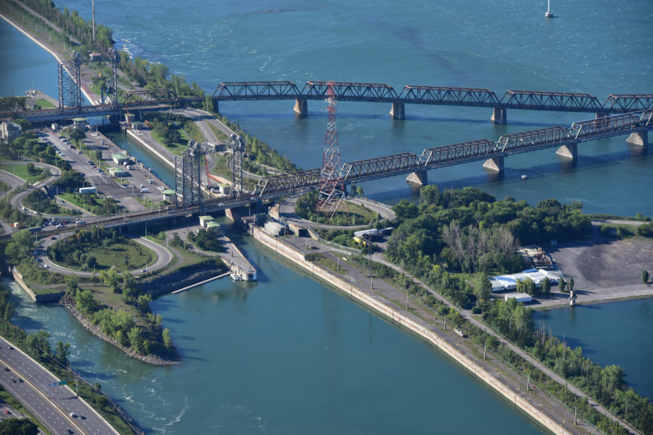

I would actually recommend a "St. Lambert Locks solution", where you have two draw bridges far enough apart for one to remain open during ship movement. If you start at the same spot and head north, to a new glendale road-rail-bike drawbridge, then you would have enough distance, grade, and curvature to do it for both passenger AND freight (giving CN incentive to support the project)

I'm warming, as I've said, to the idea of a second lift bridge on the current alignment like at St Lambert lock.

Playing amateur civil engineer here, the "St Lambert" solution at Thorold would simply be a flyover over the middle flight lock basically at grade. Trains can be routed either on the current route if no boats are using the lowest flight lock, or on the alternate route if they are present. This does not create a conflict-free solution, but it does greatly increase the flexibility such that trains are likely to have a usable route while boats are present, and train-related boat delays are reduced.
The boats have priority not so much by policy but more by the reality of how long it takes for them to pass - once their route is lined, the bridge must stay up, and a train will have to wait.
I have ignored all known fact about things that may sit in the way, my theory is those things might be movable for less cost than either tunnel or high-clearance flyover. That's the nice thing about drawing on Photoshop napkins.
