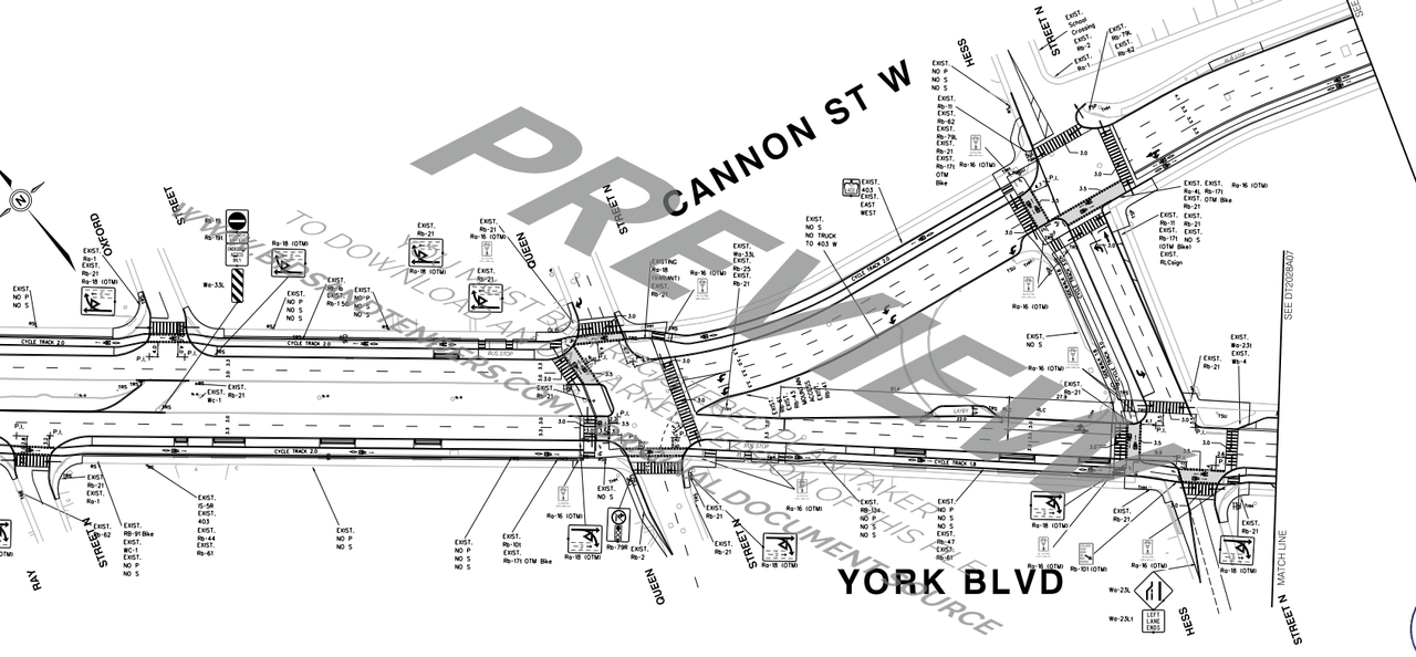

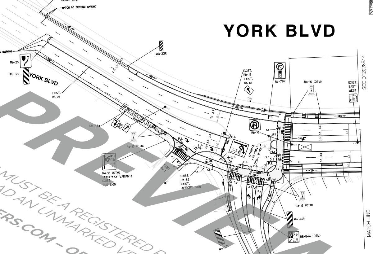

Some key shots:
Involves resurfacing York from Dundurn to Caroline and Cannon from York to James. A small part of Dundurn will also be resurfaced from Jones to York. Curb-level cycle tracks are included, as well as barriers on the existing bike lanes between the RBG and York St-403 ramps further west.
Lane widths on York are being dropped to 3+3.3m, the left turn lane to Dundurn is being extended (yay!), the slip ramps at Dundurn are gone, the Hess-York intersection is cleaned up, a bunch of left turn spots along York are gone, a whole whack of new tree plantings are included, and Hess St will also be converted to two-way between York and Barton (though not resurfaced).

Wow. Thanks for this. Huge changes...will be a welcome update to a key entrance into the City.
Indeed. Going to make the York St entrance to the city great. York St is going to become much more important in accessing the downtown (and likely far more congested) once the LRT and Main St conversion get underway, so it's good to see this happening now to clean it up.

I like a lot of the changes. This is going to be a super fancy street. A few things I'm not a fan of. Lack of westbound cycling connection from York/Bay. Lack of PXO addition (that I can understand) at Park St. This area just requires people to run across 3 lanes of traffic. Lack of fixing the shit show Bay/Cannon intersection for cyclists (though the addition of a concrete barrier is great on the northeast corner).
