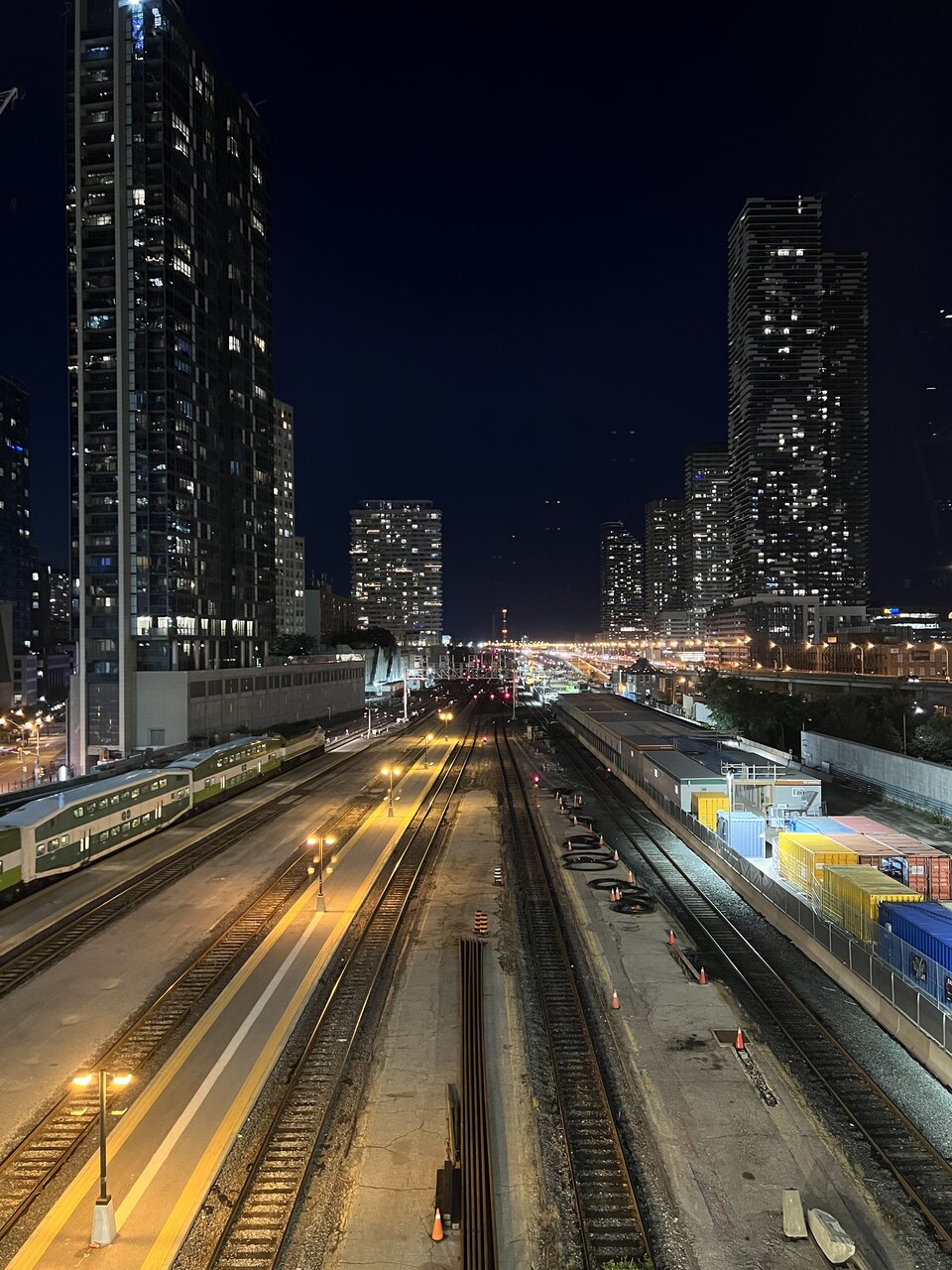

I assume there is provision for some trains to still run through. Are the new platforms they are now building on the south even long enough for double berthing?
The new South platform is 863 metres long split into 4 platforms (2 bay 2 through), each of the 4 can support around 14-16 car long trains. Remember that GO will be running shorter trains after GO Expansion (probably 4-6 car trains with some 8 car trains), so there is enough room to double birth as long as they build the signalling to support it.

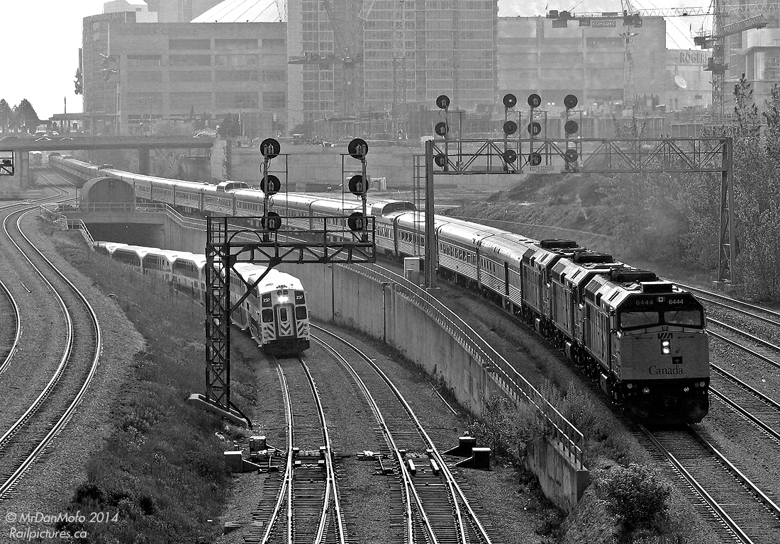

Are they still going to be long enough for the Canadian? The longest ones look shorter.
The Canadian has rarely ever needed to use an entire platform, there’s been few cases where the Canadian was 30 cars long and they were all years ago, so having a platform be that long for a train that rarely reaches that length is unnecessary.
I've seen 18+ offhand. Though I guess it can handle two 12-car GO trains, it should handle a 25-car Canadian. Though I was surprised they were rehabbing the very longest platforms not that long ago.
