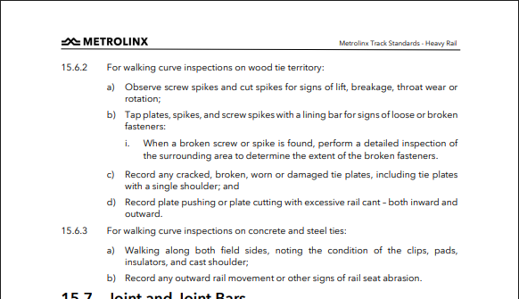

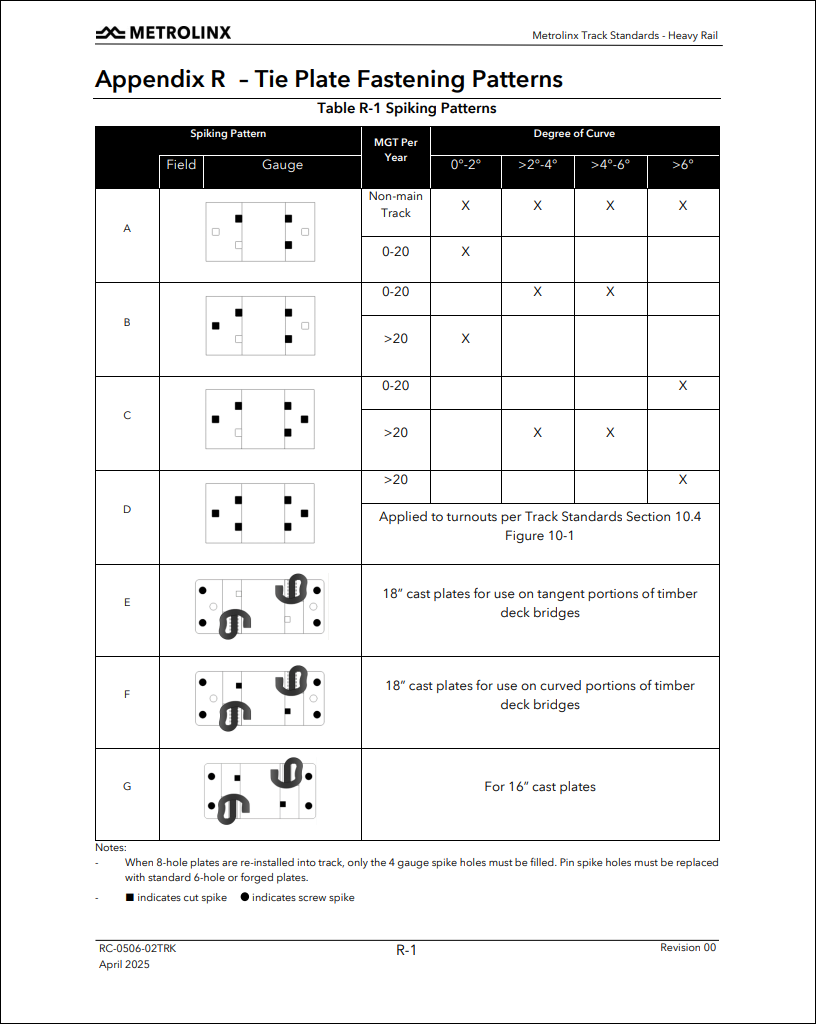

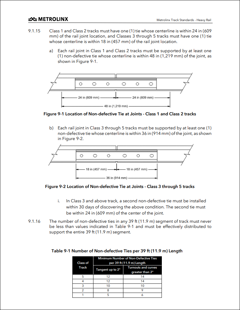

Out of curiousity, I looked a couple of these up in the MTS.
  • "Effective immediately, all curves within the Union Station Rail Corridor must have a weekly walking curve inspection compliant with MTS 15.6.2."
  • "Spiking pattern in conformance of requirements in Appendix R of the Metrolinx Track Standards including rolled plates conforming with Spiking Pattern E."
  • Tie Conditions per Section 9, clause 9.1.15 and 9.1.16 of the Metrolinx Track Standards (MTS).
