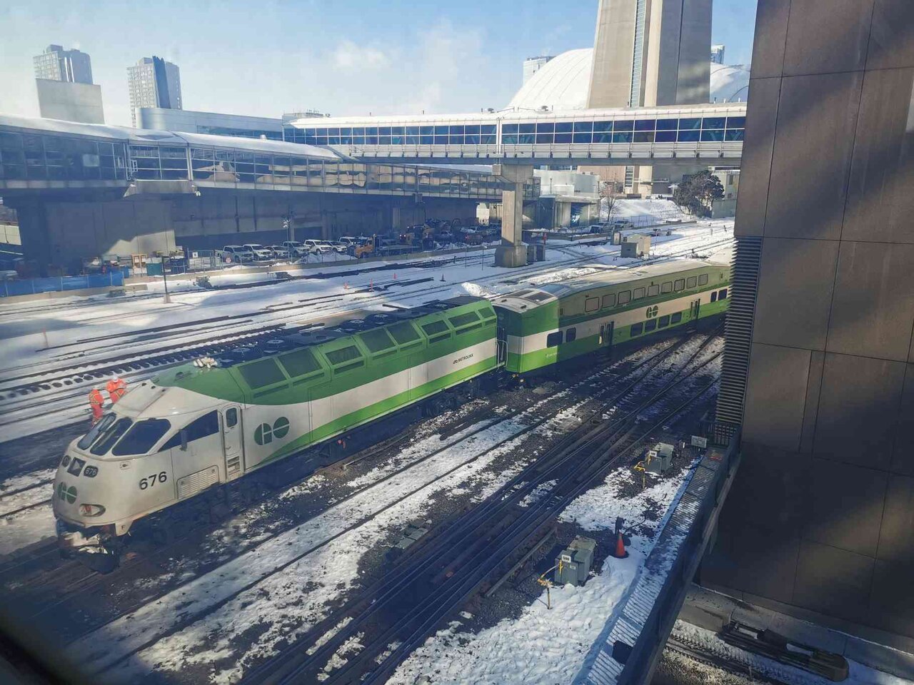

I assume the location and the need to bring in cranes/trucks to lift it. The northside is a building, the MTCC north building/hotel.
Lots of telecom and power cables, and gas pipes for the switch heaters….and the double slip switches themselves need to be protected from further damage..
Can’t just drag things. Finding jacking points etc must be tricky. Plus the need to repair whatever was damaged, and inspect and test everything.
Definitely a very tricky spot to work in, really happened in a critical location.

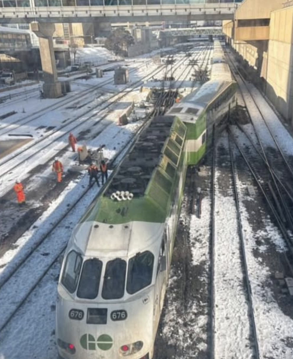

This photo from Mr Lindsay's post is interesting - note the cluster of workers gathered around the switch to the east of the engine.
If the last coach and loco were already off the rails by the time they passed over that switch, any amount of damage could have been done...and then again to the switch that the locomotive came to a stop on.
Those double slip switches have lots of moving parts, and it's understandable that it will take time to get everything fixed and back in adjustment.

A train derailed fouling 2 of the ladders and 3 platform accesses in the USRC damaging a bunch of components and the signal system, and in a location where they can not access the equipment by crane.
There is no world in which this is a "simple" derailment.

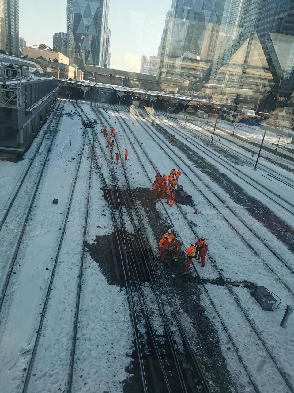

It would be interesting to find out where exactly the original derailment happened, and what the dynamcs of that initial event were.
This is precisely what happened.
The rails rolled under the loco and last coach as the two of them were approaching the double-slip on Depot 3 / A1. The outside rails of the double-slip guided the two over to A2, and it contacted the double-slip there.
Other than a couple of hundred feet of track on Depot 3, I don't know yet how much more is going to have to be replaced.
