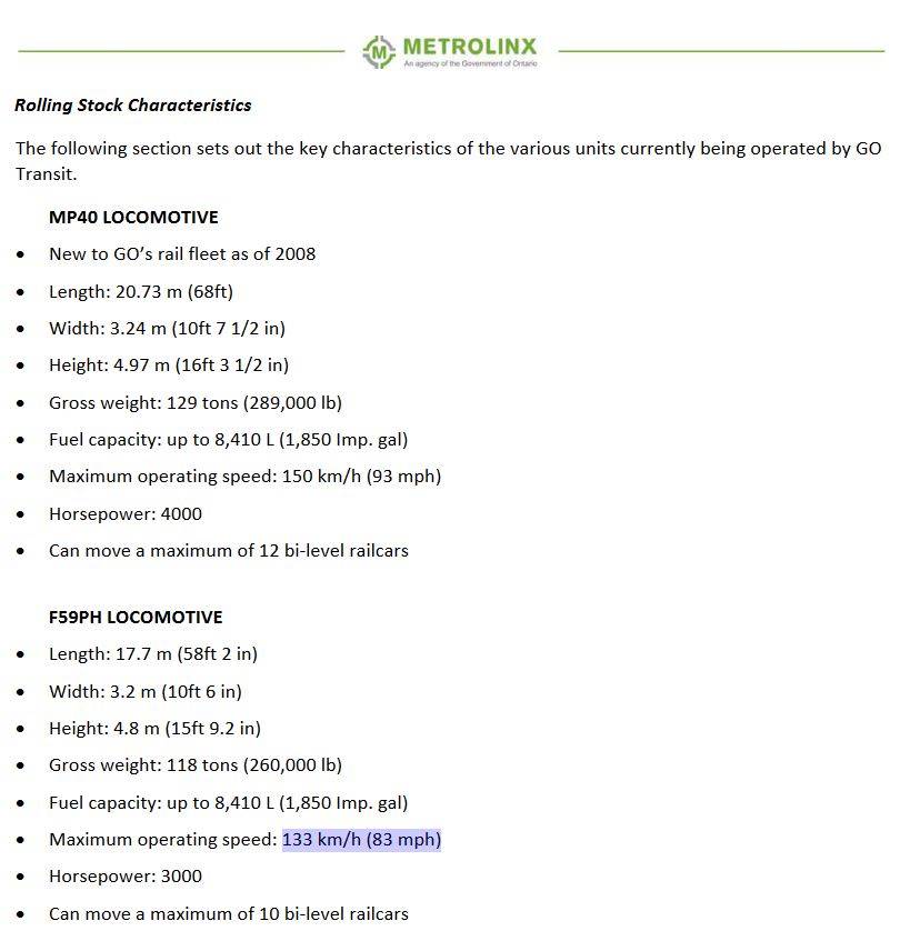

GO's F59's have a top speed of 83 mph (133 km/h). I'm not sure what the speed limit is for the coaches, but they do operate up to 93 mph (150 km/h) in regular service.

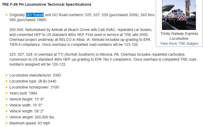

As for the F59's I find that very surprising, i'd love to see some documentation on that. Most F59's have a 110mph top speed, and the ones own by GO were refurbished in 2011. I can't imagine they would be run down by now.

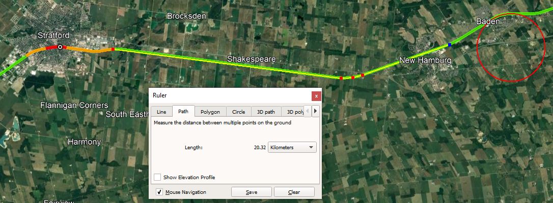

The line is definitely very straight, and definitely can (and should) be upgraded for speeds much higher than its historical 70 mph limit. I'm not questioning the number of straight sections, I'm questioning the length of each straight section.
Here are the 3 longest straight segments along the line:
20.3 km from Stratford to New Hamburg. Flanked by a ~ 60 mph curve to the west, and a stop in New Hamburg or Baden to the east. The curve in the middle has a radius of approximately 3000 m, which is suitable for 110 mph.
16.6 km from outside St. Mary's to near London Airport. Flanked by ~70 mph curves.
14.3 km between Stratford and St. Marys, flanked by ~55 mph and ~40 mph curves.
My intuition is that the first two may be suitable for upgrades to 110 mph, but the second one may be cutting it a bit tight as far as how much time trains can save by exceeding 100 mph. If someone has time to do a back-of-the-envelope estimate assuming acceleration and deceleration rates, I'd be interested to see the difference. This blog suggests that at 79 mph, the acceleration rate of a similar consist is 0.1 m/s/s.
The remaining straight segments are quite short, so I don't see them accelerating by 40 mph (64 km/h) from 70 mph to 110 mph, just to immediately shed off all that energy by hitting the brakes.

https://www.metrolinx.com/en/electrification/docs/Appendix3.pdf
https://www.dart.org/newsroom/trefacts.asp
My understanding is that the top speed of GO's F59's is lower than some other F59 variants because GO selected a gear ratio which would allow them to reliably pull 10 BiLevel coaches despite only having 3000 hp.
