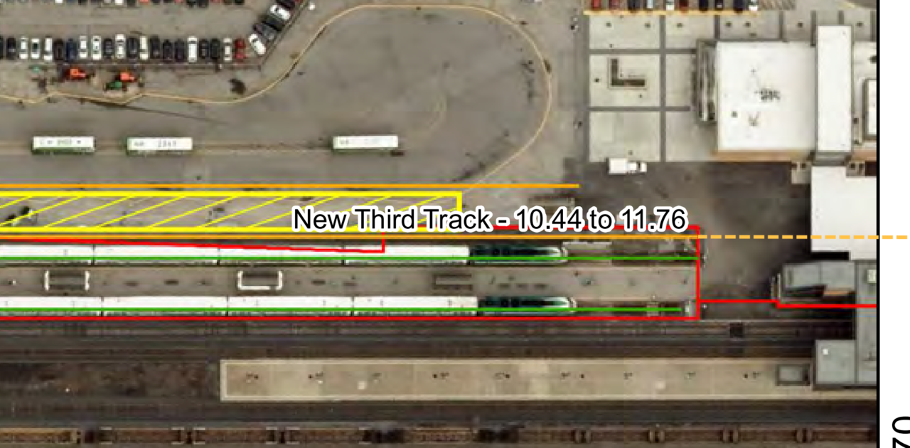

This could go under GO Construction, but I'll put it here since I'm going to refer to the Bowmanville Extension. I wonder if the drawing below from PDF page 40 here provides some insight for what may happen at the Oshawa Station for the Bowmanville Extension. Source: https://www.metrolinxengage.com/en/content/new-track-facilities-environmental-project-report
Dashed lined for the Extension added below. Not sure if a second track would extend under the new Oshawa Station platform bridge (picture here looking west towards the existing GO tracks).

The changes at Oshawa station aren't an impediment to that. The proposed change merely moves the existing platforms to fit under the new station passenger bridge. They don't preclude anything related to Bowmanville - the curvature of the line GO will have to construct begins to the east and isn't affected. While GO would have to share the use of the bridges with CP, the big issue is switching rather than track and time. There's still some headroom available at the north end of CP's yard. I wonder how CP would feel about switching from the south end - it's on a curve, and crosses Stevenson Road, but it's a thought.
Worst case, ML might have to double the bridge across the 401. That's not cheap, but technically it's a fairly simple solution.

Did you add the dashed line yourself? Ok that confused me for a bit.
What you are seeing here is a third track and 2nd platform being built out to Oshawa simply for being able to roll trains out of the whitby maintenance facility into oshawa easier and start trains there.
Granted the bowmanville extension will be changing up the Oshawa go station in 5 years, but again that project is unrelated and changes will be made then.
This project is completely separate form the bowmanville extension. There is litterally no relation
I know this because the peeps at metrolinx at the TPAP meeting in stage 1 back in february faced so many questions about it. When the reason they were there was for that TPAP.
^ Yes, I did add the dashed line. Sorry, thought I made that clear.
Totally get that the project is separate from the Bowmanville Extension, but is it safe to assume they've designed the platform/track for this TPAP in a way to make it easy to do the Extension? Given it's now been over a year and a half or more since the CP GM spur route was mentioned (at the May 2019 Durham townhall) I assume that there was some alignment.
Just for clarification re "The proposed change merely moves the existing platforms to fit under the new station passenger bridge" - from the above track plan, it doesn't look like to me any of the existing platforms need to change? It looks like they are only adding a new platform to the north.
That's a good point. I took another look at the drawings. My first thought was that once a track is extended eastwards, all track access would have to be from the bridge.... but it does look like the new track is a stub track, which effectively shifts the two stub tracks northwards, so they can be accessed at grade. It would be the southmost existing stub track that is extended, and that wouldn't block at grade access to the other two.

remember it was 2019 that metrolinx/transpo minister said they were taking another look at it.
it litterally was like 2 weeks before the tpap open houses in February that the option for the "GM spur" was selected and announced
Im telling you that there is no way for theese plans to have consideration for the bowmanville extension.
The picture you are looking at is the exact same that was announced at the start of this year
With that said....is it possible that it can be extended based off those pictures? probably, but thats a question for 2025 when the detailed planning and design will start...and that is ambitious as it is
^ the date on the plan says October 2020. The Bowmanville Extension IBC with the GM spur as the preferred option came out in February 2020. So I'm going to assume/speculate that the team's did some coordination, but given the space/passenger bridge created with the new Oshawa GO station, it doesn't appear to be that difficult to extend a track east for the extension. Don't mind at all if someone disagrees with my speculation/assumption on this.

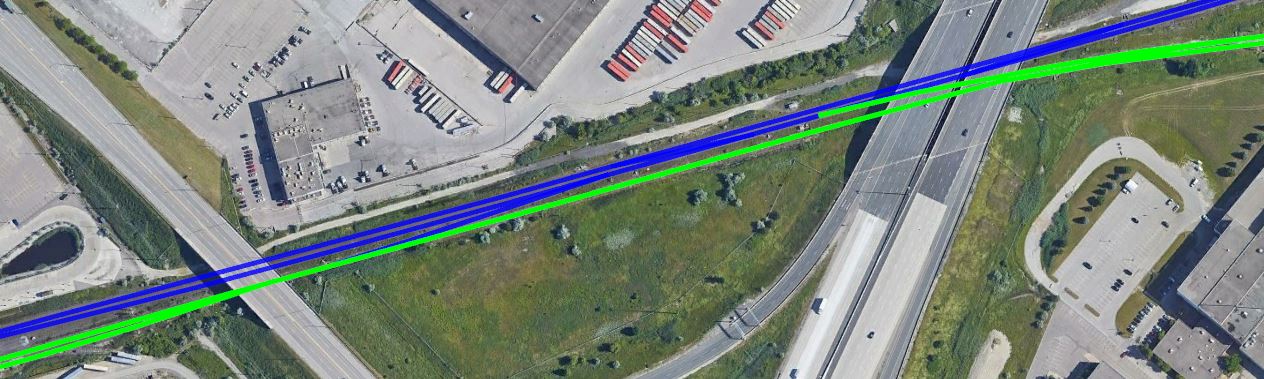

I just had to poke at the Oshawa platform layout a bit more. The northmost platform at present is a siding track connected to the Kingston Sub, and accessible from the north. No bridge is needed at the moment, but if a GO Bowmanville track is extended towards Bowmanville, that bridge will need a new section added (it's likely roughed in already) and the only access to VIA will be by going up and over.
Seems unlikely that the current south GO track could be bent up and through the gap on the north side of the existing bridge stairway, due to curvature. So it is indeed a puzzle as to GO's intention. Given that the latest plan is for 2WAD all the way to Bowmanville, one would expect GO to want two tracks through the depot. The change in the layout of the stub tracks could be interim, I suppose.
