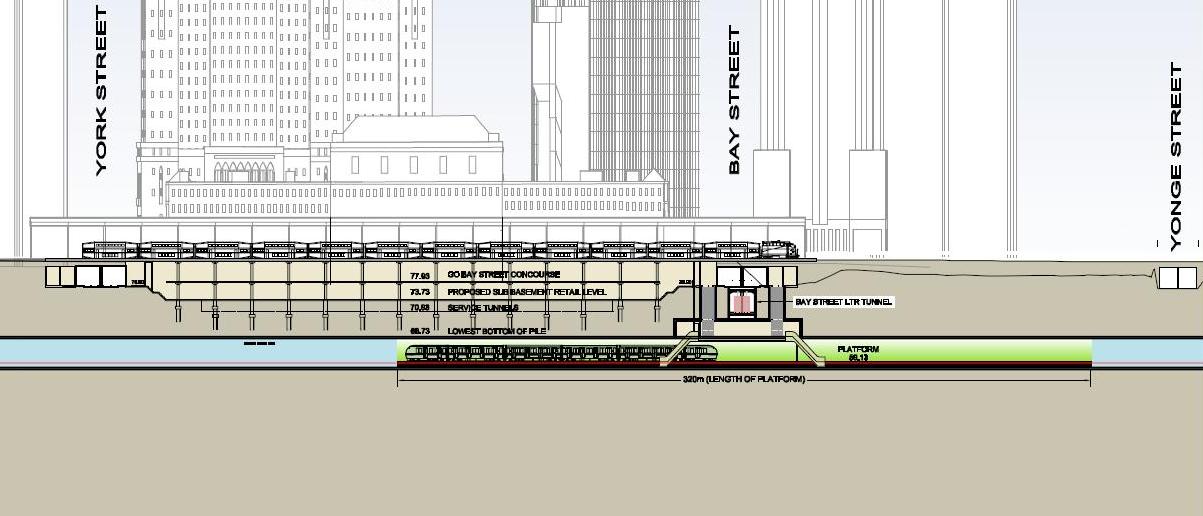

Probably the most critical piece to make all of this work is the tunnel under the Union Station Rail Corridor to run RER service.
I don't think such a tunnel would really be needed for a RER network. Union should have plenty of physical room to accommodate new services. The assumptions which lead to USRC Capacity Study to suggest a new tunnel or terminal station seem questionable and in any case undermine the entire point of RER networks (high frequency 'through' routes).
Paradoxically, we may need to reduce the total number of platforms at Union to create wider RER platforms with better vertical passenger circulation.

Basically, the cost to add a tunnel under Union would start at 1 to 1.5 billion and go up from there. It's really quite a lot of money to double down on a corridor which is quite wide as it is. If there ever was an unavoidable capacity constraint (which I don't believe will happen in our lifetimes), the solution would be to start offloading the Intercity and Regional trains somewhere else (a new North Toronto Station?) where they could sit for longer without displacing trains serving much busier local routes. If space really is at such a premium at Union, then it should be catered to routes with the greatest ridership potential which means 'local' routes.
Didn't the complicated nature of the pilings below the rail corridor through Union pretty much make relocating of tracks in the shed an impossibility? Someone is going to have to elaborate here, since I'm not exactly sure where this came from.
I know throwing all of your trains in one corridor may not be the most ideal, however, I really don't think a North Toronto station is possible. Even if it were possible, diverting trains to the North Toronto Sub would not connect well with the existing/planned Subway network. At least by having Union it would be possible to have metro-rail stops on the fringes of downtown to intersect with the DRL and Streetcar/LRT network, as well as provide frequent service on the same corridor where lines overlap.
It would be wonderful if Metrolinx is able to get electrification and PTC figured out well enough to not need require constructing a tunnel or building a second station in the Bathurst yards. We'll have to see where system upgrades go in the next 10 years to find out.
Wasn't one of the major capacity constraints of Union the fact that all the lines are basically operated as terminating lines, requiring significant time for them to reverse directions? If they switch to through service, this should allow much shorter dwell times at Union, and for service that does terminate there, shorter trains (presumably the outcome of more frequent electric service) wouldn't take as long to inspect when reversing directions.
