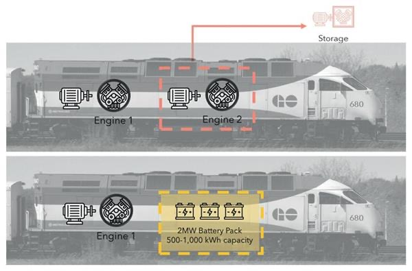

Colour me a bit confused because while we have 275 pages of possible battery use. MX has semi-publicly confirmed plans for a hybrid loco conversion. With a public tender out too since last December
Why are we acting as if Metrolinx is completely against hybrid electric?

There are, broadly, two different scenarios where Metrolinx/GO might need hybrid locomotives:
  1. To extend beyond a core network which will eventually be electrified. This would only justify the conversion of part of the existing GO fleet (i.e., for those trains operating beyond the electrified core network).
  2. To bridge an electrification gap at Union Station. This would justify a full conversion of the existing GO fleet (as all trains operate through Union Station).
I suspect that the number of locomotives to be converted would give us a hint of which of these two scenarios might have motivated this RFP…

This concept design makes no logical sense imo. Why do they keep insisting on reinventing the wheel when Dual-Power locomotives already exist that can meet the needs for all lines and Union Station? Both Siemens and Alstom already make models for the North American passenger rail system that would meet the needs of GO both pre and post-electrification. Especially since long-term plans include running more frequent but shorter trains anyways.
It might make no sense in a lot of other settings, but it might well make sense here - considering that this is a testbed and not a decision to replace the entire fleet.
It makes sense thanks to having lines that need to coexist with freight landlords who are opposed to wires and also likely skeptical about the prospect of all-battery trains blocking their lines when the battery fails.
And it makes sense as an experiment with a fleet that might not be totally at end of life - those newer offerings come with their own power sources and parts aupply and learning curve. A hybrid that sticks with the known and maintainable diesel and control systems is less to swallow.
Plus I would challenge your claim that new models are actually out there for the taking… can you cite a single property where they are out there in production service ? Sure vendors will offer them, but ML would be unwise to go out on a limb as the first to bite.
A single test bed relying on what ML knows best makes a lot more sense for now.

Both exo and NJ Transit use the Bombardier/Alstom ALP-45DP which is remains in production as NJ Transit (designated as ALP-45A) continues to order more of them and has ordered 12 more of them this year.
From the Siemens side, 2 models exist within the Charger family and are in production:
  1. ALC-42E for Amtrak services that utilize the Northeast Corridor for portions of their journey or enter New York Penn station via the Empire Connection. This model uses a full size ALC-42 diesel locomotive semi-permanently coupled to an auxillary power car configured for either Battery-Electric operation for Empire Connection services (ie. Maple Leaf, Empire Service, Adirondack, Ethan Allen Express, Lakeshore Limited, etc) or Pantograph operation on the Northeast Corridor.
  2. SC-42DM for Metro-North, CTDOT. LIRR, NYSDOT which have been ordered in two different configurations:
    - Diesel and DC Third Rail for Grand Central, Penn Station via Empire Connection services
    - Battery and AC Pantograph for Penn Station via the Northeast Corridor.
The ALP-42E is not applicable as it requires a special passenger car to install the pantograph, transformer, and additional traction motors.
The other two models however are both good examples of dual-mode locos built for the North American operating environment.
The electrification {partial or full} are there and the technology is sound. This has NOTHING to do with a lack of options and everything to do with the fact that ML has no intention of electrifying even part of the system for at least a decade.
This is not rocket science and everywhere else on the planet manages to run electric trains but it's simply "too complex" for Toronto. Running the current slow and polluting tanks they currently have is the "do-nothing" option and if there is one thing ML excels at in regards to electrification it's doing nothing. Think about it........they have talked about electrification for 2 decades and were given enough money to do it and yet they haven't managed to get a single pole in the ground, no substations, and couldn't even bother to put the rolling stock out to tender. They have accomplished nothing which is exactly what they wanted and there is absolutely, positively, no reason to think their mentality will change. This new 2032 deadline would be completely laughable if it wasn't so sad.
