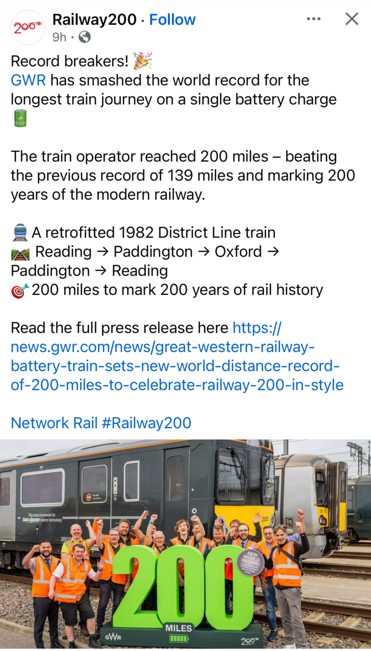

A cautionary tale for those who feel battery trains are ready for prime time. Still a ways to go.
Great Western Rail released a white paper "Fast-charge battery technology: A viable option for regional rail?" discussing their experience running this class 230 unit and research by Arthur Little. They suggest that partial overhead electrification of tracks with fast-charging of large amp-hr train batteries (at stations) would be a cost effective alternative to full electrification, for the 158 miles (255 km) UK western mainline from Bristol to Penzance. For reference, the rail-distance between Bramalea and Kitchener is ~75km.
I wonder how the weight of the former D Stock trainset compares to anything comparable you could put in North American mixed traffic (esp without PTC)
According to Wikipedia a 3-car D train is about 27.5 tons. Not sure if the battery adds weight to that.
Weight is one consideration, HVAC load may be another.
Certainly battery power is coming, but on the mainline it would mostly suit low-utilization peak trains that layover for much of the day and overnight. Not gonna see an Oshawa-West Harbour 2WAD train running on battery.....yet. But maybe not too far off.

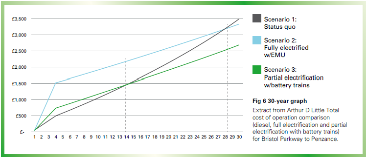

Great read, some other highlights and a few of my thoughts below:
It looks incredibly cheaper in the upfront infra costs, although this study was done by retrofitting trains with electric motors already fitted. GO trains would need to fit batteries and electric motors, or entirely new cars.
(Note: this was tested on a 2-car train, hence 84x3x2=~500)
Obviously a lot of factors at play for power consumption but for fun if we assumed similar conditions (7km/minute charge), you could yield something like the following:
Bramalea -> Brampton: ~6km (charge 1min)
-> Mt Pleasant: ~5km (charge 1min)
-> Georgetown: ~8km (charge 1min)
-> Acton: ~10km (charge 1min)
-> Guelph: ~21km (charge 1min)
-> Breslau: ~15km (charge 1min)
-> Kitchener : ~8km (charge 4.5min)
10.5 mins charging to recover ~73km of travel.
As described in the white paper, there’s also opportunities for integrating “short stretches of overhead lines for on-the-move charging.”
