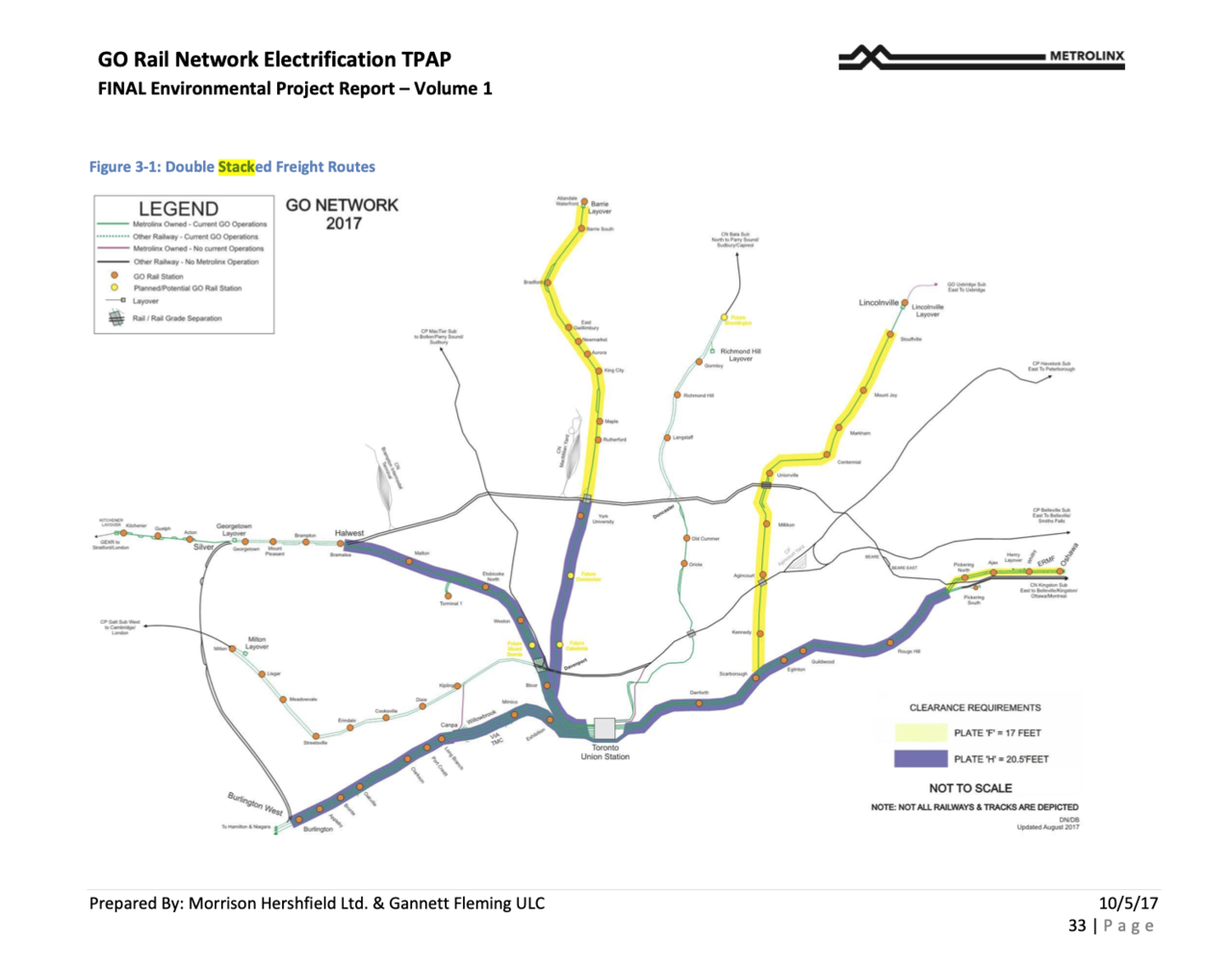

The preferred clearance specs were laid out in the Electrification EA, and I am confident that they were specc’d to meet any equipment that GO might anticipate buying, as well as “conventional” freight that might happen on GO lines.
If you look here at page 33, and here at 5.2.1, it appears that ML provided a double stack route through its lines, but that clearance is not provided on all routes and not on all tracks within the double-stack-friendly routes.
It's a bit moot considering that neither CN nor CP will agree to electrification on their tracks, period.
Certainly the Indian Railways have proven that double stack can run under wires, but how their spec compares to GO's I am not aware.
@smallspy I assume part of the issue here is that CN infra is cleared to plate K (for autoracks) and inserting plate H electrifIcation downgrades the route? Aside from clearance, do the freight roads have other objections, like “servicing and fault repair of the electrical gear will cause increases in track downtime”?
