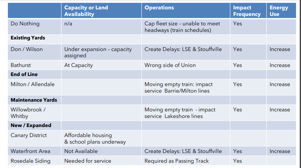

Metrolinx noted in a June 2021 presentation why the Don Valley Layover is needed.
How can this study not include a look at a Leaside Yard but include looking at Whitby? They go halfway up the line to Leaside but don't consider Leaside despite it being right next to the Ontario Line yard. I don't get it.
Probably because CP Rail wasn't interested or was unwilling to share the land at the Leaside Yard. It's also a further deadhead trip to/from Union.
