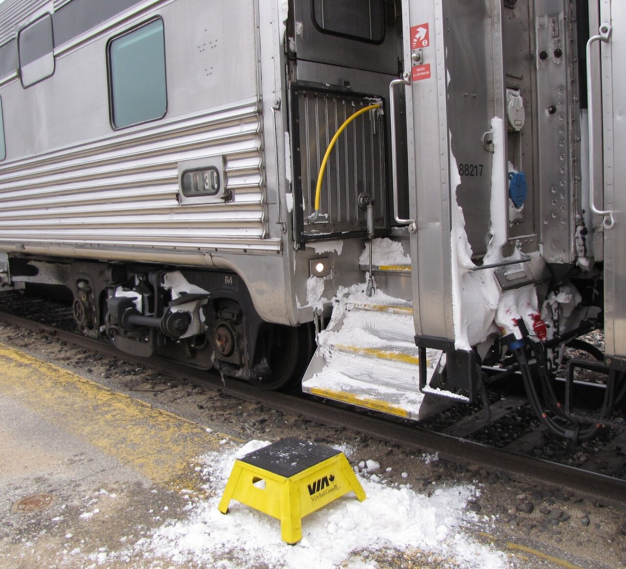

This is poor design and lawsuit inducing:
Looking at the above image, I suppose that all that GO's new higher platforms would accomplish for VIA is to eliminate the stepstool. That would streamline their operations a bit, but it would still be a far cry from actual level boarding with automatic gap fillers.
It's also neat to get an up-close view of the metal sheet which folds down to cover the stairs at those aforementioned 3 stations with level boarding (Ottawa, Montréal Centrale and Québec Du Palais).

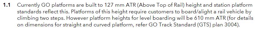

Just checking, everyone knows that a universal level boarding is an actual goal under the on-corr program right?
That is for every station to have level boarding with trains.
Just checking, you know that GO's level boarding standard is for 610 mm above top of rail, but VIA trains have a floor height of 1220mm above top of rail?
The only question is if this will apply to VIA's platforms at union/guildwood/oshawa and others as well
That's literally the entire point of this discussion...

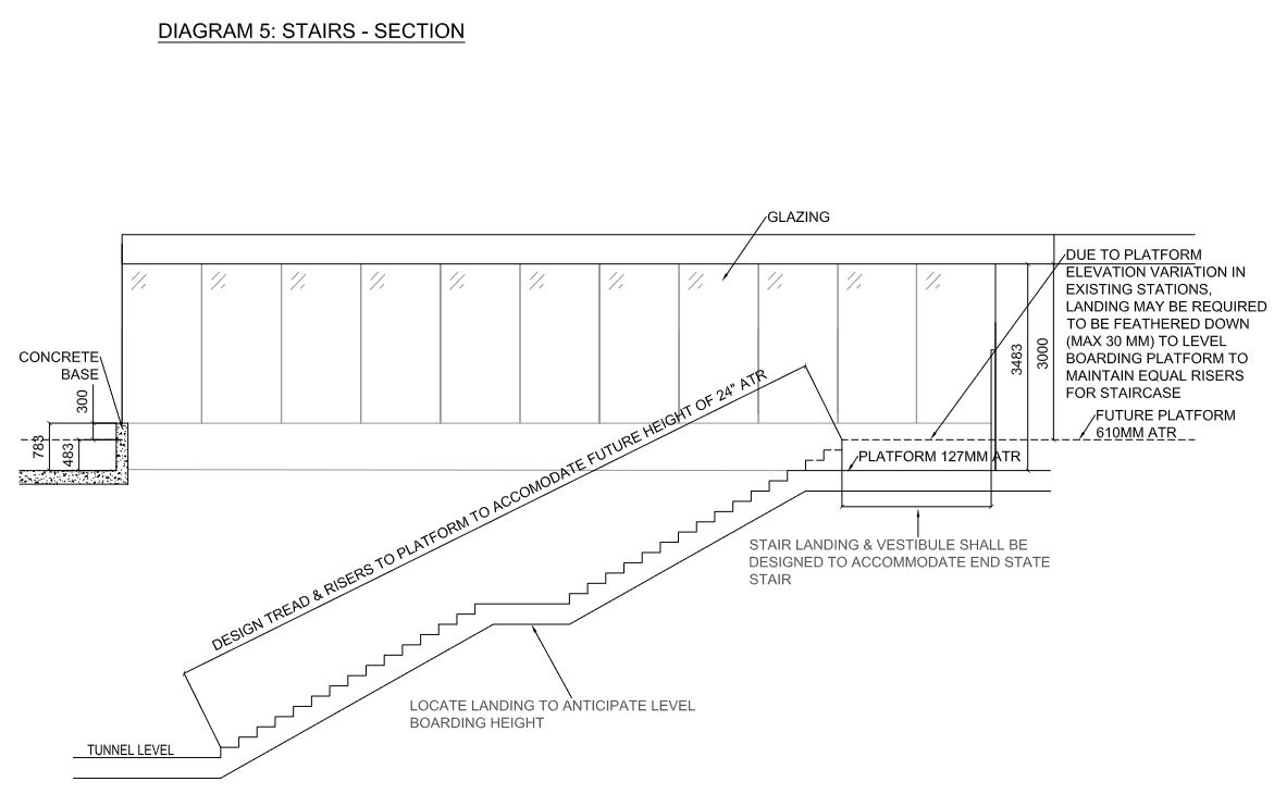

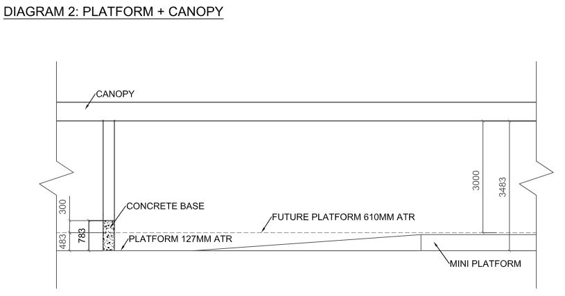

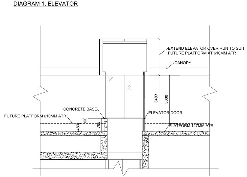

On Corr and Off Corr seem to be alive and well in public ML documentation, but you are correct that the station planning was pared back. If you recall the renders (they are way back in this thread, somewhere) for stations like Maple with a huge trainshed, that's probably a wise move. Certainly we won't see such grandiose Wynne/Del Duca branded stations under a development-driven station program, but station work that is mission critical is certainly continuing (Bramalea, Oriole, Agincourt, Milliken, Unionville, Weston, Mount Dennis, Woodbine, ......etc) and those stations are quite adequate in scale for their task.
One has to remember also that development funded stations get swept into the development application process for the overall development plan, and development applications are of necessity a multi year approval process. Look at Mimico as an example of that. So what may look like "cancel" is actually just "takes longer".
it would be interesting to know whether the spec's for development funded stations require roughing-in high level platforms.
As much as high level platforms are interesting, and may be essential some day, starting that program now would be a huge distraction and disruption to RER. It's enough just to get electrification started, tracks added, and 2WAD under way... without having that transition added to the scope. Let's talk about that in 2026 when RER construction is wrapping up.
