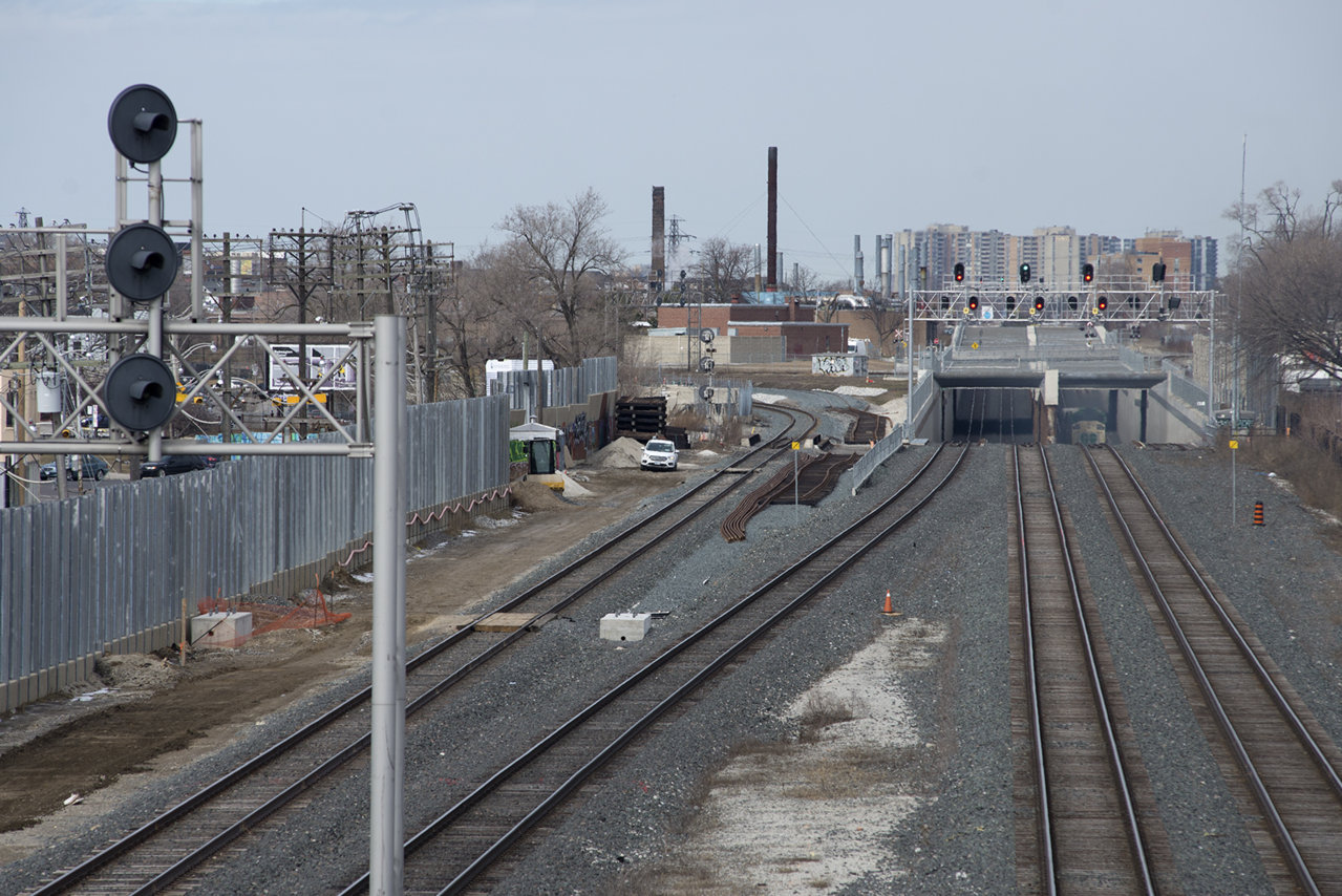

One small bit of work that is edging forward is the restoration of double track on the Milton line in the Dupont-Junction area. The second track has been relaid from the West Toronto interlocking (just a touch east of Keele St) eastwards around the bend to about Dupont St. There are two new concrete signal piers in place. When I visited on Monday, crews were working further south doing cleanup of earlier construction materials along the sound wall (ie behind the camera).
One would expect that the new track will eventually be mated with the existing track in place towards Union, and a new track will be built alongside it between the sound wall and the existing track, to mate up with the current track running around the bend to the west..
This is one of the projects that the Auditor General pointed to as having absolutely no detail justifying the invoices CP has submitted for the work. From what I can find online, CP has the contract for building as far as the former Dupont interlocking. The work from there to Strachan Ave was put out to RFQ in 2016 but there has been no announcement of it actually getting awarded.
Having a two-track connection at Dupont is helpful to CP to improve the flexibility in routing between Dixie and West Toronto, but the extension eastwards has no real value unless CP agrees to allow GO to run a bi-directional service, either as revenue service or just to turn back equipment moves at peak periods. The latter would really help equipment utilization. But who knows if that will actually happen.
Can someone explain why they're still using wooden ties over concrete ones? I get the outer borough lines, but for the Weston sub...come on CP.
