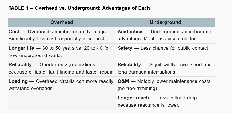

Honestly, 32000 customers for some of the worst flooding since Sandy is…pretty damn good, considering that all of NYC’s power lines are underground.
For contrast, I have a transformer substation just a block or two from me, and I hear an explosion there, sometimes associated with a power failure, sometimes just a flicker several times per year.
Ice build up is a huge issue in winter; lightning is an issue in the warmer months, but so are squirrels and raccoons and other creatures getting into and chewing on the equipment, typically to their detriment.
Its all trade-offs; but on the whole, undergrounding typically results in greater reliability/resiliency.
From the above:
Lots more detailed info at the linked page!
