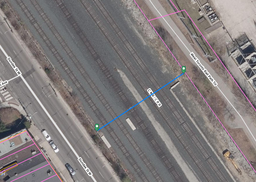

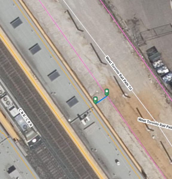

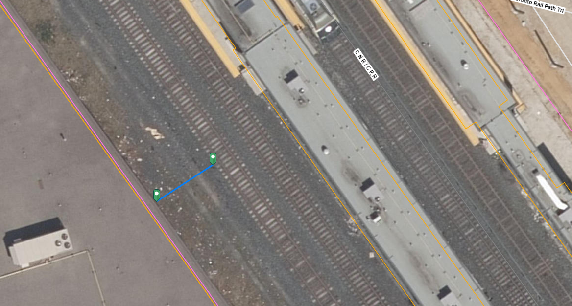

There appears to be surplus space in the current aerial photos on the west side of Bloor GO/Stn.
Pink is the property line, but I stopped drawing the distance marker where the visual indication of a building exists.
That distance is 7.5M from the edge of the existing track to the apparent building wall.
That should allow for one additional track and a somewhat shallow platform by my math.
Thoughts?

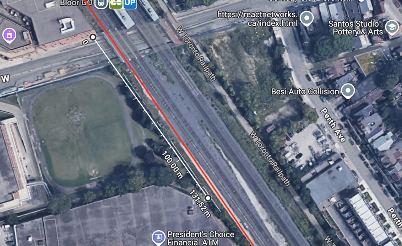

Second question, since I'm here picking your brain, which I apologize for doing a great deal today.......

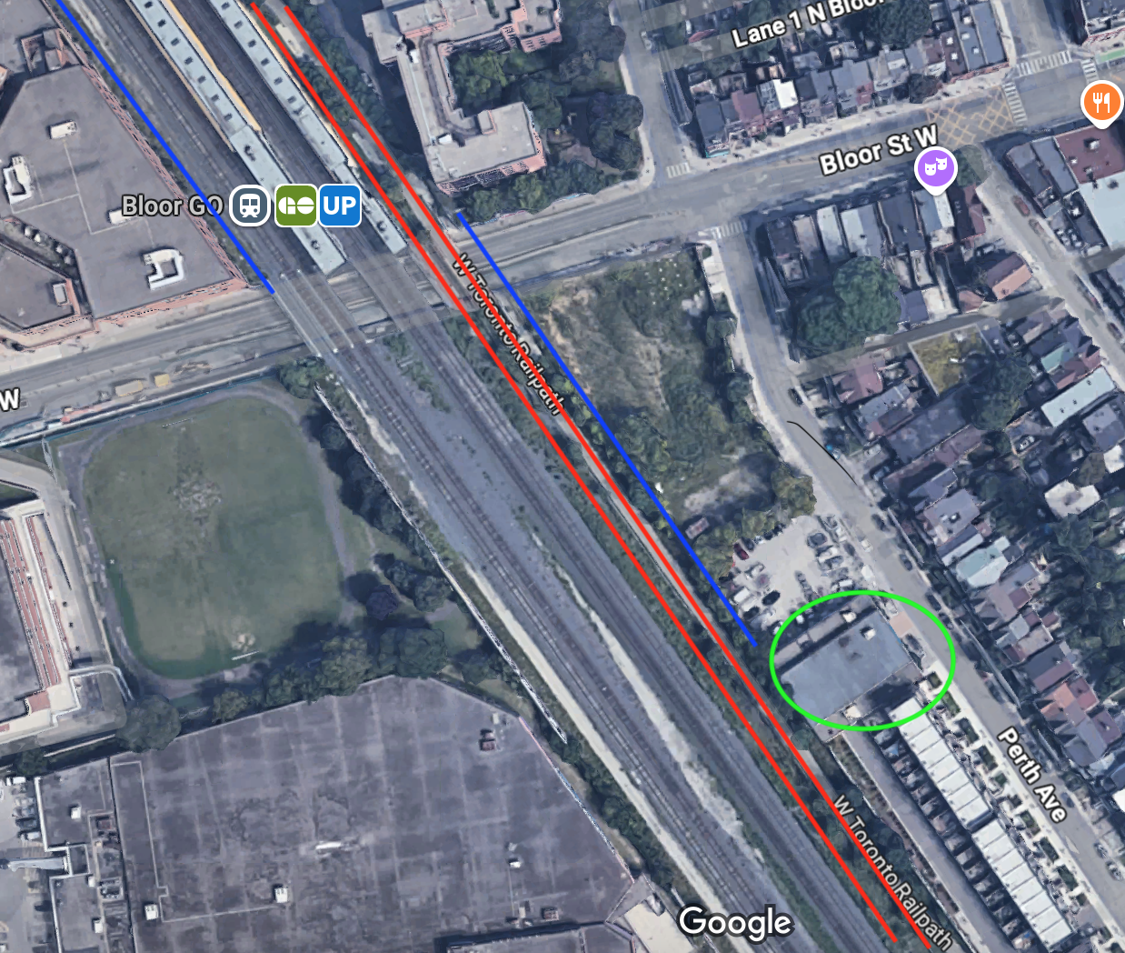

What's the full build-out plan for tracks north/west of Bloor Station? I see 5 laid today:
The measurement from noise barrier to noise barrier is ~38M which, my math suggests would support up to 9 tracks.......certainly 8, comfortably, leaving room for gantry posts.

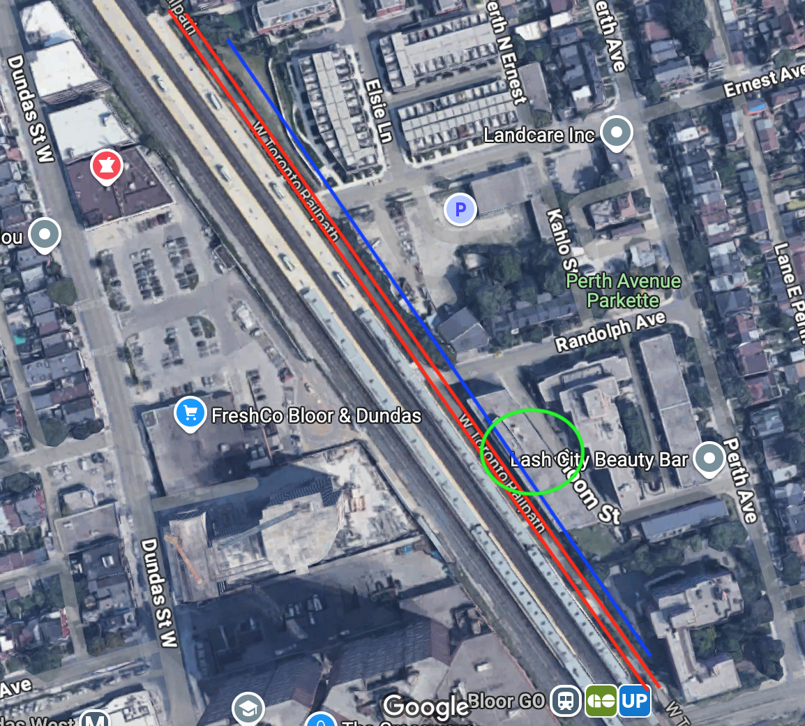

Finally, looking at the east side of the station (rail path), the City's ROW is ~9M or greater beside the station at all times, with a 2M buffer on the Mx side.
The minimum width of the path itself is for design purposes is 4M, assuming we allowed 5M for a space for lighting poles etc, and a 1M buffer beside the station, that provides 5 surplus M available with floating the path in the sky.
This section (below) is 12M, plus the buffer on the Mx side, but other parts are narrower:
If one had 5 surplus M, that would seem to be enough for an additional track w/o moving the platforms?
If this were the case, one needn't shift all the platforms over, one could shift some of the trains over, with Milton using the westernmost tracks, as it does today.
As noted, I'm not arguing for any of the above, of that its a good investment; merely that there seems to be space to do something there. But I appreciate there may be reasons that what 'seems' to be there is not actually available for said purpose.

Valid point, I just measured the property lines on the City's aerial photos. The 'buffer' was the space btw the Mx property line as shown and the City's property.
Its certainly possible that the photo is misleading, its definitely outdated, and maybe a track is going there. I'll wait to see what Dan has to say on all this.

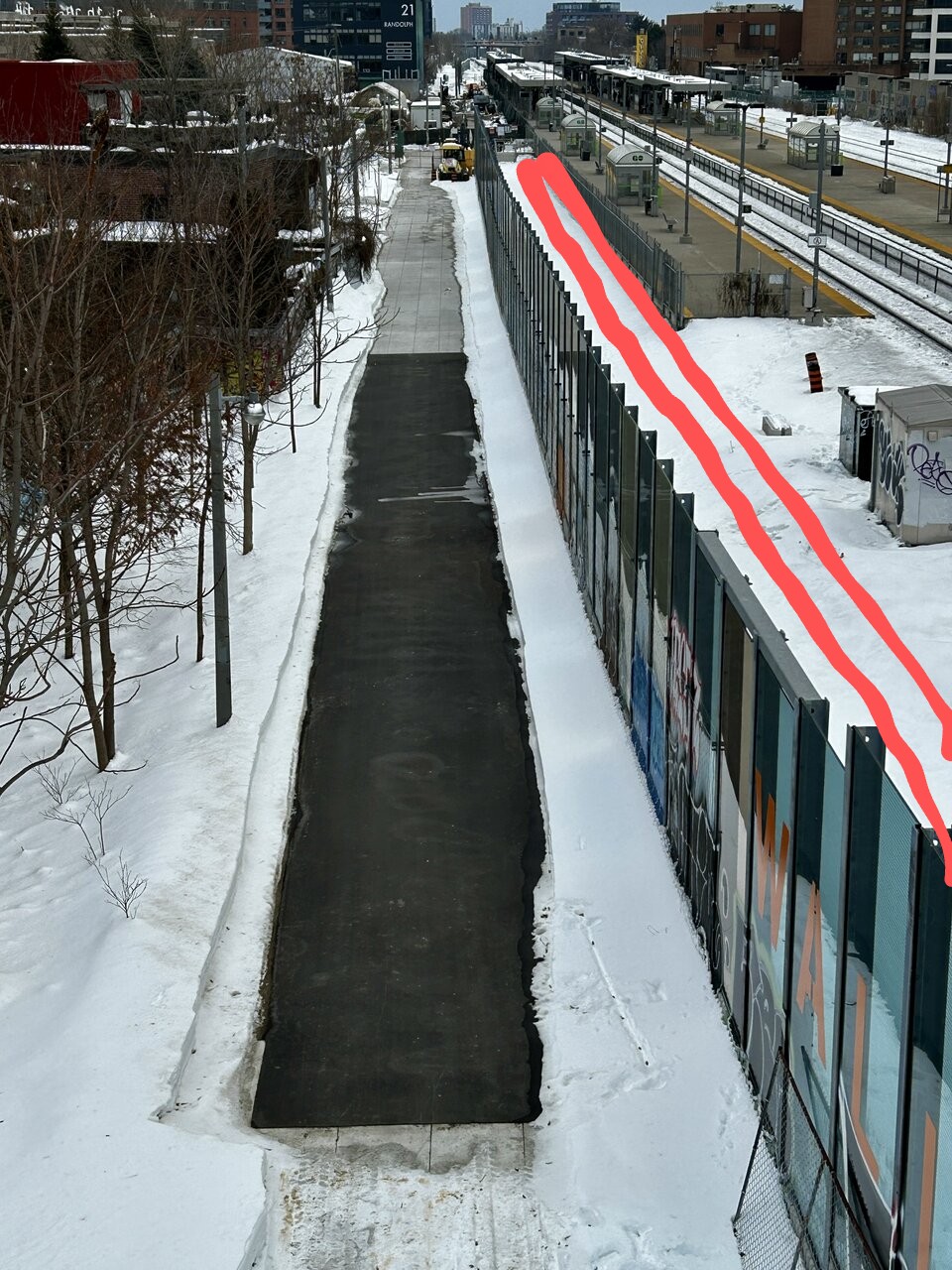

I am talking about the track on the east side, the new track that I think is currently going in here along the Railpath. I was clarifying with @Northern Light where he meant the 2 m buffer is that he mentioned next to the City's ROW (on which the Railpath is) in relation to this new track.

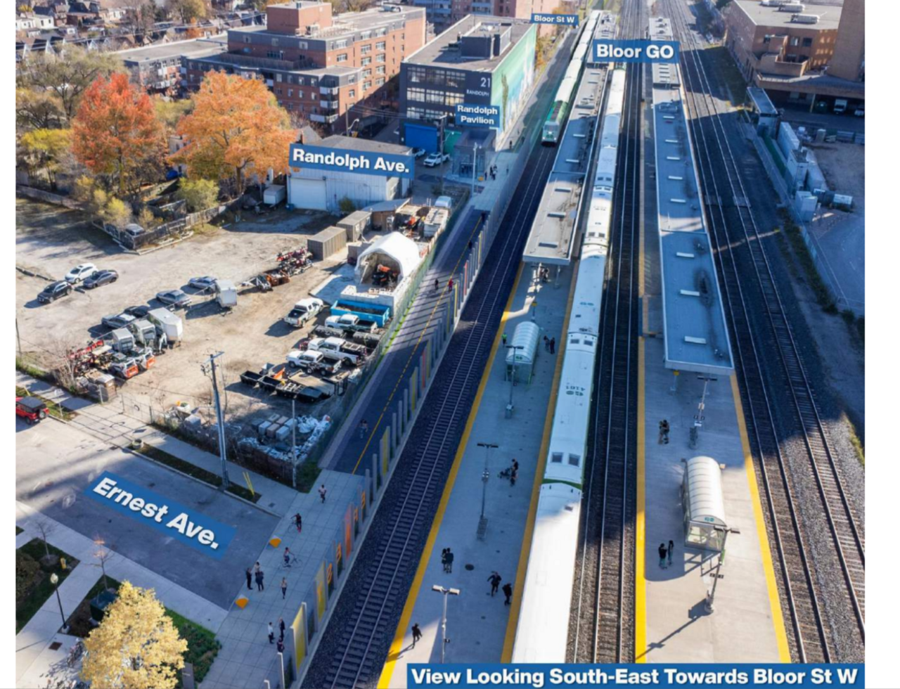

My understanding this is what's it's meant to look like when done:
There is no room for a 2m buffer zone between the track and the pathway. To do so would remove the pathway all together with parts of the pathway already been reduced for that track..
The rendering are correct as to what will exist late this year when the track is install along with the sound barrier missing sections.
There is no room for a 2m buffer on the west side without expropriating land to do so.

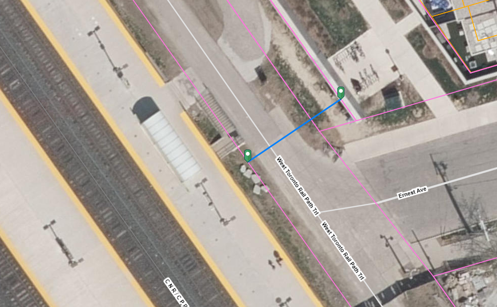

I think your rendering is clear enough that a track goes on the east side......... but I do want to show you what I was looking at, misleading as it is, obviously.
Pink Lines are property lines.
Its important to note here that at various points along the station, the measure from various property lines to other points such as the rail path or adjacent buildings varies. I can't illustrate them all, but I'll show a couple again, just so you can see what I was seeing:

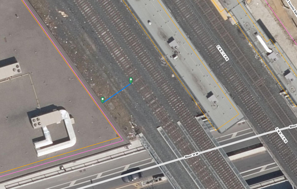

West side:
That blue line above is 7.8M in length
East Side: (What I was calling 'the buffer' that will clearly have a track):
That blue line is 2.5M

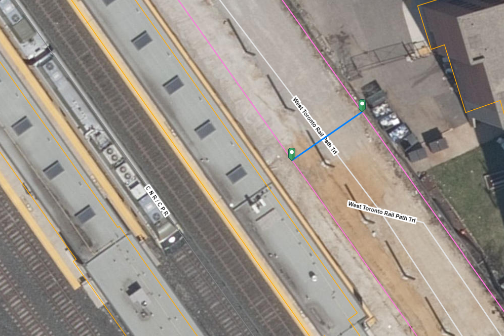

Further East:
That blue line suggests the City owns 9.1M btw those 2 points. A typical multi-use path requires 4M (add 1M for light posts and such)

Right, so there is 4.1 meters "excess" on the east side? Is that enough to add one more track and a side platform? I don't see the rationale of adding a platformless track here.
In the 7.8 m on the west side, I can't comment whether you can add a track and a platform, maybe? @drum118 doesn't think so. It would need to be an island platform so there are no platformless tracks. I think it would be too narrow.
I think without moving the current platforms and tracks it will not work to fit 6 tracks all with platform access unless the Railpath is really narrowed or as someone suggested runs elevated over the station.

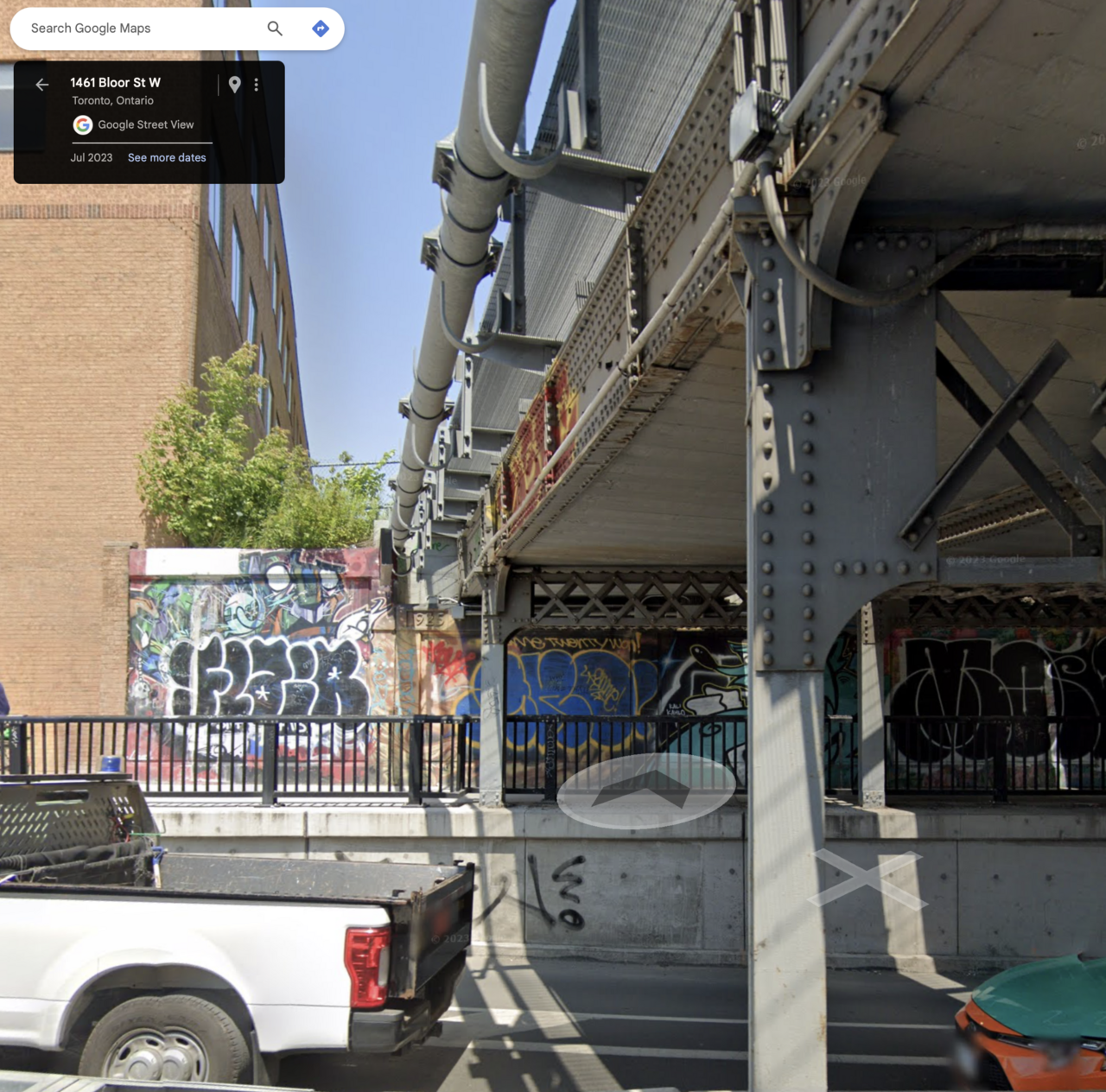

Here's a shot of the clearance at Bloor Street. If one were to move the west track of the Milton line to the very extreme - which would imply building abutments and moving the bridge over - this shot shows the amount of room that one has to play with. I can imagine an island platform of that width fitting.... but the structures to bring the staircases and elevator from the underground level to that platform - which would have to fit between the clearance plate for the two tracks with some spacing from the track - would be very, very narrow.
Personally, my eye says it's not wide enough.
