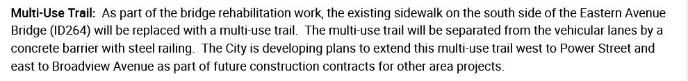

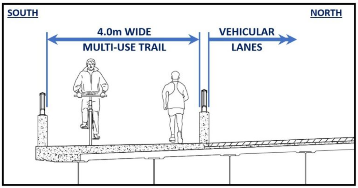

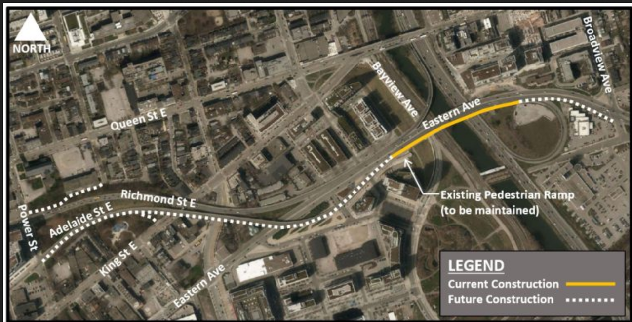

The sidewalk on the south side of the Eastern Avenue bridge HAS been widened from the DVP entrance to the ramp leading to Lower River Street and it is a mixed use pathway of decent width now. There are photos of it on the bridge thread SEE https://urbantoronto.ca/forum/threads/eastern-avenue-bridge-dvp-interchange.34569/page-3
However, this will probably not go west past the ramp (or only if they take a traffic lane). Hard to see how cyclists on Adelaide would safely use it.as they would need to cross Adelaide to get to it. I suspect the 'Future Construction" dotted line on the plan above will not be built for MANY years, if ever.

I know.
It will.
They won't
The Eastern Avenue bridge sidewalk/MUP will follow Adelaide on the south side, not Eastern, the Adelaide connection passes over Eastern Avenue's on-ramp.
It will be built when the ramp is reconstructed. The existing paved deck is ~9.3M wide. One 3.3M car lane with one 3M car lane, leaves 3.0M for an MUP with no other changes. I don't know, but I imagine you may see a very small widening of the deck to allow room for the concrete barrier between traffic and pedestrians. There is room, for a 1M widening w/o issue, provided the existing abutments can support it.

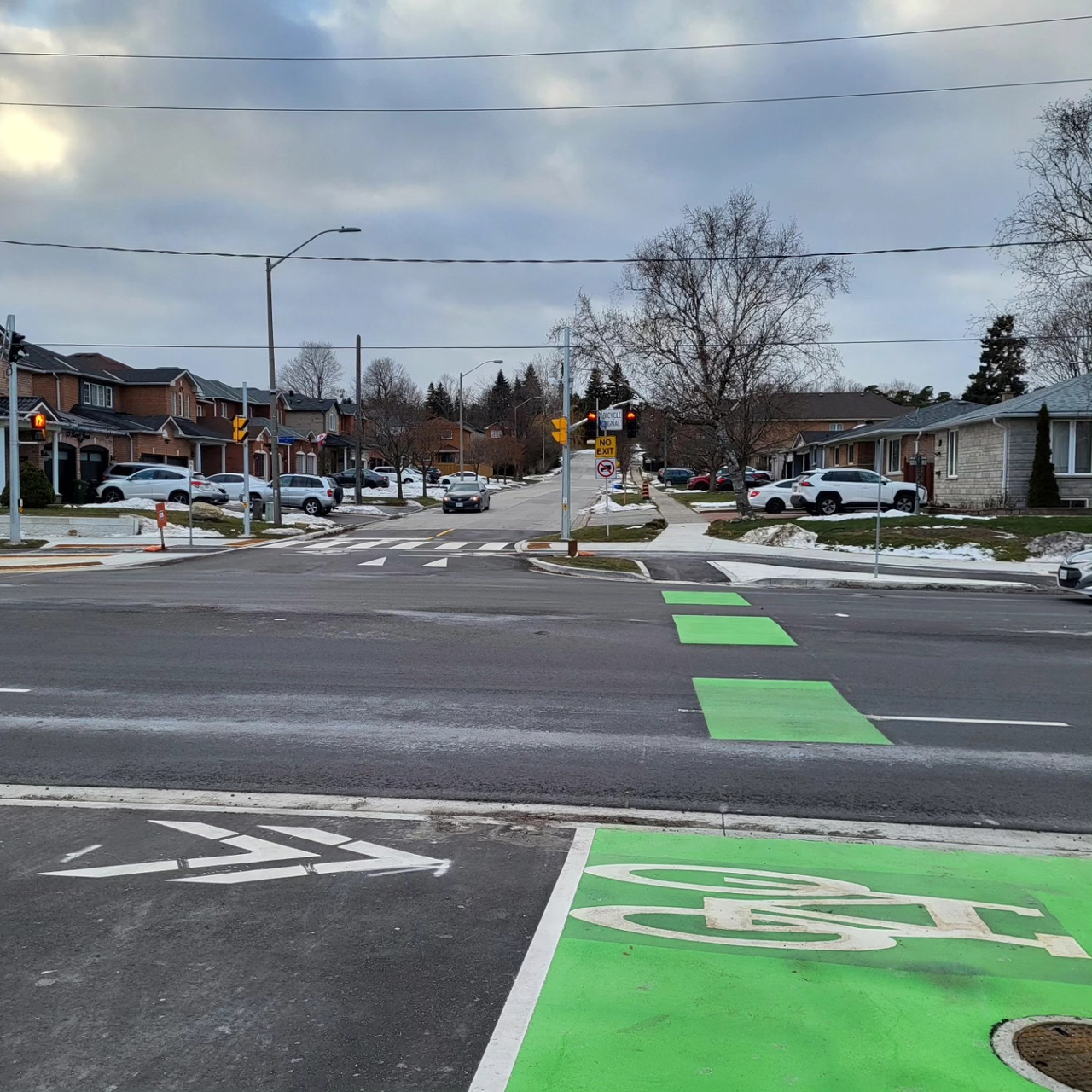

Looks like Port Union is done per a few photos shared by Sean Cooper in the Cycling in Toronto Facebook group.
This one was done with relatively little
This project notably added a car lane as well as separated cycle tracks. Imagine that in 2025 in the City of Toronto!
