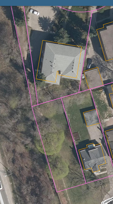

A few notable pinch points:
No trail here, road is very narrow as is, no existing sidewalk, one of the 2 houses must go.

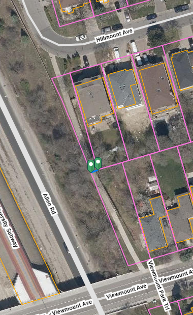

Below, I show a pinch point that is 3.2M wide. The adjacent home would have to go.

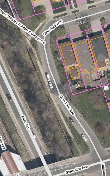

Just north of that the available space from the curb to the fence above the Allen embankment is under 3.0M.
The road cannot be narrowed sufficiently, one home would have to go to allow re-alignment of the road and sufficient minimum width.

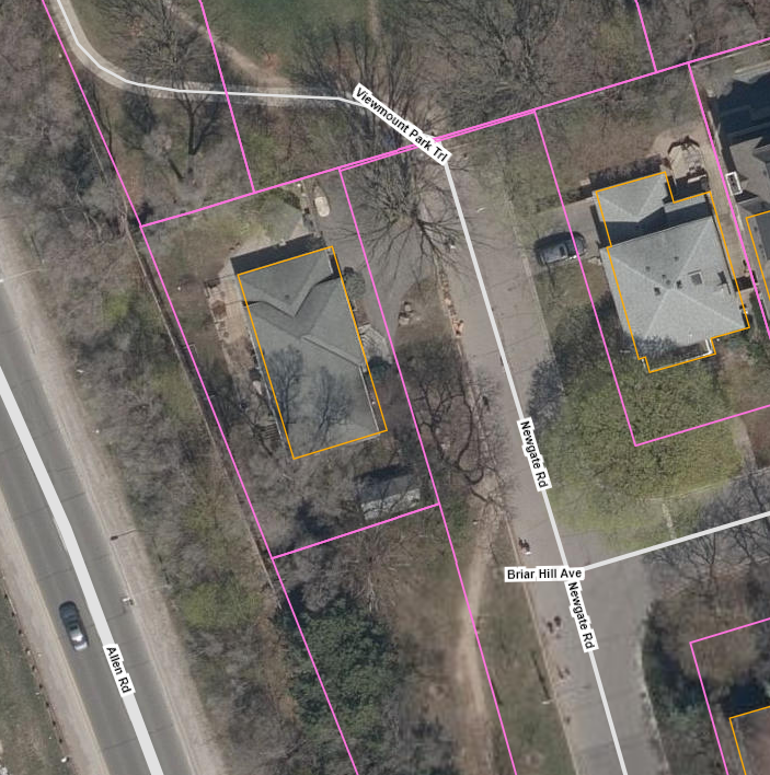

Next, no trail here, or room, 2 lots required:
I'll leave it at that for now. Needless to say, a very expensive options.

I looked at those pinch points too. The first one, I thought the trail could just go on the street past that one house, because it's only one driveway. I did wonder if the others were a bit tight, but I thought maybe the noise wall could be moved a metre over in those short sections. I didn't worry about the trees, but I guess I should have. Also, I thought maybe that last empty lot was city parkland since there isn't a house on it. I know that you know way more about this than me though, so I trust your judgement. Thanks for looking it over.
