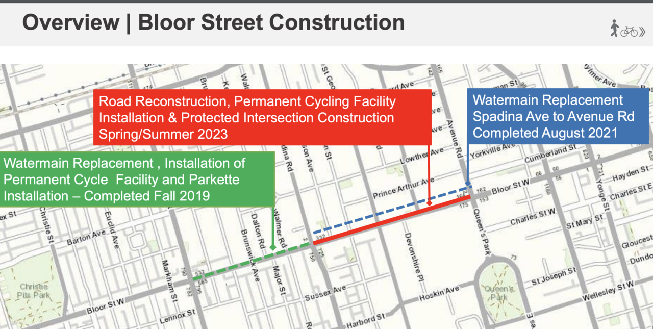

EDIT: Actually, looks like the project at Bloor/St George has a westbound to northbound right turn lane for exactly this:

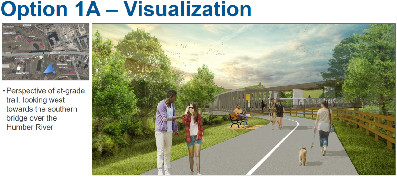

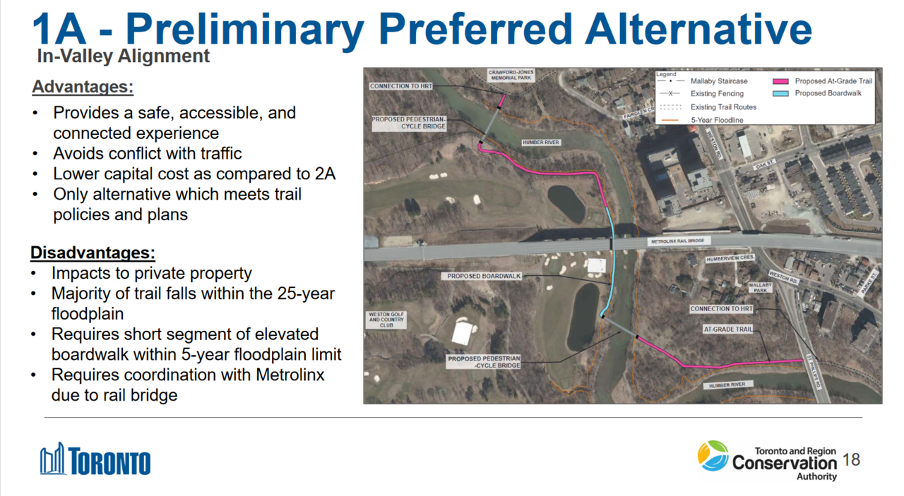

The next meeting for the Humber Gap Trail project is coming up on May 17.
Good news, the preferred alignment is the one we all hoped for, entirely in-valley.
Main page for this (scroll down for presentation links from which the above images are taken) is here: https://www.toronto.ca/community-pe...tructure-projects/mid-humber-gap-trail-study/
Once you've read the presentations, there is a survey open til the end of the month, here: https://s.cotsurvey.chkmkt.com/?e=269952&d=e&h=AA486DD2049BC24&l=en
Its unfortunate they just couldnt keep it on the east bank for simplicity sake, but it will be nice.

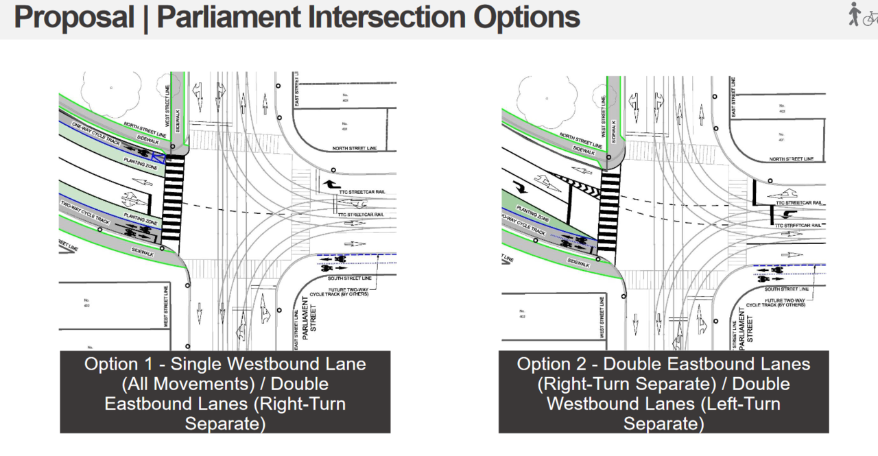

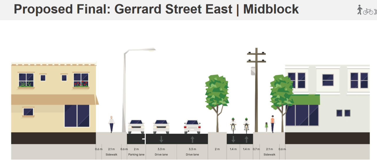

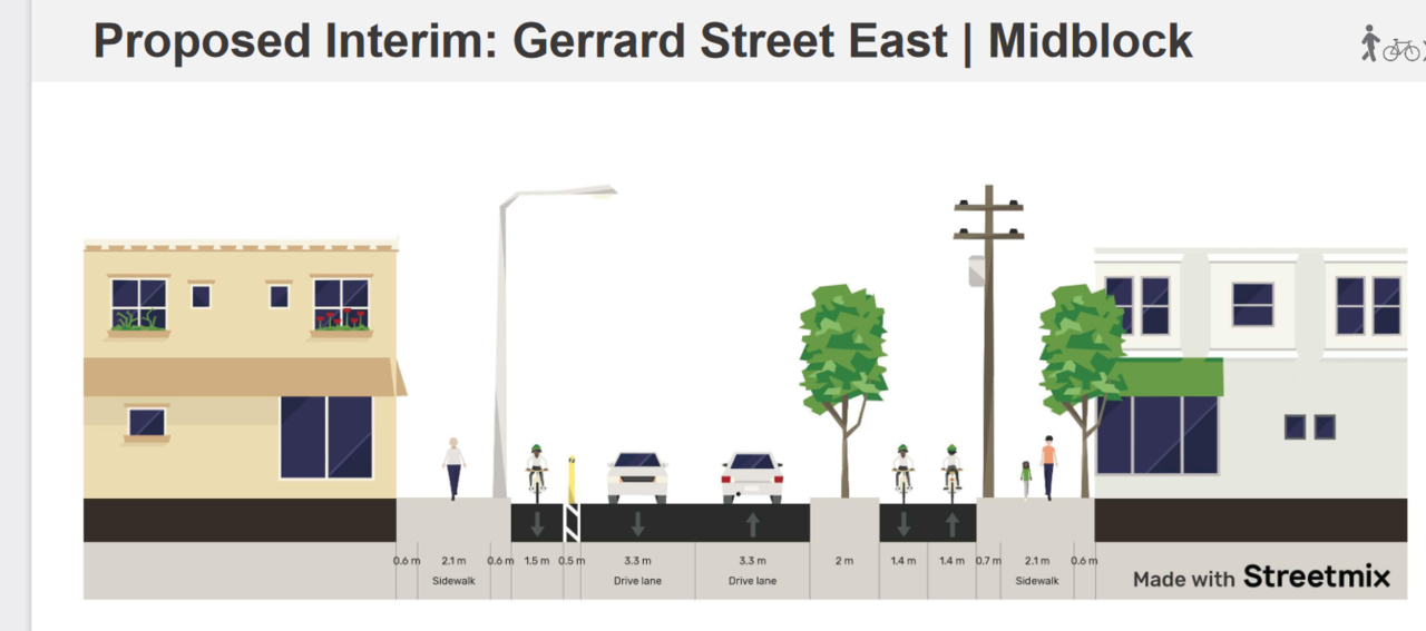

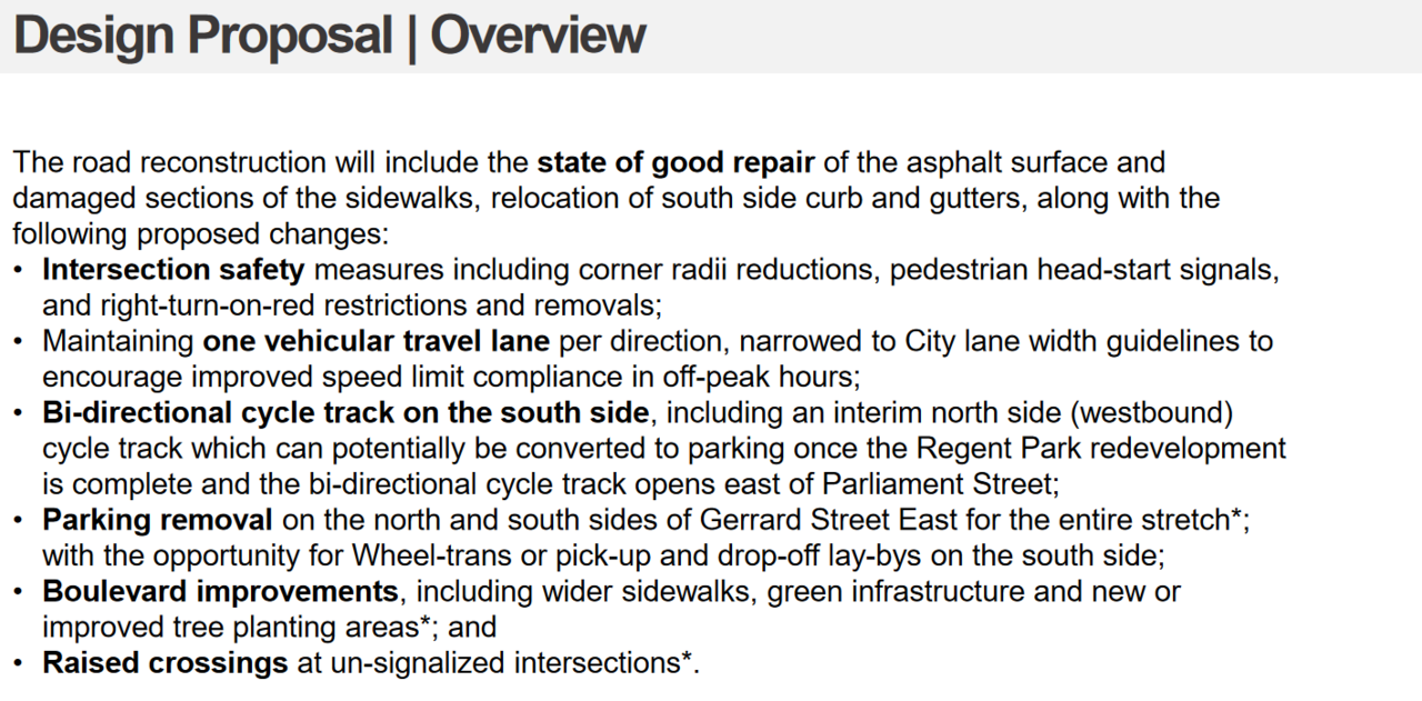

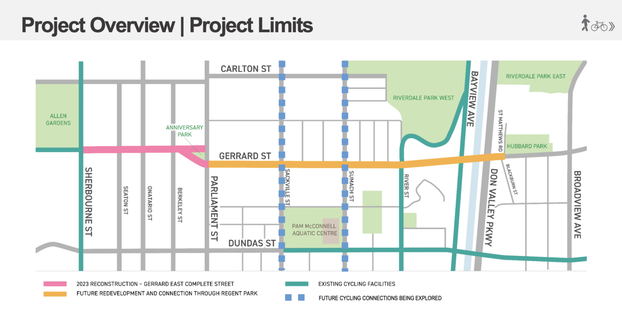

The details from the Gerrard Presentation:
This next bit is for Parliament eastwards to other side of the Don River; but its not immediate, it would be done as Regent Park is redeveloped over the next few years.
Survey is here: https://s.cotsurvey.chkmkt.com/?e=271256&d=e&h=3BDDBC72BEAFB96&l=en

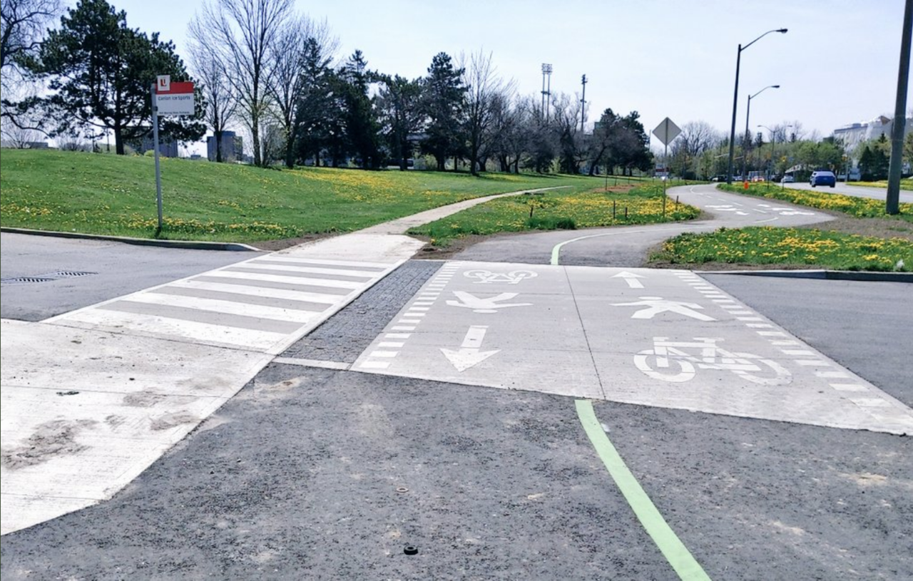

New Multi-use Trail along Murray Ross Pkwy in the York U area is just about done.........just a few markings and plantings left:
Source for the above is Kanchan, who is a member of the City's Cycling Unit: https://twitter.com/inHrEye
Needs to be rule passed by council in Toronto that anywhere in the city limits if there are grassy curbs of significant size on the side of the road, these have to be built anytime the road is resurfaced/repaired etc.

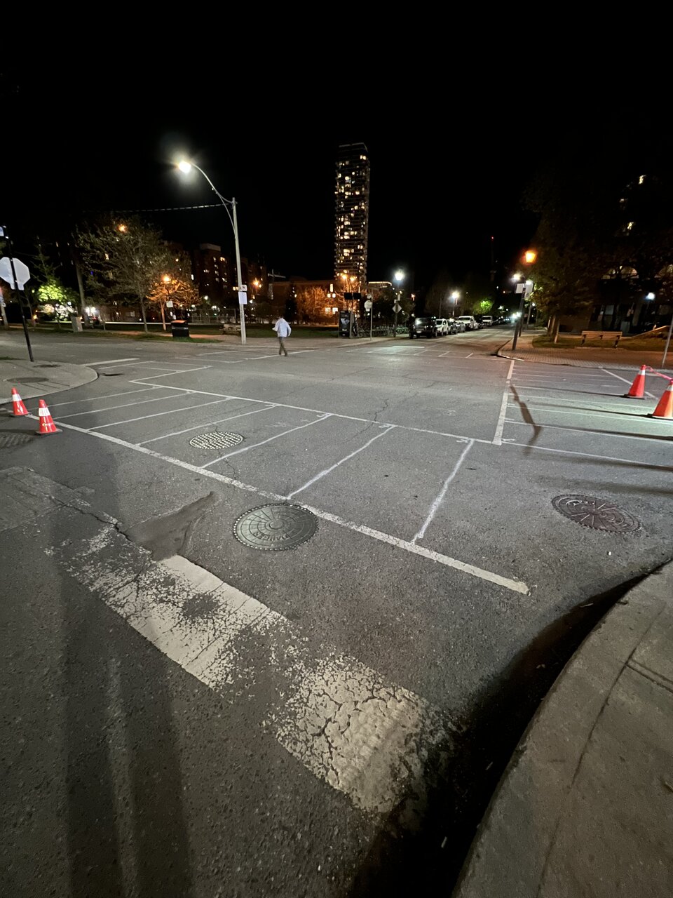

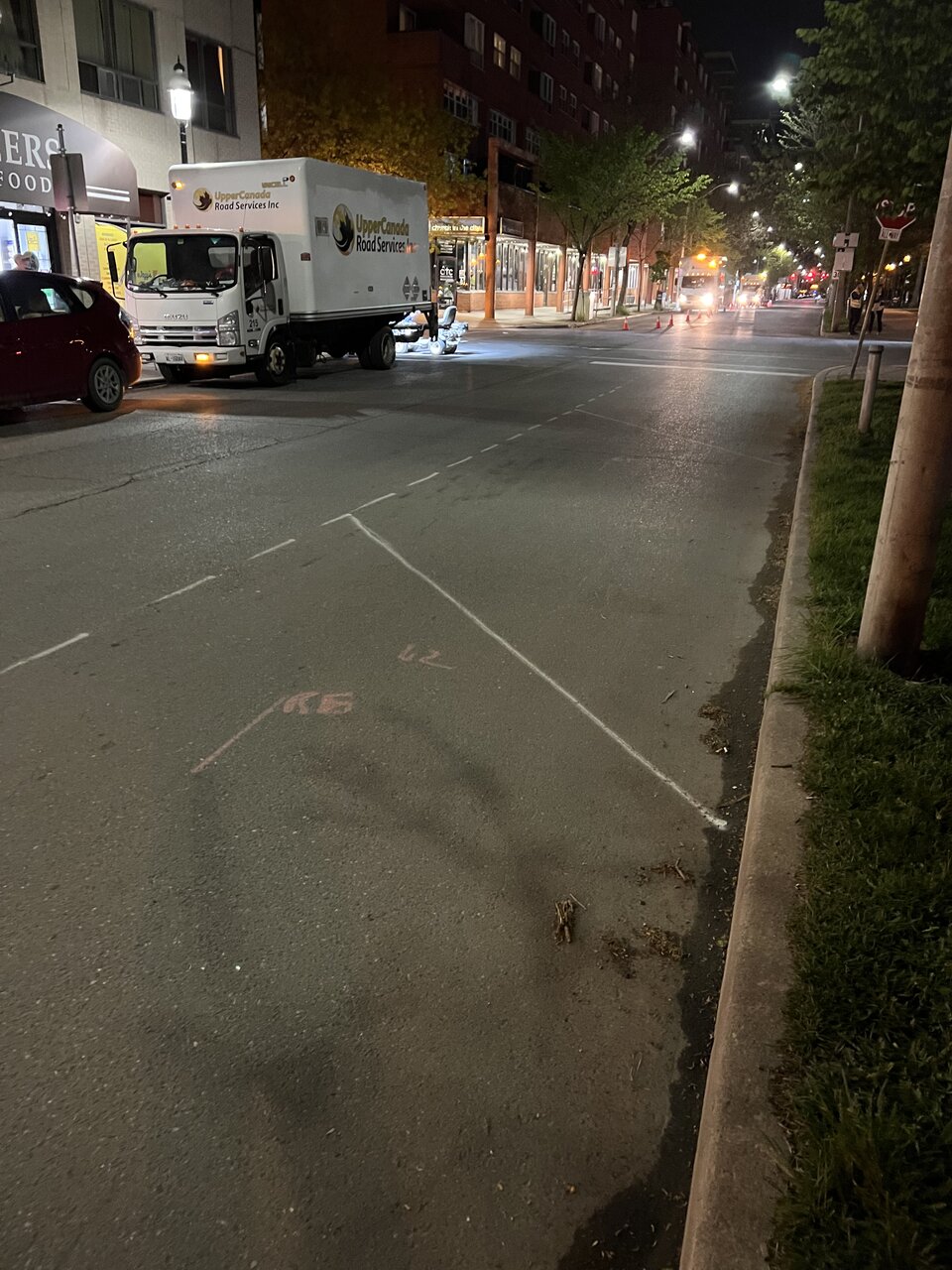

So phase 2 of the Esplanade is happening now? good to see. I thought it was contingent on the St Lawrence Market North being completed.
Phase 2 (what is going on now) brings the track west to George. It will proceed to Lower Jarvis and Yonge in 2023. The short link at Parliament Square Park to separate pedestrians from cyclists will be happening 'in the fairly near future" once the Province signs off on the land that is being transferred to the City (or not compulsorily purchased by the Province!)
