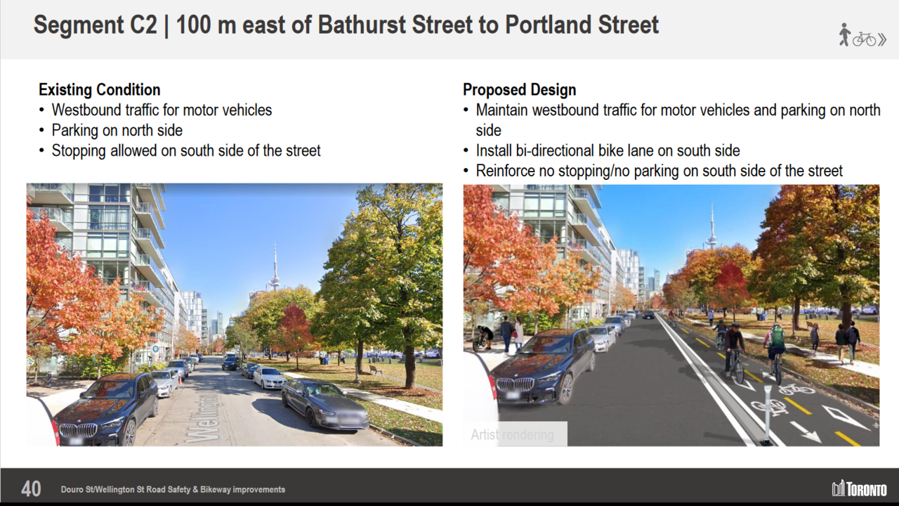

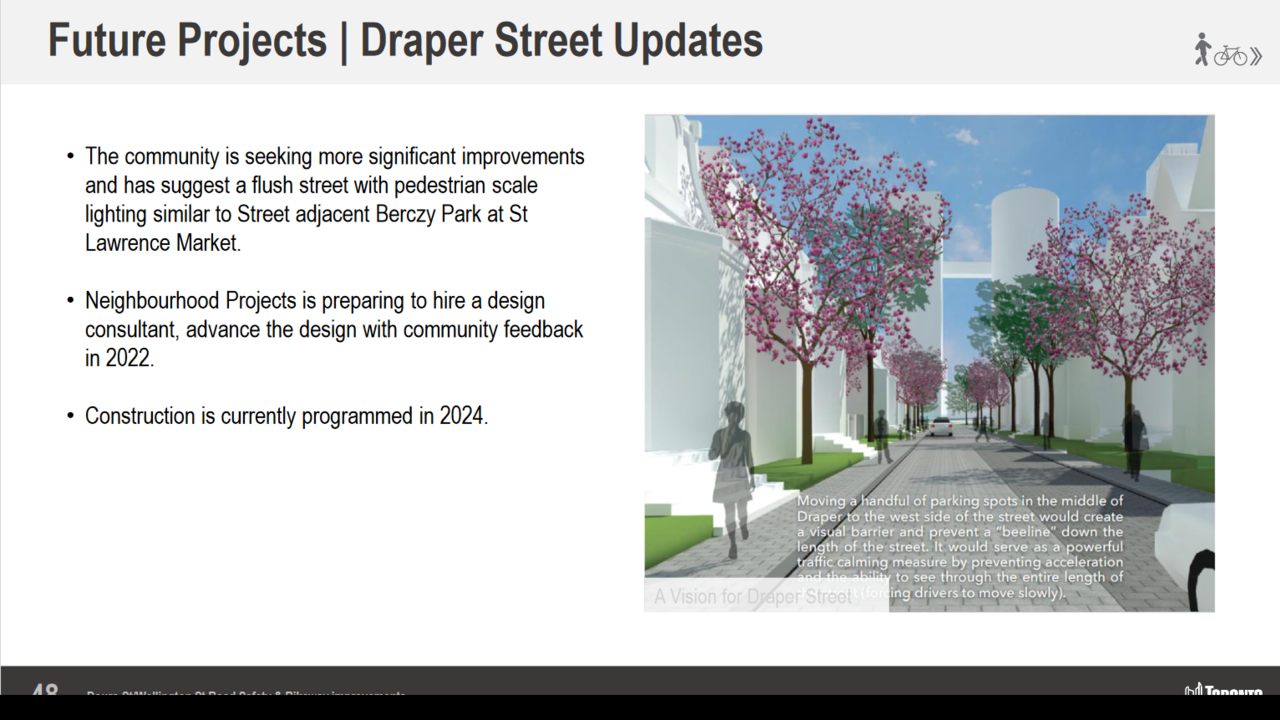

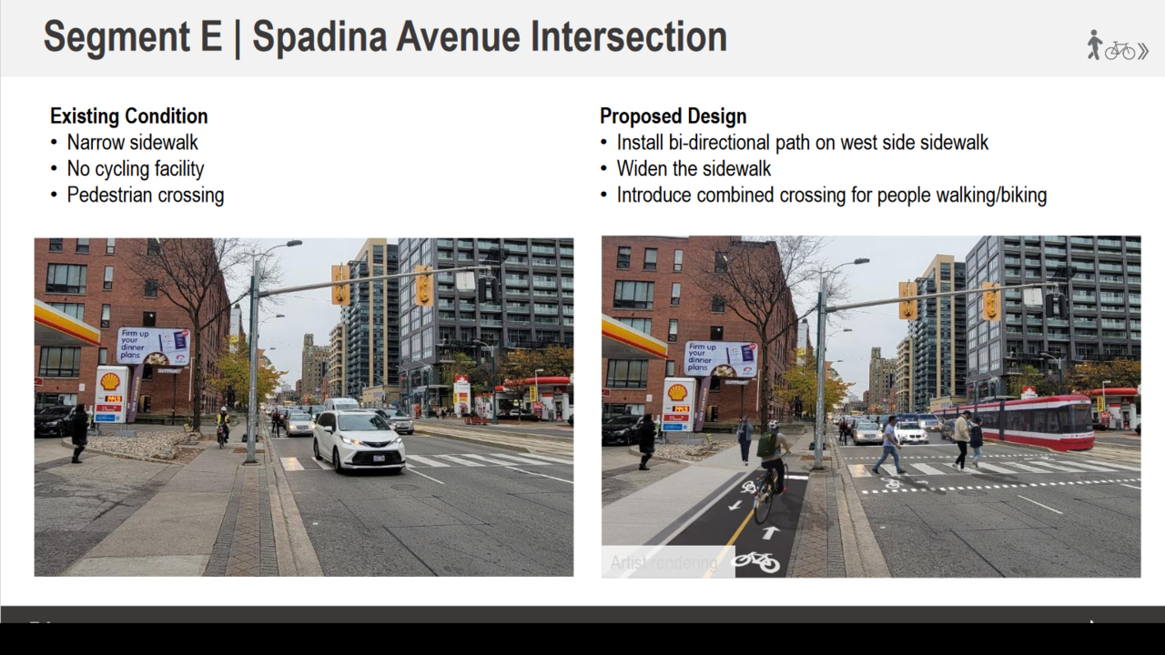

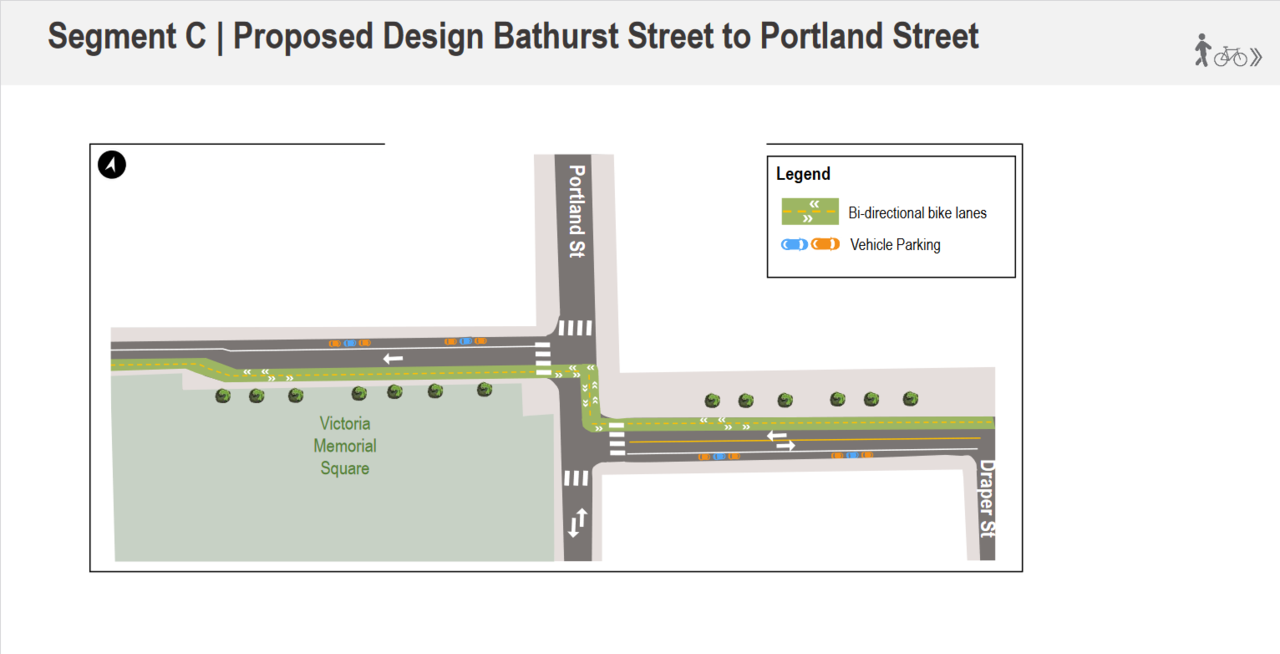

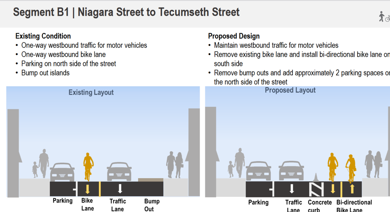

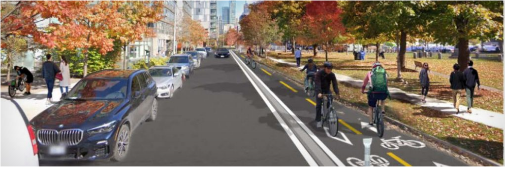

Changes/enhancements proposed for cycling along Wellington, from Blue Jays Way to Strachan:
Presentation: https://www.toronto.ca/wp-content/u...lingtonStakeholderMeetingFinalAccessibile.pdf
Highlights from the above:
View attachment 368665View attachment 368666
Leave comments via Social Pinpoint: https://toronto.mysocialpinpoint.ca/wellington-map#/
Very happy to see this happening! This is an important connection to the railpath extension. However, it also needs to be extended east to Simcoe and beyond to the financial district.
I was just thinking that it needs to be extended to Yonge where it could jog down to some extended Esplanade lanes
Without looking into it closely, I'd expect an extension to Simcoe to be very do-able.
Wellington there isn't that high volume for cars at most times, and there are no streetcar tracks.
The latter would be a complicating issue for any extension to or beyond York Street.
I do believe the eventual plan is to connect Esplanade/Mill bike path with this one. Cannot wait, I always find myself trying to navigate across downtown through this area and it's no fun. I'd like to see them find a way to add the EV spaces somewhere else though. Hopefully this might alleviate some pressure on the MGT as well for bike commuters coming in from the west.

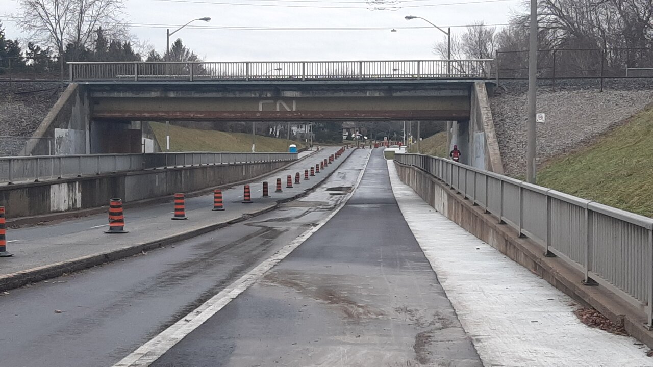

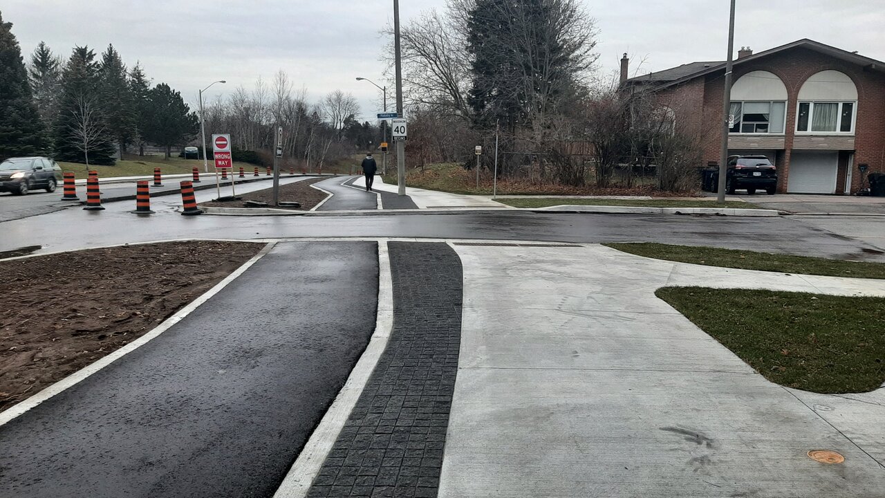

Cummer cycle track today. The narrow car lane was refreshing, but I wish the cycle path was paved with something other than asphalt:
View attachment 369457View attachment 369458View attachment 369459View attachment 369460View attachment 369461View attachment 369462
The cycling lane should be level with the sidewalk, not the roadway. Less need to speed as much as possible going downhill so they could make it up the uphill before gravity and friction slows the cyclist down.
