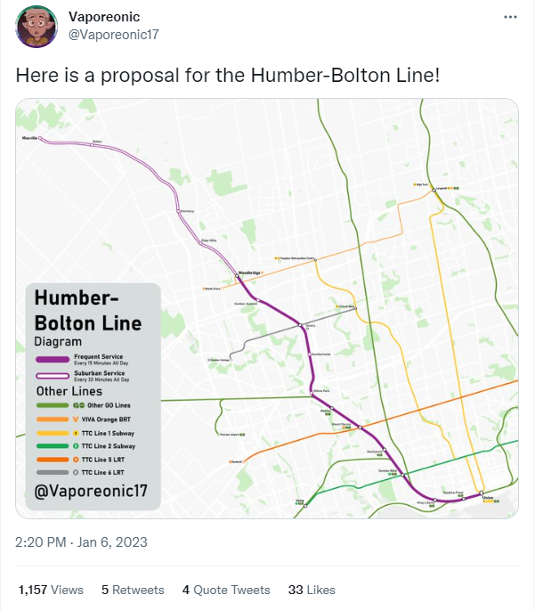

I wonder what the good people of Weston would say about the proposal to run a GO train - diesel most likely - running by every 7.5 minutes on the surface beside the tunnel that was built to avoid having a GO train or UP Express train (It was Blue 24 back then) running by on the surface every 7.5 minutes.
I suppose it's possible to create a branch off the Kitchener Line at the north end of the Weston Flyunder so that Bolton GO trains would not have to run on the surface through Weston. The cost would be substantial.
That new connection might necessitate a grade separation at Oak Street, I'm not sure how the elevation works through there. The Kitchener line is already climbing westwards so the gradient required would not be as many feet of height as the full tunnel. But it would really mess up traffic patterns on the Kitchener line. if trains had to cross over there
North of Steeles on the Bolton line there is a 2.2km stretch in which there are five single-track bridges. Doubling that segment would be very pricey.
All of those costs, plus the absurdity of running 15-minute headways on the surface next to a 4-track tunnel that was built to avoid that disruption, plus the lack of density (so far) towards Bolton, makes me think that a 15-minute RER service is fanciful. More likely just Richmond Hill-quality commuter service to start, and perhaps hourly 2WAD eventually. Even that may be fanciful - ML likely is reevaluating its ridership modelling in light of continued WFH changes. I'm not sure that even peak loads are all that compelling post-covid. The cost per rider will be quite high.
But hey, there's plenty of Greenbelt and farmland up that way, so development will happen - so long as Doug is with us, anyways.

The Pelmo Park station is at Wilson, and Humbermede at Sheppard - given the local density I don’t know if even one station works there, let alone two?
Unless I see CP giving the OK to this it ain’t happening.
I wonder what the good people of Weston would say about the proposal to run a GO train - diesel most likely - running by every 7.5 minutes on the surface beside the tunnel that was built ...
I'd think GO would stay on their own tracks until north of Weston, and then build a connection there. I'm not sure there is even a connection south of Weston any more (unless they wanted to reverse twice).
Not on the existing CP track - (though there's a couple of sections that have double track - or a siding). It looks as though that the right-of-way is the standard 66 feet (one chain). That would allow for 4 tracks (well, 5, but I assume you'd need the occasional siding or ladder tracks). If a solution ($) could be done to give GO 2 tracks and CP 2 tracks, I don't see that CP would be an issue.
(heck, Bolton service would be infrequent enough, that they could run a single GO track for many years, with some passing points at stations. Stouffville passenger service has been running on a single shared track with freight for over 150 years now.)
